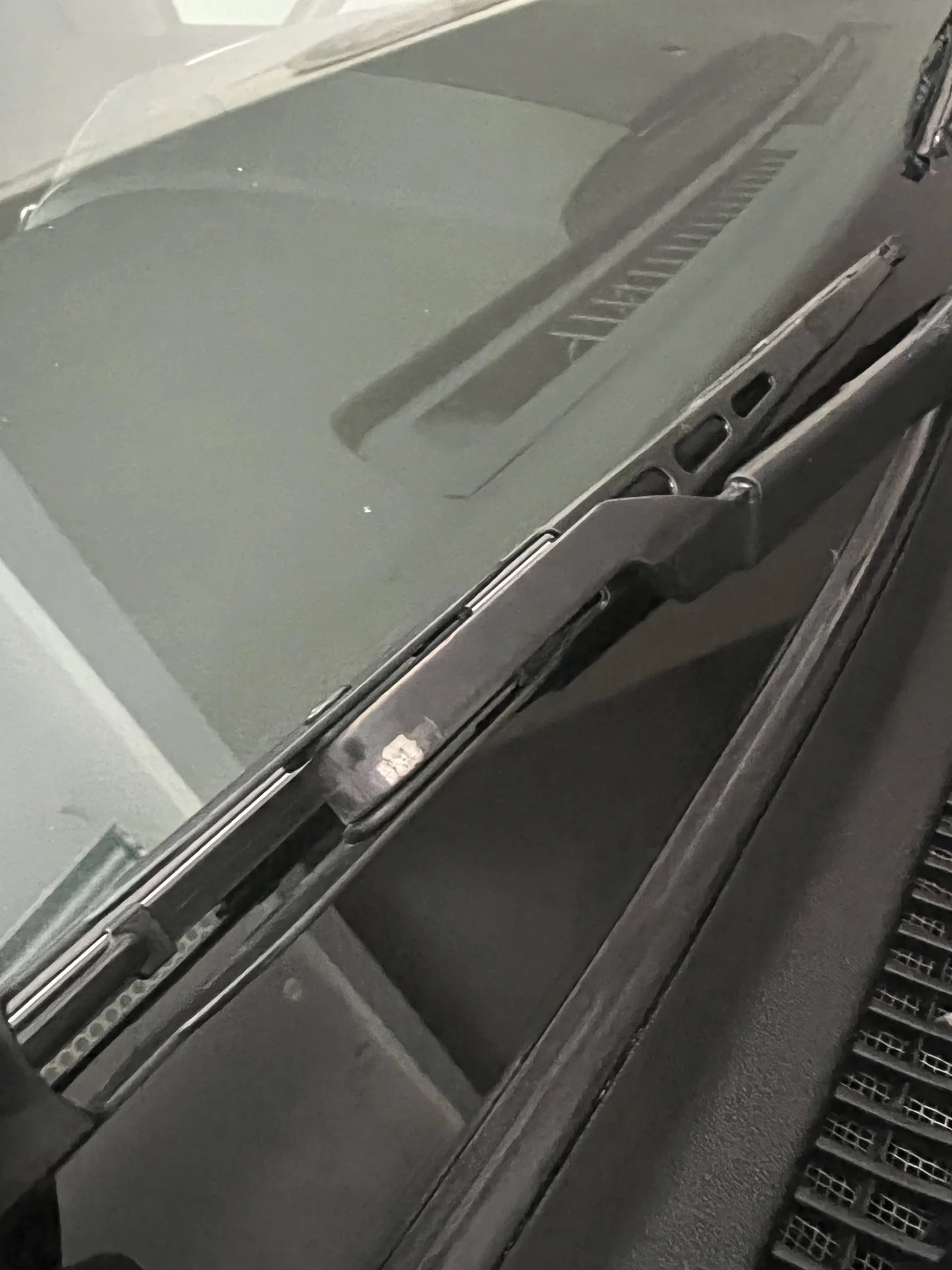

Should I touch up this wiper blade or paint the whole thing? I’d hate for it to rust.

Clean it well (including using a fiberglass pick to remove any of the paint around the edge that isn't bonded well) and touch it up, that'll handle any potential corrosion easily. No need to do the entire thing for such a small spot.

Personally, I'd take it off and paint the whole thing. SEM Black Trim Paint is a very good color, and holds up well.

Personally I’d still do the touch up. Toyota uses very high quality trim paint applied in perfect conditions and has the ability to do it before the upper and lower arm even get riveted together. You’ll have trouble truly matching their advantage doing this stuff when new, and I can’t see SEM paint being so much better (if it even is at all.. factory may be powder coat) that it justifies the work of a full removal, prep, paint, install. All for one tiny spot.
