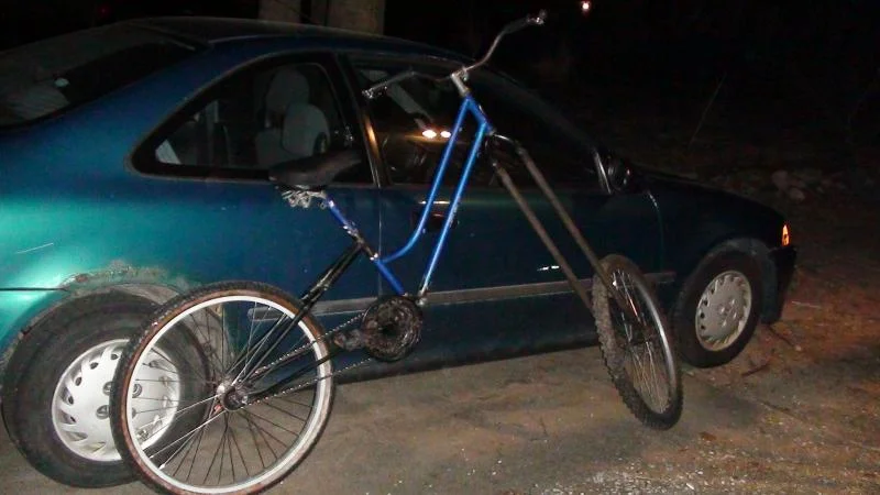

Its a bicycle chopper. Hypoid let me learn to TIG on his machine and he was like hey come ride with me and my chopper buddies, so I said sure but that means I get to use the hell outa your welder!!! He was like uhhhhh and I was like Too Late!

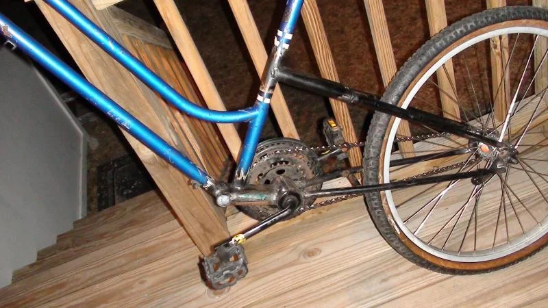

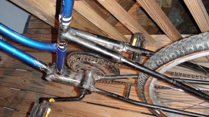

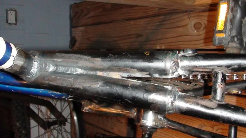

The frame is composed of parts from 4 different bike frames. The blue section in front is some random jap girl frame. The upper rear triangle is a setion of frame tubing milled and welded together and a section of a mountain bike lower triangle. The lower rear triangle is a section of an upper rear triangle from yet another mountain bike.
The bottom bracket (crank case) was removed from the jap bike and another bottom bracket was welded to a section of yet another mountain bike frame to locate it about 5 inches to the rear of where it usually should sit.

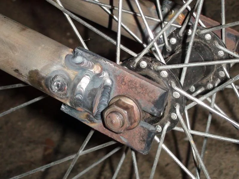

To make the dropouts i took two pieces of solid round stock that fit inside the fork tubes and threw them on the milling machine and milled a 1/4 inch slot through the middle of them. Then I took two pieces of 1/4 sheet metal and made a slot on one side for the axle and milled out a large rectangle area in the back large enough to fit around the outer fork tubes. This all fit together like a really nice puzzle and by word of others was super overkill and ridiculously complicated. (but it makes me feel warm and fuzzy inside)
The photos don't do it justice. when you ride the thing the way it is with the seat stuck in its way too low position your head is somewhere around 6 1/2 feet in the air. Theirs still a little bit to do to it to strengthen it up so I can go crash it but its rideable at this point.
