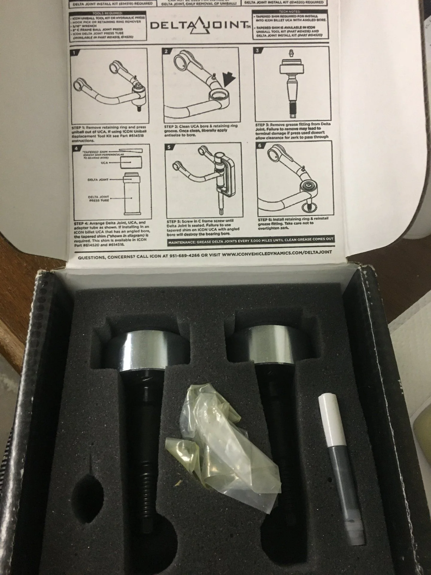

I also got a set of the Icon Delta Joint replacements for the UNI-Ball going to install with the Delta Joint conversion in the TC arms .

Any pics with your new ICON delta joint in the TC UCA? How are you liking it?
Interested in this as well
unfortunately parts have been coming so slow were into the warmer weather and still waiting on a rear bumper . I’m going to hold on my build till after the summer , I usually don’t drive the LC in the winter with all the salt , missed my envelope not having all my build parts .
