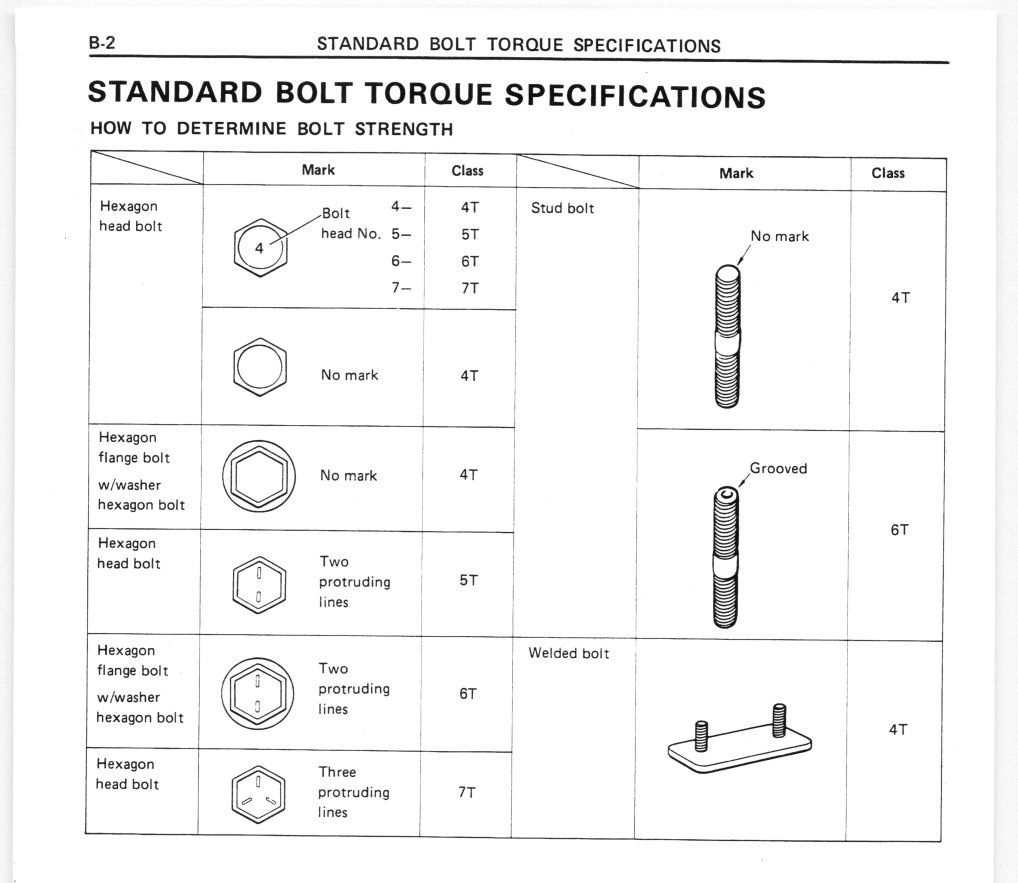

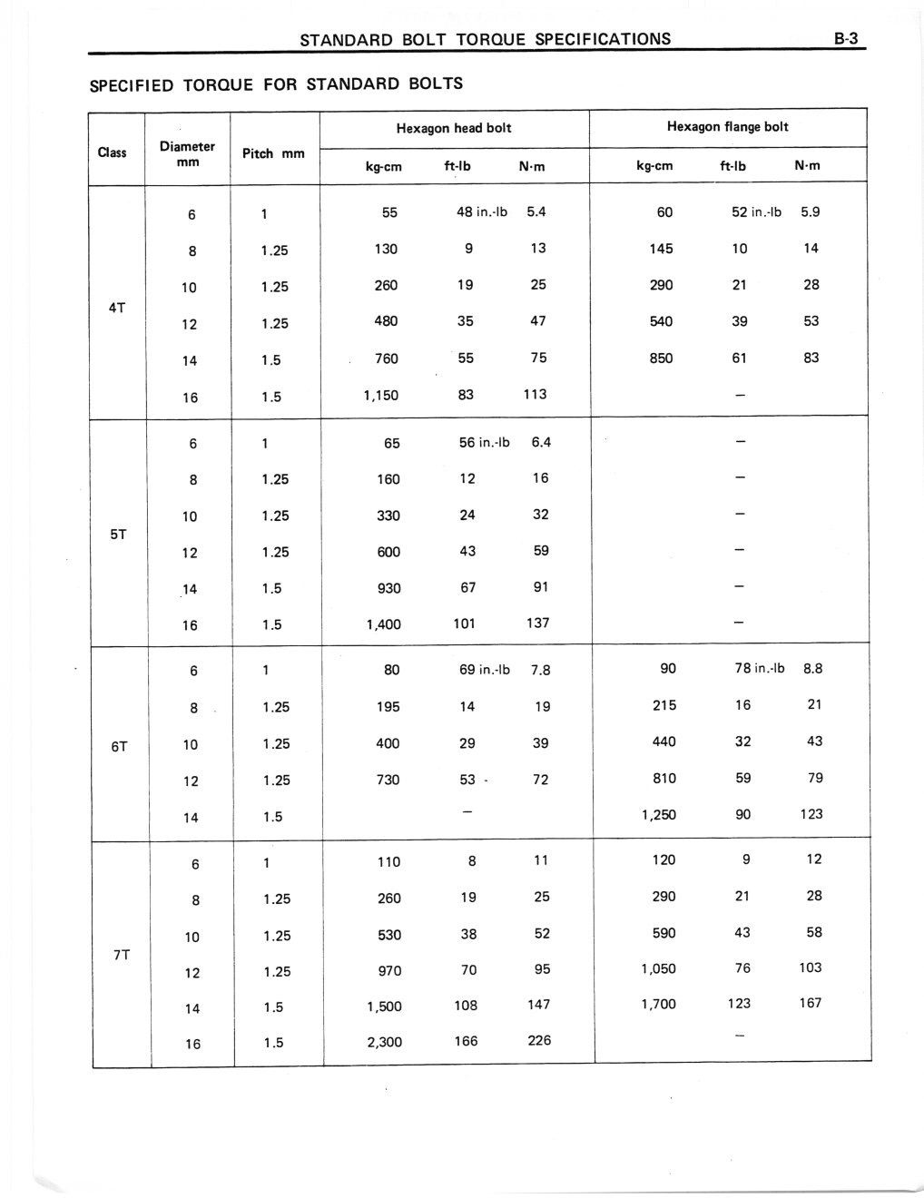

Use the guide in the back of the FSM for torque specs when it's not specifically called out in a procedure.
Those bolts are "hexagon head bolts".
Thanks, just used the standard torque specs table in my FJ62 FSM for tightening the four bolts for mounting the 3FE A/C compressor mounting bracket to the engine/engine mounts.
