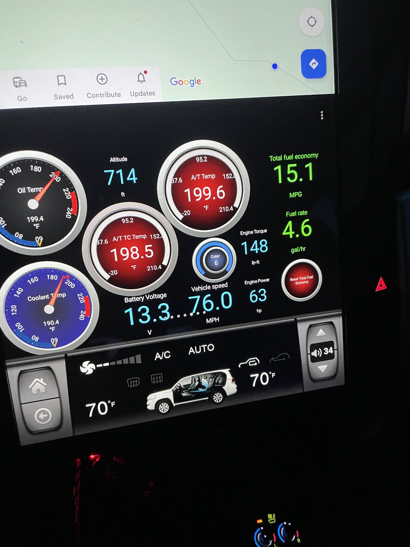

Works on 2013-2015 with 6 speed too:
The blue ring indicates lockup in the display that says “gear”.
