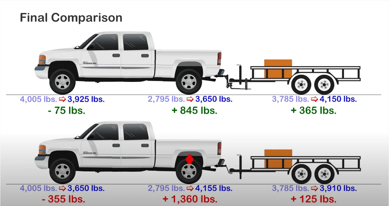

Very interesting. Do you have any examples of front axle weight going up after WD hitch install? I can't see how that's possible, at least not with a properly sized WD hitch. I think the previously posted video kind of shows that's not happening in their setup.
The bottom setup in the attached image is with airbags only, and you can see that rear axle weight went up by almost exactly tongue weight (1000lbs ) plus the amount that the front axle weight went down (355lbs). Total rear axle weight went up by 1360lbs. Front axle weight was transferred to the rear axle with the leveraged trailer tongue weight. Weight applied directly over the rear axle wouldn't do this, which is why you counteract that kind of weight with airbags, and counteract tongue weight with WD hitches.
Then in the top example, the front axle is "almost" restored to its pre-loading weight. This jives with my theory that tongue weight can never make it forward of the first pivot point it reaches, which is the rear axle, or at least that the goal of WD hitches is never to do more than return front weight to the front where it belongs. Only weight that had been transferred off the front axle to the rear can be or should be returned to the front with a WD hitch.
Interestingly, a similar amount, 365lbs, is also transferred aft to the trailer's axles, but gross combined weight has gone up 140lbs from the airbag config, probably from the weight of the WD hitch. Airbag GCW equals the total of the pre-hitched separate weights, but the WD hitch GCW is greater than the sum of the parts by 140lbs. More on that later.

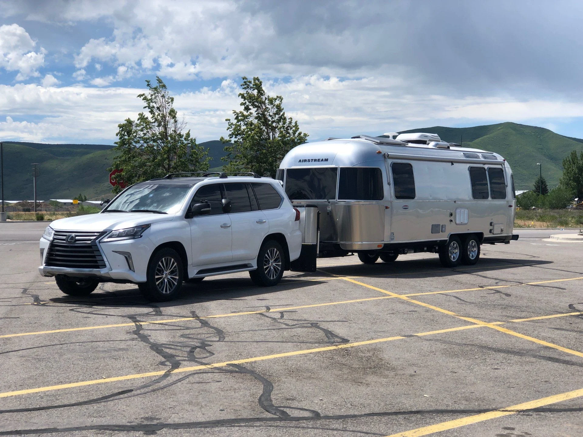

2018 Lx 570 with a 2019 25fb international

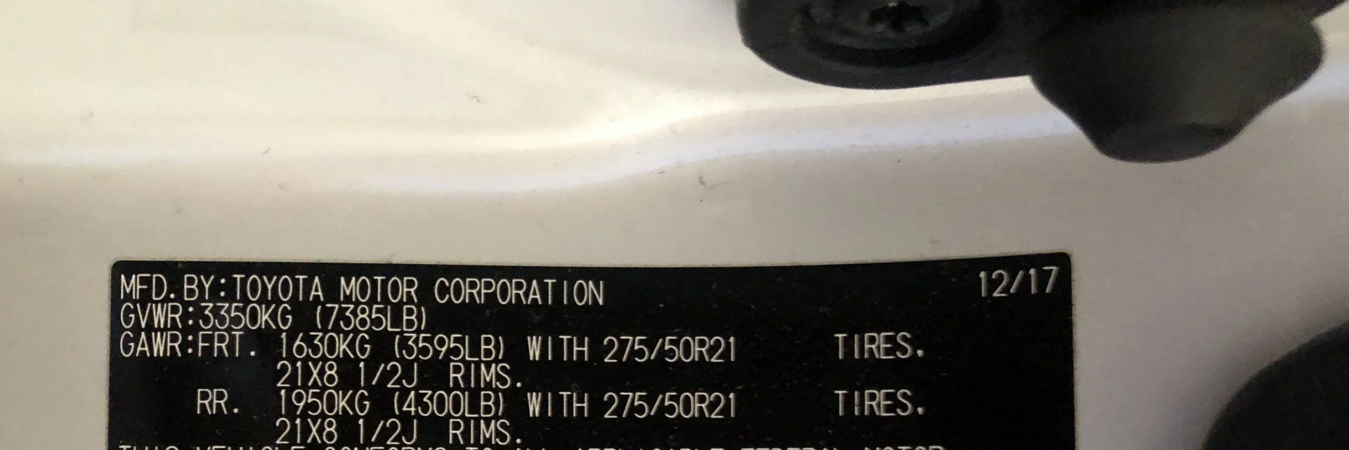

The LX570 per the door jam sticker GVWR is 7395
GCWR with trailer and LX is 13,400, Front axle rating with the 21” tires and rims 3595 front axles and 4300 rear axle.
i have 20” rims with d-rated tires with max pressure if I recall can take over 11,000 lbs so my tires are fine. I did the spring spacers to help increase spring rate as teckis300 did, took out the rear seats so my suv is 100 lbs lighter so I can put in an extra 100lbs in the suv. Understand I have a pro pride hitch with rock tamers, both components weigh in a whopping 270lbs and I also have 6volts golf cart batteries that weigh in at 79lbs each. And 200 ways of solar in the front, So my tongue weight is through the roof.

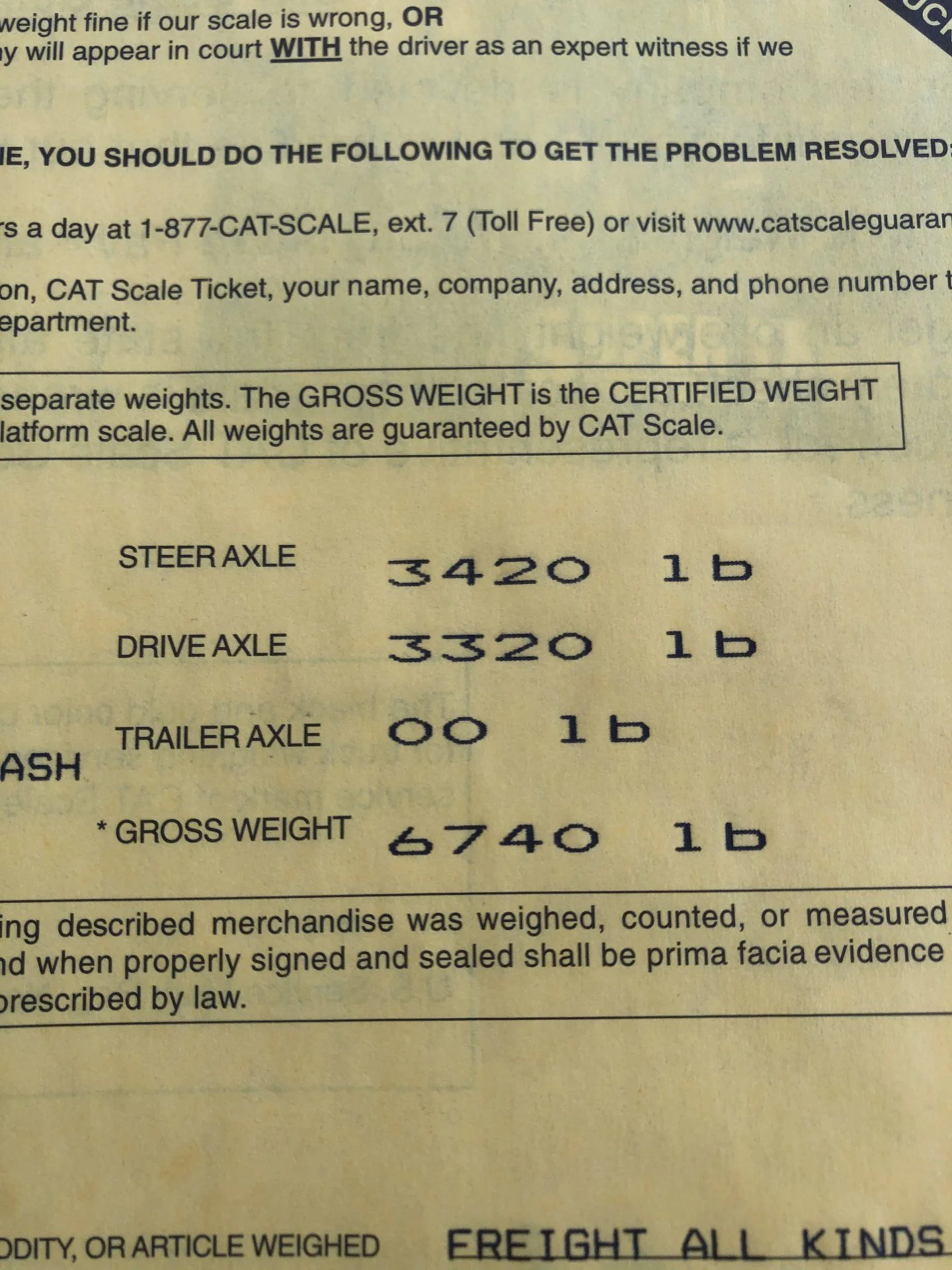

1st snap shot of the cat scale weigh in. Just the LX no gear in it “ Just the wife and 3 kids all under 7. This is the numbers on both axles.
Steer axle 3420 lbs
Drive axle 3320 lbs
Gross weight 6,740 lbs

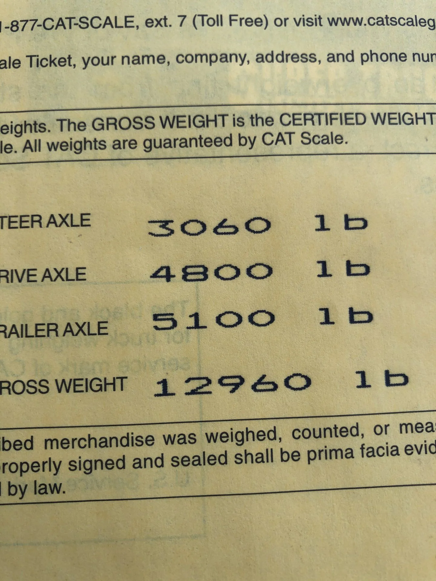

2nd snap shot of the cat scale weigh in. The LX no gear just wife and kids. The airstream totally empty just picked it up. This is set up from airstream, they couldn’t set it up right because AHC kept throwing them off and they where like “ yeah man it’s level dude it’s spot on from when you didn’t have it hitched up to when it’s hitched up. It’s pretty much perfect” what they didn’t understand is the ahc just pumped up the back to make it level. Not proper weight distribution Drive axle only 3060 lbs should be 3420 lbs
Steer axle 3060 lbs
Drive axle 4800 lbs
Trailer axle 5100 lbs

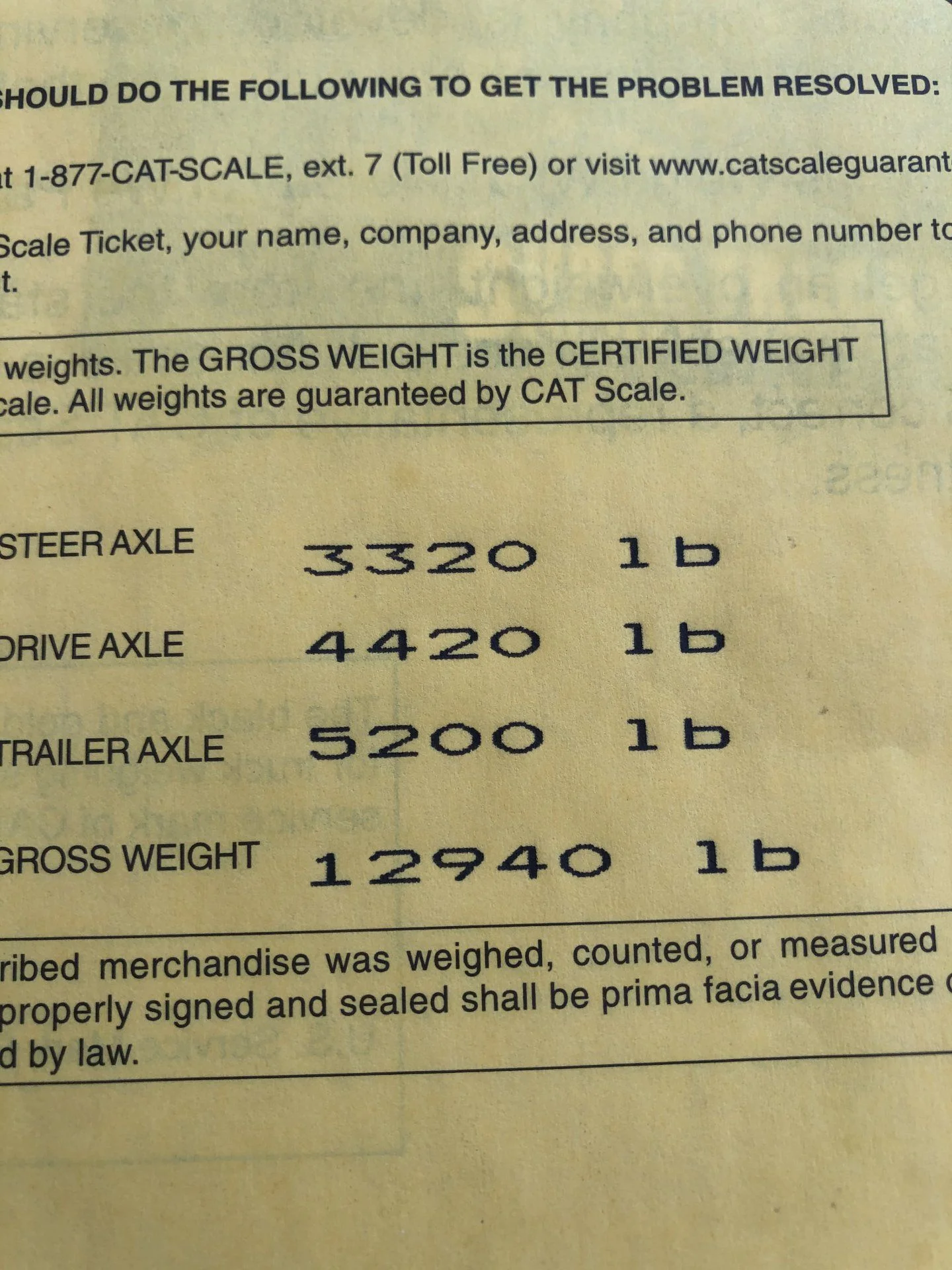

3rd snap shot cat scale weigh in. Called pro pride and talked with them, he told me to crank up the jacks to 8 1/2” I have 1,400 lbs weight distribution bars. Re weighed Still wife and kids no gear, airstream totally empty
Steer axle 3340 lbs
Drive axle 4420 lbs
Trailer 5200lbs

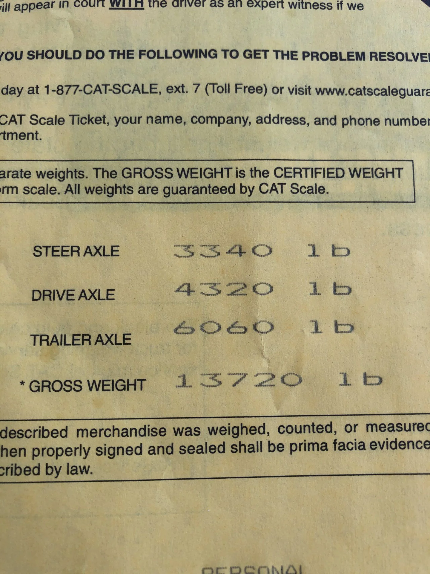

4th snap shot of the cat scale weigh in, 100% loaded, water tank 50% full, both propane tanks 100% full, golf batteries in, fridge and freezer 100% full, another 300lbs worth of food and drinks, arb 63 quart fridge in the airstream full guessing another 100lbs, goal zero 1000 in the airstream, 2 inflatable paddle boards, bike hitch installed, 100% loaded and camp ready, in fact more than I would usually do. Weight distribution bars jacked up to 9 1/2” pretty much maxed out. Note the LX only has passengers no gear in it at all no back seats, saving all my payload for hitch weight.
Steer axles 3340 lbs
only 80lbs off from initial weigh in with only the LX wife and kids no gear.
Drive axles 4320 lbs
only 20 lbs over max axles rating but I have D tires on 20s
Trailer axle 6060 we are good here
This trailer was loaded to the max and I usually don’t load it that way next time we are out camping and actually drive by a cat scale I will weigh again.
in conclusion we are pretty much maxed out with the airstream LX Combo. That being said sleeping in the trailer over 30 days towing with the propride is a breeze we have camped at 10,000 feet elevation down to 4,200 feet elevation the LX pulls it good, I am 110% sold on the propride the towing experience is 100% pleasant but I give 70% credit to the hitch and 30% to the LX, if you keep the LX from 3,000-4,500 rpms while climbing it will do fine, below that range and it’s winded. I watch how I load and have taken a lot out of the trailer to lighten the load. I never load up as much s*** as my heaviest weigh in, I just wanted to see what the max weight would be, I believe you can be within range but must be cognizant of how and what you load. Pulling this combo I am so in love with it. We go back and forth about buying a gmc Denali HD 2500 and just feel like while we can load canoes, paddle boards bikes and everything in the world on a truck that has 3600lbs of payload might be nice. But the truck is big as hell and driving around town IMO would suck ass...

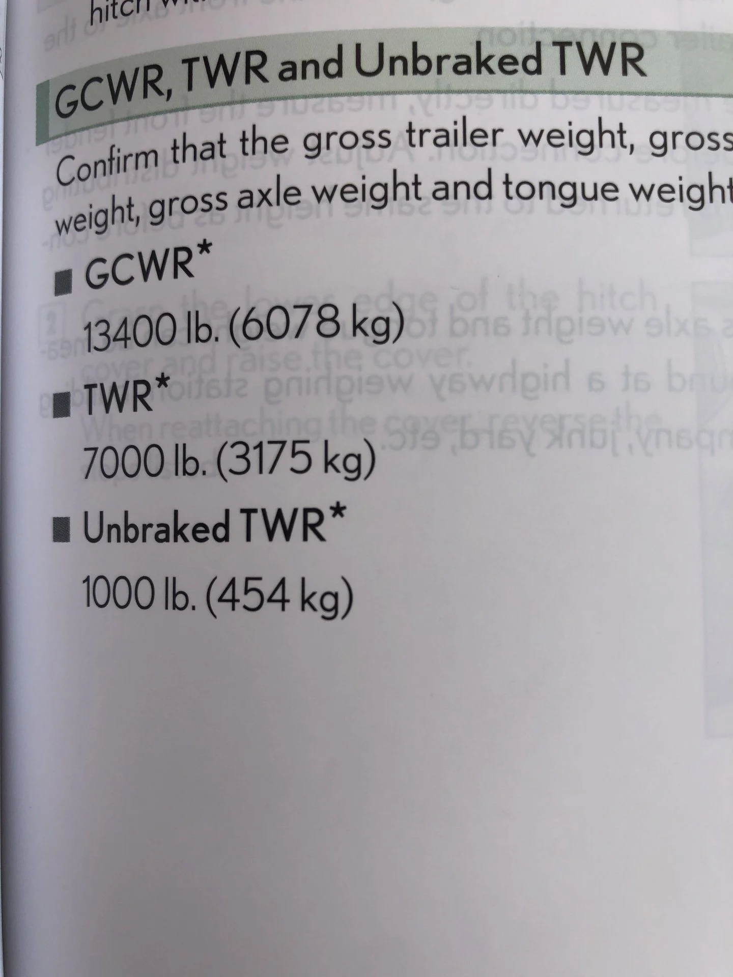

And here is a snap shot of the Lexus manual for GCWR and how the LX570 and the Airstream sit. The trailer is perfectly level I mean perfect, I put a level in the trailer had to play with the hitch raising and lowering a few times to get it right, but now I feel it’s perfect, steering handling everything is perfect. We live in the mountains so we tow going through crazy grades going from 4,200 feet all the way up to 10,000 feet down 2 lane highways that barely have enough space to fit the air stream in its own lane with its wide body 8 1/2’ stance, going 65 having big rigs pass us the opposite direction literally 2-3’ away, the set up is 100% stable. Again I recommend buying a propride. The picture of the LX in the parking lot is of it in “N” The picture at the lake is the LX in “L”
Dream combo, and very nice explanation of some very useful info. Only question I have is how is it camping in a 25’ Airstream with 3 kids? I’d love to go that route but I really worry about space and reconfiguring for bedtime.
We’ve poured over every TT we could tow and we’re leaning toward a class-c so there are seats and beds for everyone, and because we plan to take some very long trips. Thor has a floor plan so ideal we might have to risk it on their reliability issues. Washer/dryer ready. Around the same price as your Airstream given the usual ~30% off MSRP, lol.
First you need to understand my kids, they all have separate rooms with full and queen beds... I can’t get them to sleep in their own rooms they pile in one room, on one bed even to this day... so the airstream totally works for them. They all pile into one corner and are happy, I am hoping that as they get older they will be comfortable being cramped lol. For now it works great I don’t plan on upgrading hopefully for a decade or more. We looked at very many plans but opted for airstream since they seem better built. I will tell you we haven’t had very many problems with the trailer so far, Making the beds every night is an added step, and putting it away in the morning as well. But the airstream amazingly has so many cubbies, and hidden spaces, we have not actually ever filled them all up. We do have a lot of nesting kitchen items so we usually have more stuff than we need. We have never filled up the whole airstream yet, usually the over head compartment in the bedroom is 70% empty and my wife packs, double outfits with pajamas for every night for the kids, For a 3 day trip I usually pack like it’s 6 days in case cloths get dirty. The longest trip we have taken is 5 nights and the thing is great. The airstream really has a couch, a booth and a separate bed. We got a collapsible ottoman and I usually sit at the end of the booth for
It has 2 tv’s one in the room and one in the living area. Amazingly works well and we feel like we have our own space... overall I would say it’s a little tight, but we continually feel like we made the right choice.
