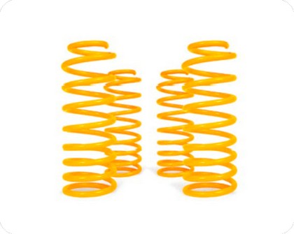

Will these work well on an 04 LX470?
http://www.andysautosport.com/products/tjm_equipped__770RSHD80B.html
Current springs are weak and sag. It feels like the AHC is having to overcompensate for the weak springs. Planning to add a rear bumper soon as well.
Thanks for the quick reply. Good to know. So, do I need to have the spacers as well, or can I just do the springs?
Just purchased the King springs. Thanks for the heads up.
I am currently lifted 3" in the rear and have the springs only, my neutral pressures are within stock range. No spacers needed. Whether you plan to lift or keep stock height, these will be sufficient. Only reason you would need a spacer is if you were lifted ~2.5" with a rear bumper, then you might want them to lower your pressures a little more.
