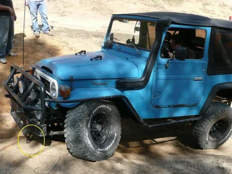

I last Saturday the current tires: 33x12.50 with 4" Skyjacker springs ..rubbing like crazy when i was on the trails.. the tires are 31'' tall (they are not new)
I plan to use the FJC stteels rims with Swampers 34x10.50x17 LTB. I need longer shackles for rear and front..have already longer brakes lines. For be honest im was looking on Man A Fre web site and others places,,,but i dont know how long i would need in inches between pin to pin..:frown: and i will prefer the anti-inversion model shackles for both..so WHO can send me a link for go straight to my issue..thanks..in advance.

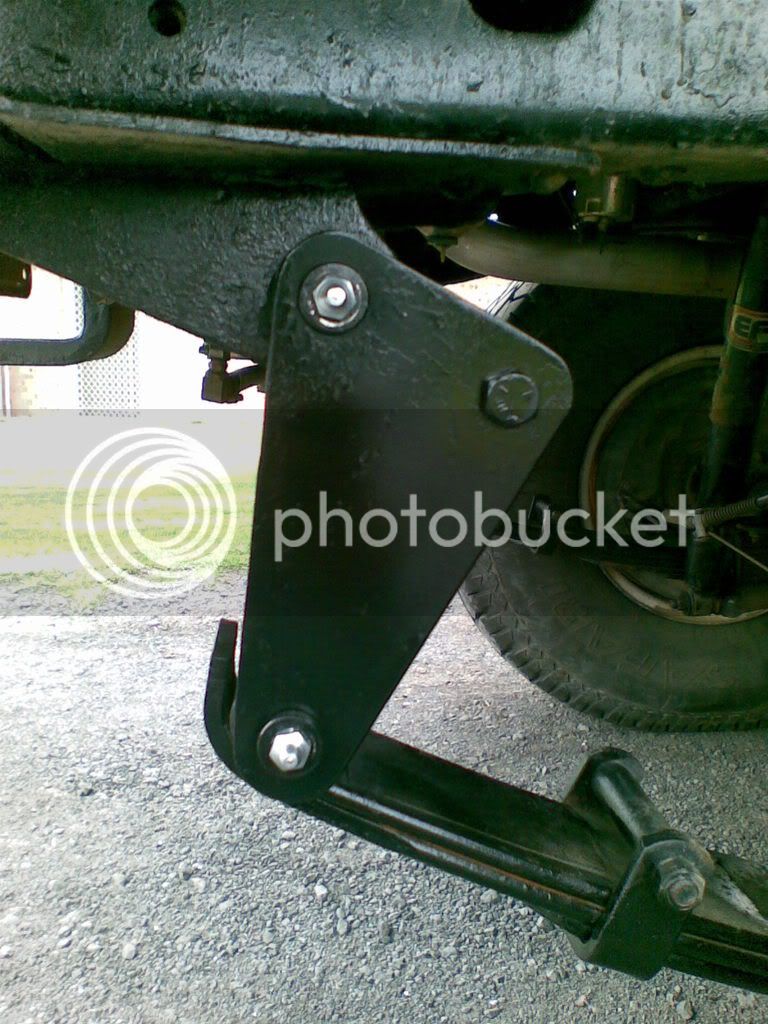

Thanks for the reply's..the 40 have already wheels spacers ( 1 1/4 wide) and i need it for the 17 '' rim FJ steelies.. but not plan to do soa and dont have money for taller springs more than 4'' . So anyone point on anti-inversion shackels,longer than the one showing in the pictures?? body lift will be the last resource.
just remember for every inch of lift you will need two inch longer shackles..... so you need lets say two inches of lift to not rub or rub less your talking 4" longer shackles. There isnt anything wrong with slightly longer shackles infact you could argue some advantages when you are flexing but......
This is what you would end up with assuming you are not shackle reversal:

I made my own shackles up & they are about 7" between bolt centres.
Car is SUA 4" springs & 2" body lift
I run 35's without them rubbing on the guards but they do foul on the standard steering
arm when turning to the right with some compression on the front right wheel. but a 60 series conversion will fix that.
