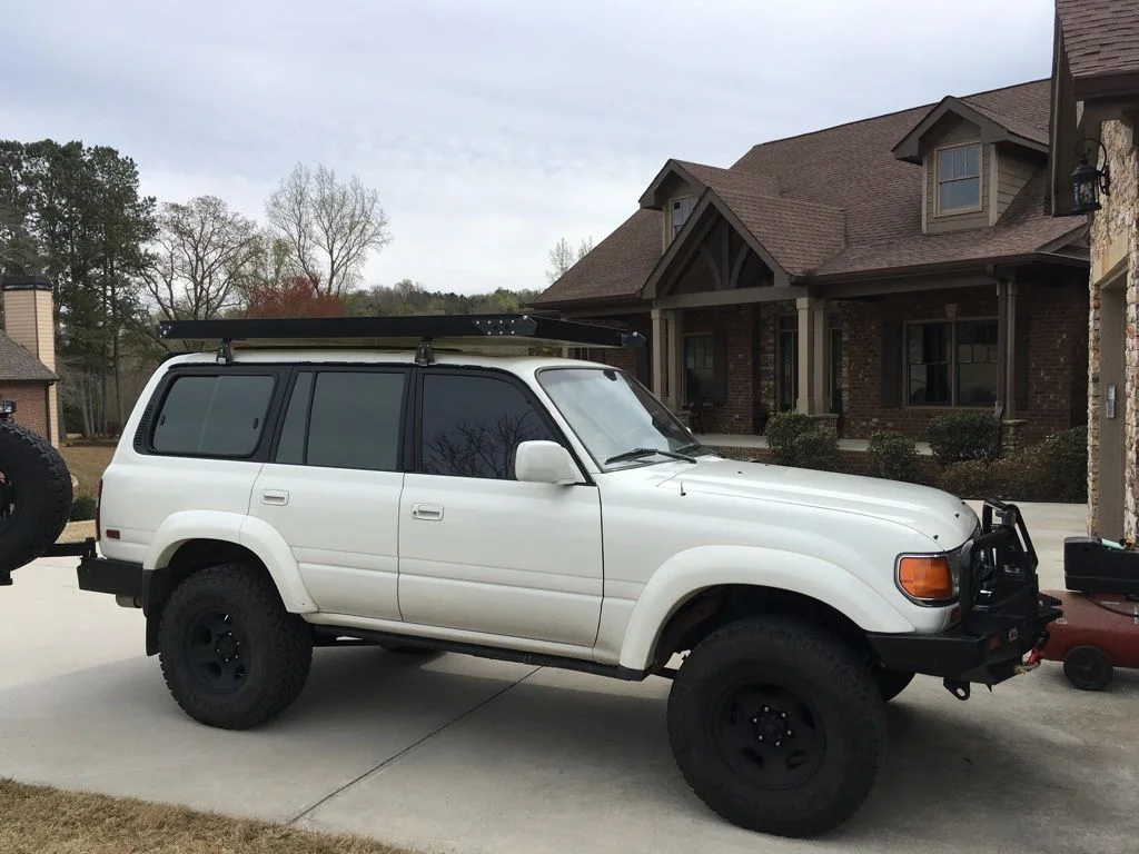

Test fitting 002 on an FZJ80 today. Stay tuned.
As promised. One seriously cool turbo'd FZJ80 with a test fit of prototype 001. 002 will be on this rig heading west to Cruise Moab very soon.
A couple notes: This will be a direct mount to get the tent as low as possible. Total height (from roof) is approx 7.5"

Looks good. Is it just the angle or are you not able to open the back of the 80 all the way with the tent attached?
Actually 001 is just sitting up there, not attached, so we didn't make any adjustments. We just wanted to see what it looked like. We also had the bottom half of 002 (which will be my tent) up there, and we set it carefully so that the liftgate will open fine. This is the only pic I got of that, and it opens perfectly.
