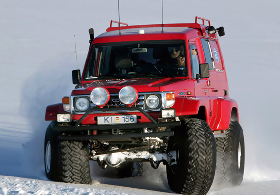

What do the Arctic Truck guys run, 44s?
IIRC Peter Straub's super bitchin' sprung over 74 had (has?) 39" IROKS
