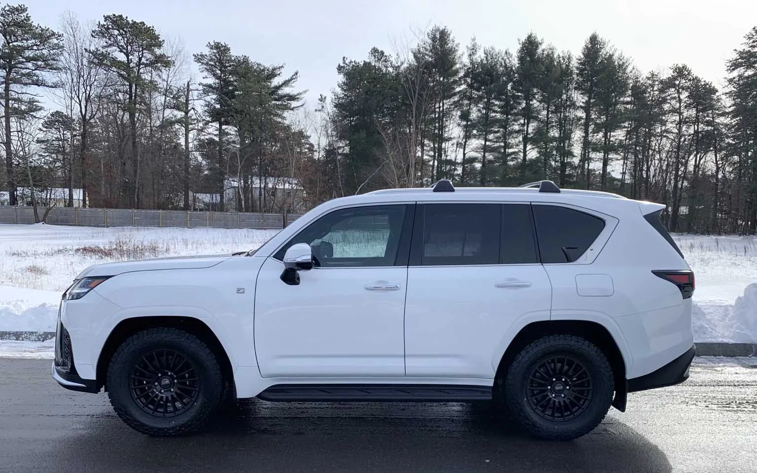

I went with this setup and am really happy:

The problem with these is that you have to go aggressive AT sidewall look or complete opposite. There is very little in between unless you go with a higher inset wheel like the JAOS +55.
If you go with the Michelin I think the 285/55/20 is the way to go as it is about stock height but 20mm wider. You frankly would probably be most happy with this tire.
