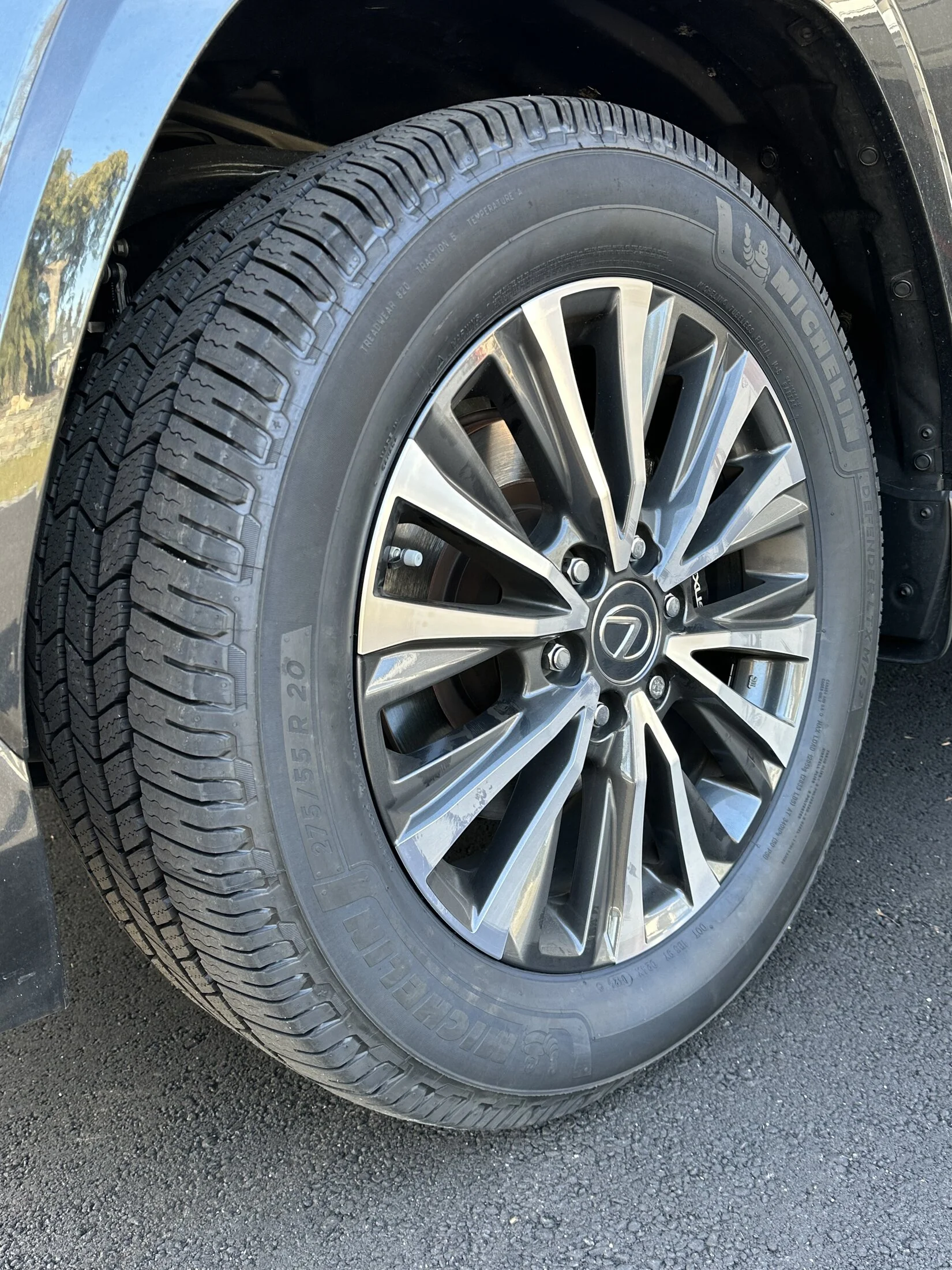

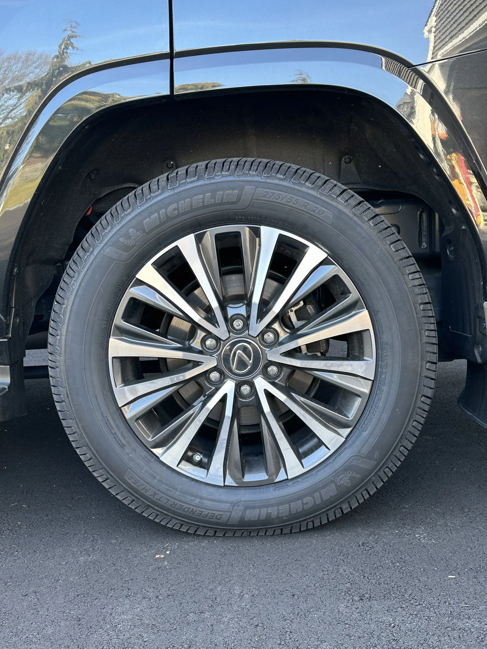

Run the 285/55/20. Its 32.4” tall according to tire rack. Stock 22s are 32.5 or 32.6 depending on what site you look at.
My 285s are 32.3 and look good. I have pics on here floating around. Speedometer is fine, less than 1mph off at freeway speeds.

I will say a 9.5” wide wheel with +30 offset and the 285 tire is close to the edge of the fender. A 10 inch would work but thats pushing it.

I like the idea of a tire that is a bit larger and I may go with 285's when I get new tires. I am assuming that the 285s would work on the stock 20" wheels without issues in normal use (non off-road)

But I looked it up and a 285/55/20 can be good down to a 7.5 inch wheel. Thats personally the tire I would run with a 20” wheel.

According to Michelin you can run the 285/55/20 on a 7.5 inch rim so the stock rims are GTG.
