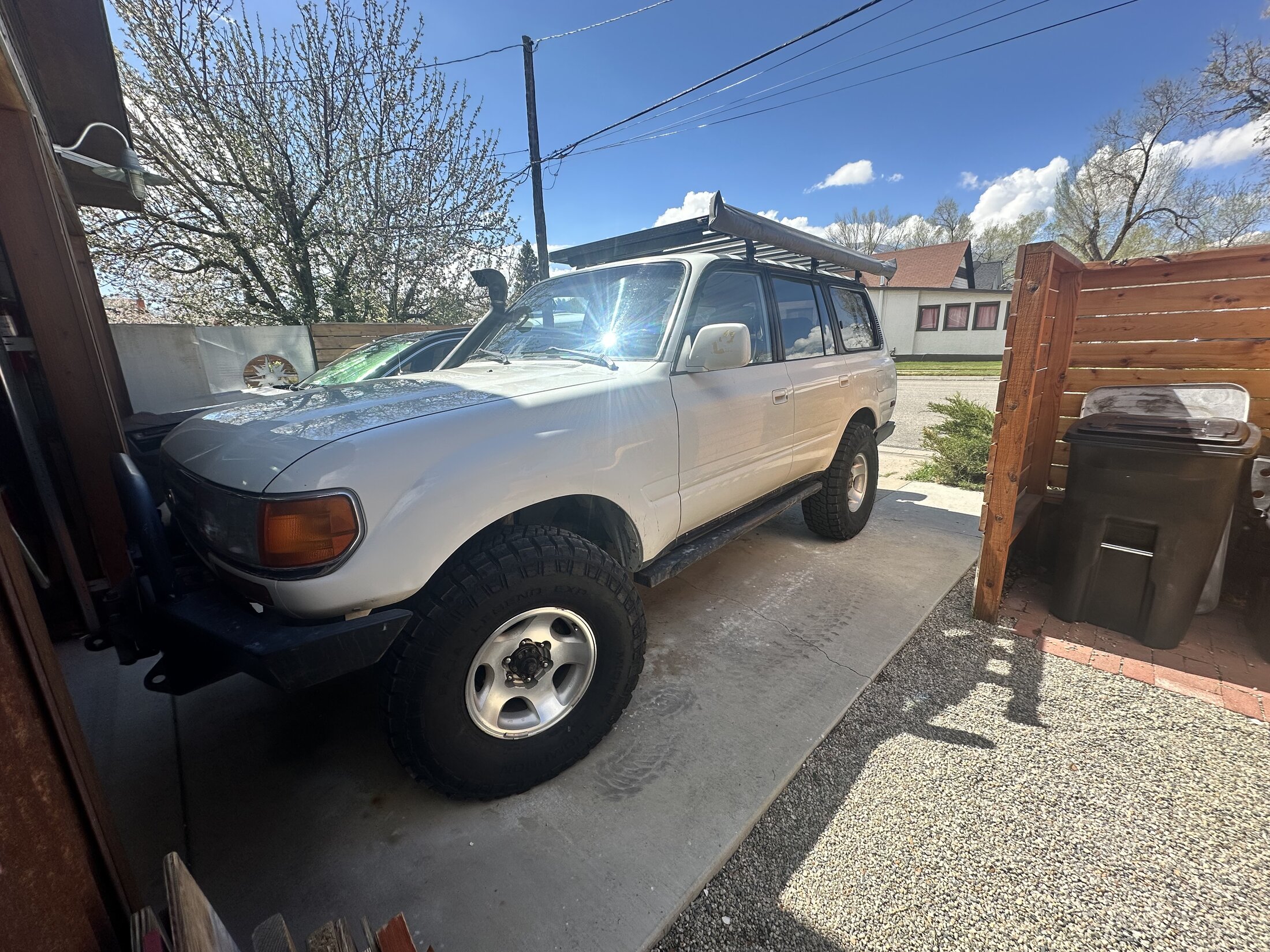

Hey - I'm going to be selling my triple locked 80 in Colorado after I do some clean up. It needs tires before I put it on the market. I have 4:56 gears in it and an OME 2-3" lift and de-flared and is fully armored, including swing out. Would you as a buyer prefer a set of five 285/75/16 or 315/75/16? It currently has 255/85/16s, but most people don't seem to like skinnies, and they are significantly more expensive than the larger sizes. I'm going with ATs or hybrids.
Thanks for your input!

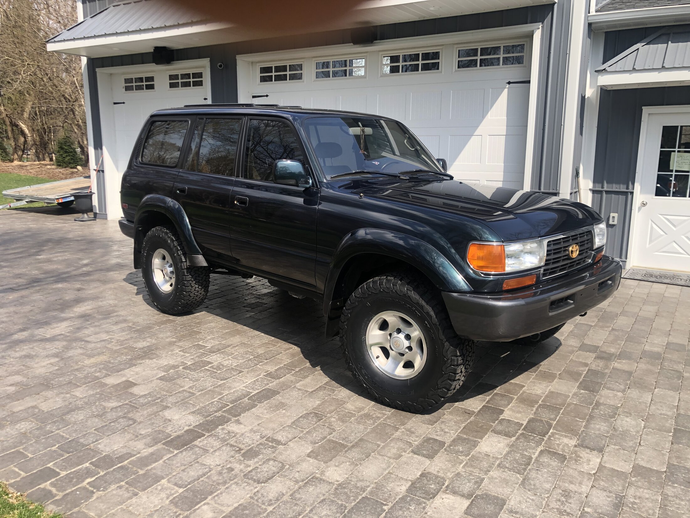

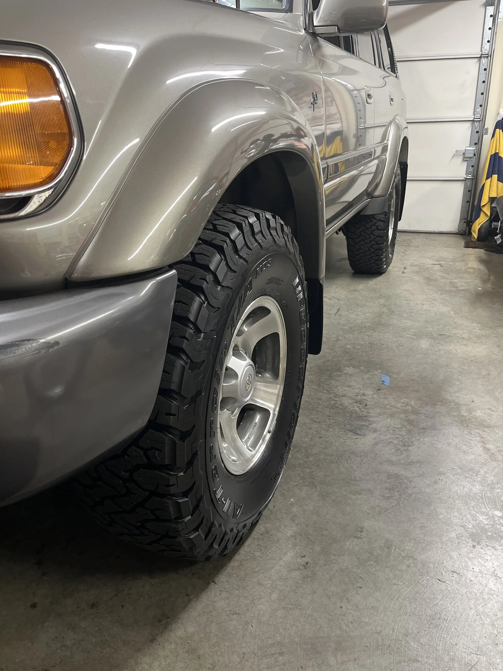

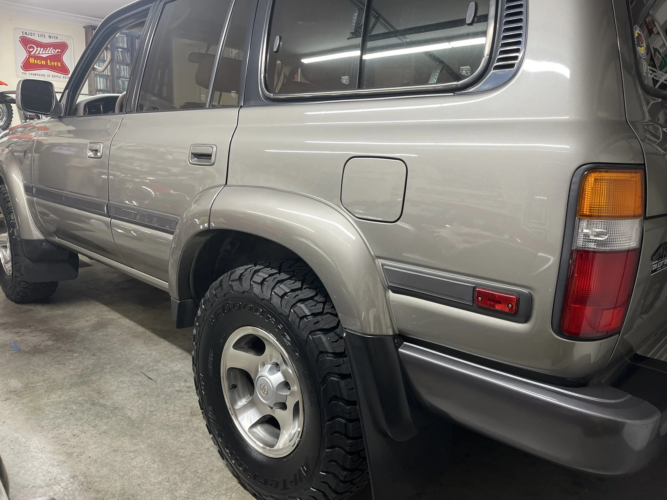

315’s look perfect on a lifted 80 especially since you already have gears and a swing out to hang a full size spare that eliminates the 2 biggest Challenges.
285’s are too small with a lift in my opinion, however for others considering a happy medium for a slightly lifted truck with stock gearing and a desire to keep the spare underneath, 295/75/16’s are an excellent compromise.
I ran 295 BFG KO2’s on a 3.5” lifted truck (until they were discontinued) and it performed great. I recently added a set of 295 KO3’s to a very low mileage 40th anniversary with new OEM stock springs and Slee spacers and it is great for a stockish 80 series.

Oh yeah! I forgot 295s. Looks like a few different manufacturers have them now. Nice 80!
