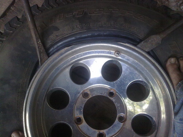

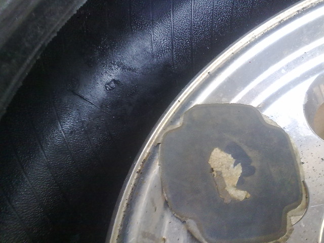

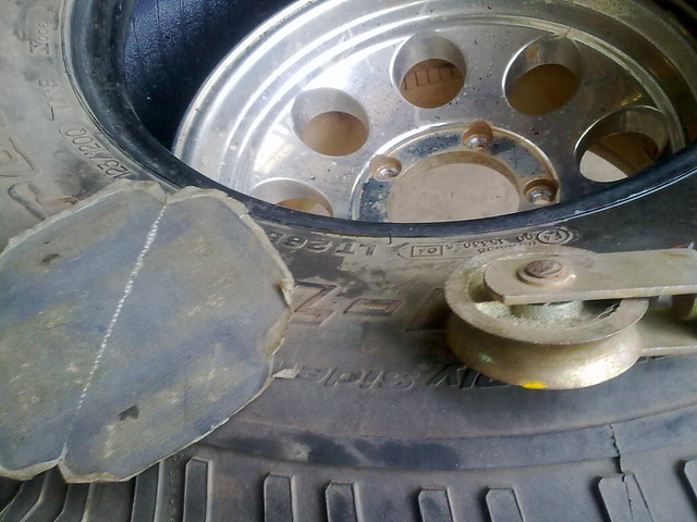

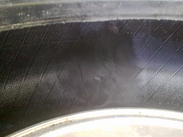

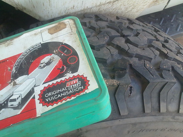

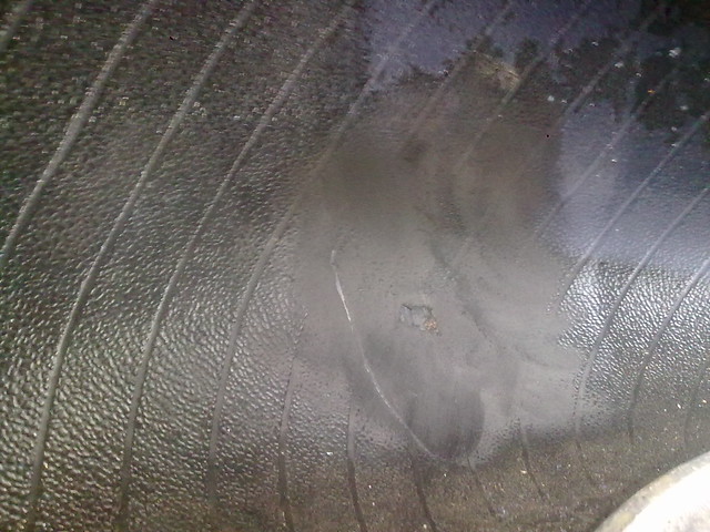

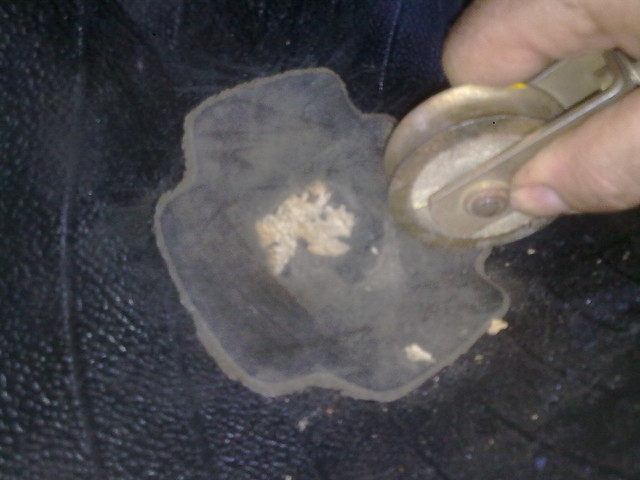

I recently got a slice in my side wall near the tread and patched it a few times with plugs and finally took the time to do a proper fix so I documented with the photos posted below. If this helps someone - cool.

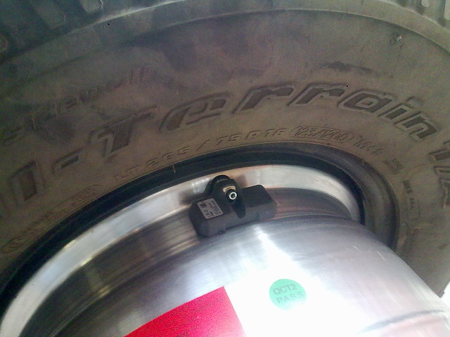

If you have sensors in the tyres be careful... here are mine

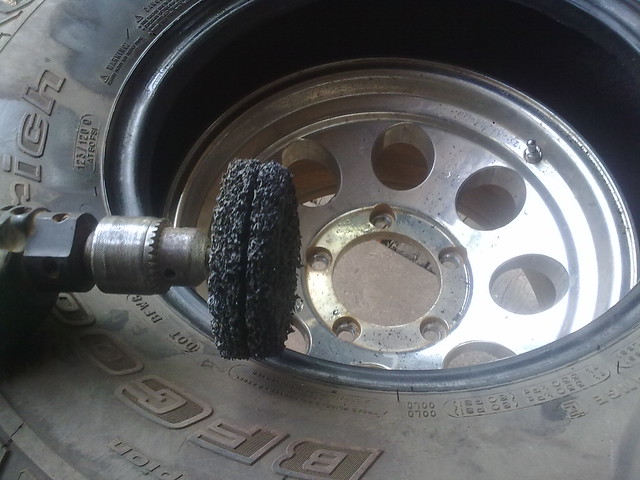

Then prep the spot inside the tyre using a patch grater or similar tool... I had one of these handy
This is always sounds contradictory but rough it up... making a smooth area larger than than the patch.
Spread the vulcanizing glue over the area and let dry till no longer tacky... if in question wait some more... go for a coffee... not a beer that takes too long ;)
Peel the backing off the bottom of the patch and don't forget to do a good job you need a stitcher... a wheel to roll across the patch causing it to adhere. Here in Africa you sometime have to improvise.
Make sure you have the right position :ban:as you cannot take it back off :o Then roll the stitcher across the patch working out the edges especially. From the centre in all directions to prevent peeling.

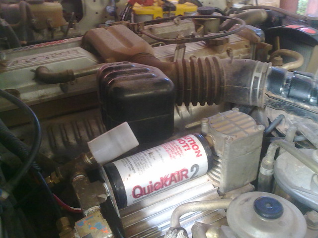

Now reassemble your tyre and pump it up with your handy dandy on-board compressor :bounce:
If done well this should last the life of your tyre... or until the next piece of stray scrap metal :cheers:
http://www.flickr.com/photos/weebear/9042625902/
http://www.flickr.com/photos/weebear/9042628784/
