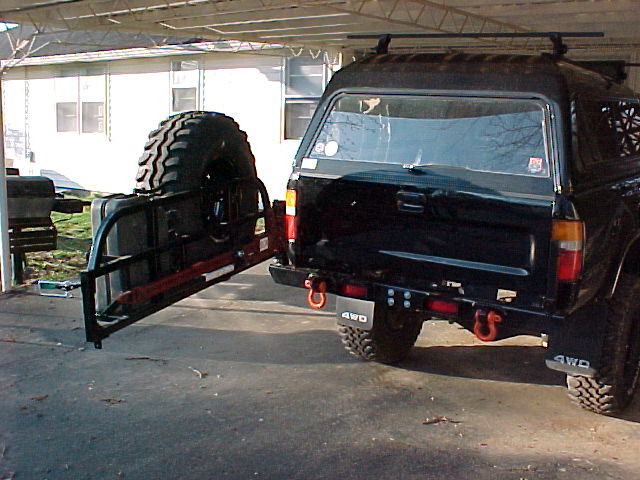

I assume you're referring to an FJ40 tire carrier. If I'm not mistaken, the FJ40's tire carrier supports itself from the truck's body. You have to keep in mind that the side panels of the pickup bed do not have real support to witstand lateral forces. When the tailgate is down, you can almost move the side panels by pushing them sideways.
I'd recommend something that is supported only by the bumper, which in turn is attached to the chassis. You may want to look at Stout Equipment or Slee for ideas. Here's one I really like:

The bumper does look great though!

Don't think you'll find one for the pickup. You might be able to adapt the 4Runner carrier from badlandbumpers.com. I have it on my 4Runner and like it. I'll probably make modifications to move it closer to the body, but I don't anticipate that being an issue.
The only design issue is the hing. It uses bushings, which definitely prevents squeaks, but the weight of the tire wallows out the bushing quickly. I'm going to replace with custom brass next Spring.
