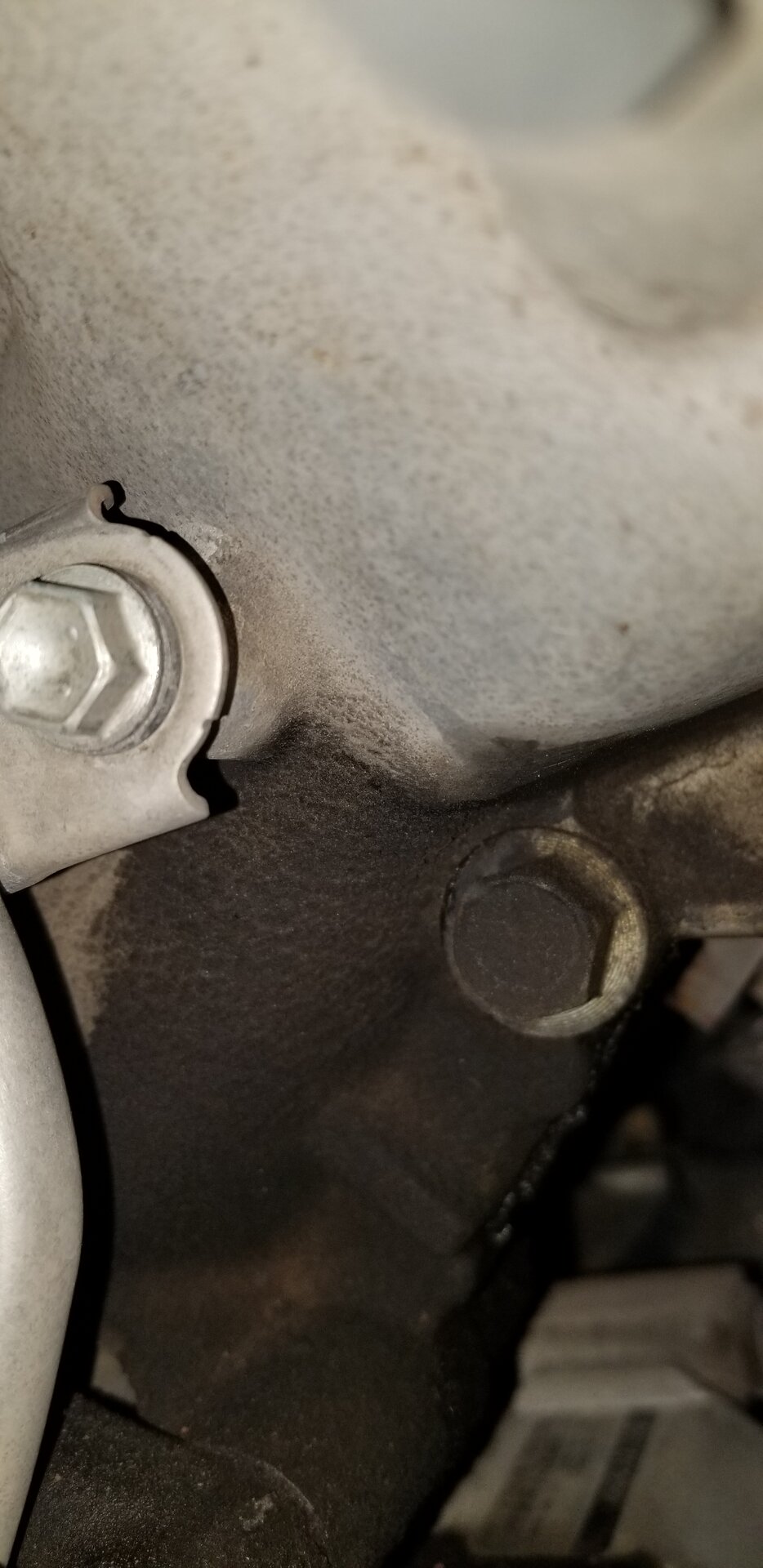

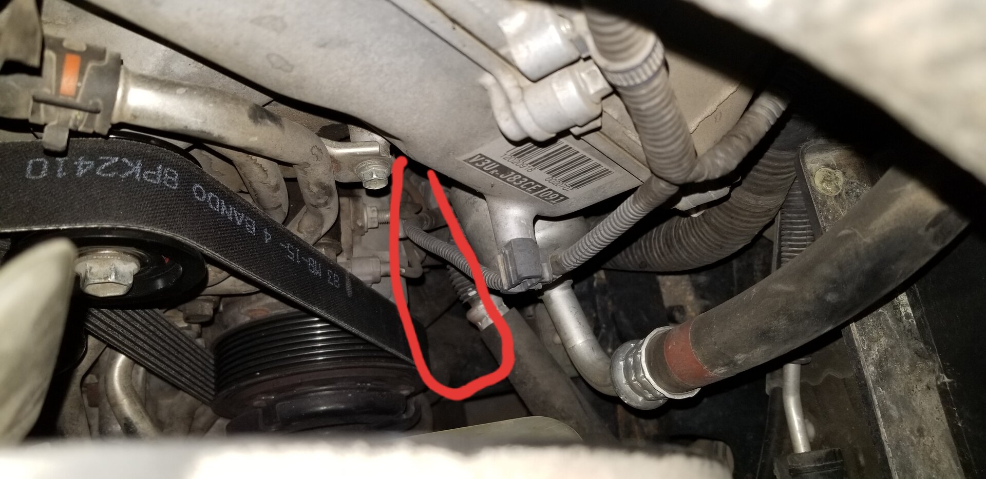

First pick is a general area for reference. Second is the best pic i could take based on the location of the leak.
Clean it up and let it ride. A whole lot of stuff has to come off to fix that leak. It will be a very expensive job for a leak that will never end up being very bad.
Mine has been similar for over 80k miles and as long as I clean it every oil change it never hits the ground.
My 2013's timing cover looks nearly the same, maybe a smidge more oily residue collecting on the AC compressor. Hasn't noticeably progressed any worse over a couple years. First discovered it around 95k and now at 120k. @bloc good to hear after 80k things are still holding. I really don't want to tear down the whole front end.
Mine is definitely worse, and to be honest has progressed over that 80k, but as I said it still doesn’t hit the ground. It does bother me a bit that it’s there but even with being able to do the work in my driveway, it is such a huge job it’s not with messing with for a minor leak.
