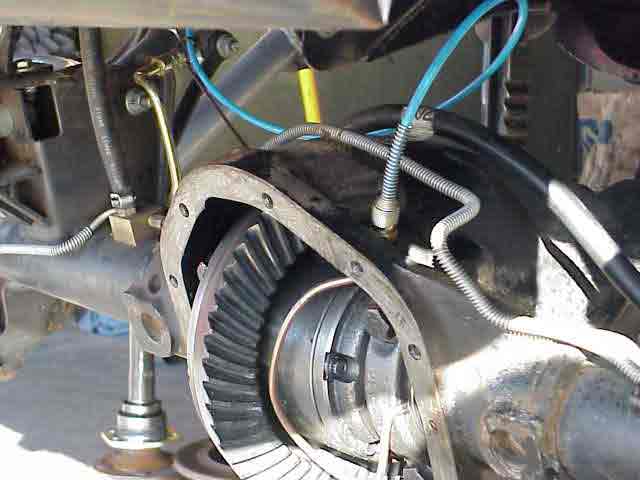

This is what I mean......once these guys are installed...the nipple is there, but no hose connected...
(jeep pic)
Obviously I would not have air to lock the diff, so they would be unlocked...
But would I have fluid squirting out or something or could that just be left open, maybe wrap some tape around it to keep it clean?

Something to consider. see the blue air line. I sleeved almost the entire length of my air line inside 1/4" fuel line. My compressor is in the rear quarter panel where the jack was and my ARB is in the front diff. Thru the quarter panel, under the carpet, thru the firewall and down to the diff, less than 1 foot of the total length is not sleeved.
It wasn't easy to do, but with a little WD40 and some patience, I made it happen.
