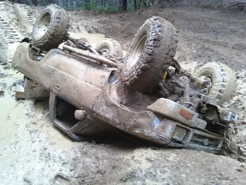

I wheel with a guy that is a bit on the wild side.... he ran 33-36"s at times. Every trip they/we expected the IFS to explode (plus the spiders were welded). We thought it was making crazy sounds and seconds away from exploding when he flopped it over on its top where we found it to be a broken transmission mount allowing the driveline to hit on occasion (hard bounces). Moral of my story is not that it may be your transmission mount but that the IFS is so much tougher than I ever gave it credit for oh and I am not recommending you roll it over to check as there are easier ways. He eventually sold the truck and never had an issue with it! What does my story sound far fetched?? See for yourself :D
