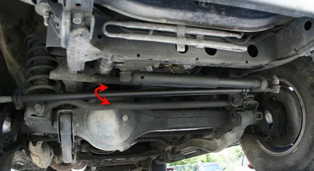

I was under my rig this weekend checking for any form of leaks. Out of curiosity, I hold on to the tie rod near the steering damper. I tried to roll it back and forth (in circular fashion) and I was able to. It rolled by hand abouu 10-15 degrees back and forth. Since am new to LC/4x4, I'm not sure if this is normal - I don't have any steering problems yet. Please see pic (not mine but from a web post) to illustrate what I mean.

I replaced my TRE's when I rebuilt my axle. IIRC, that sounds about right for the normal range of motion for the TRE's to swivel back and forth.

That's an old trick in Banawe to fool you into getting a repair you don't need. The only real way I know to check the TRE's is by dismounting them and then trying to move them by hand. That can be a job. The next best is to just see if you have wander or easy road pull. If the drive on the ride is steady and assured, you're ok.

mine is moving quite a bit too, seems to be normal given the design of the joints. You do need some play to avoid binding when the suspension moves.

I recently replaced mine. What i found was that the old ones were very loose feeling and i could twist/move them easily. Also, the boots were leaking.
With the new ones on, they still move, but are much stiffer and feel much more solid. Also, no leaky boots either.

I check them by compressing the joint (big pair of channel locks, or push up from below) if they compress they are pooched, rod rotation as described is normal.
