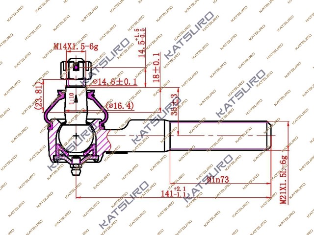

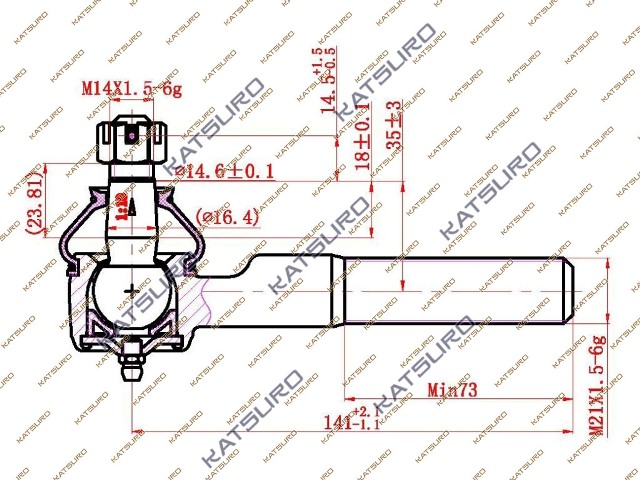

Below is what's supposed to be on the L/H side of the fwd steering rod.
If the one supplied is threaded the wrong way has your steering rod been removed completely and installed the wrong way around? as one side is R/H thread and the other L/H thread.
This is for the L/H rod end P/N 45045-69065 which is a R/H thread
This is for the R/H rod end P/N 45044-69097 which is a L/H thread

This is a great help. The truck is at a local shop, so I cant take any pictures now. I was wondering if the rod had been turned over. The problem with one of the parts delivered was that the thread pitch was backwards.
My mechanic just called. He finally got someone in a parts house to listen, and to send the right part. Yes, the rod had been flipped over at some point in the past. We now will have one of each of the parts you list above. I'm having both replaced, and flipping the rod back to normal so 10 years from now, I won't be fighting this same thing again.
