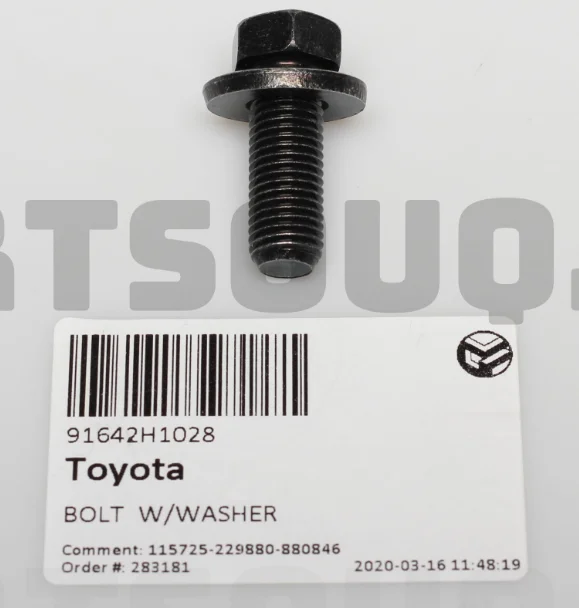

Pretty sure this is what you're after:

You should be able to see if the bolts have been damaged. Do the threads look all fat and shiny? If so you'll need the die or to get new bolts. In any case I think it's a good idea to get the tap and clean out the nuts. Those don't look easy to replace.

Yeah agree replacing bolts isn't going to fix it. Need to clean out the and rethread the bolt hole. Thanks for the info guys!
