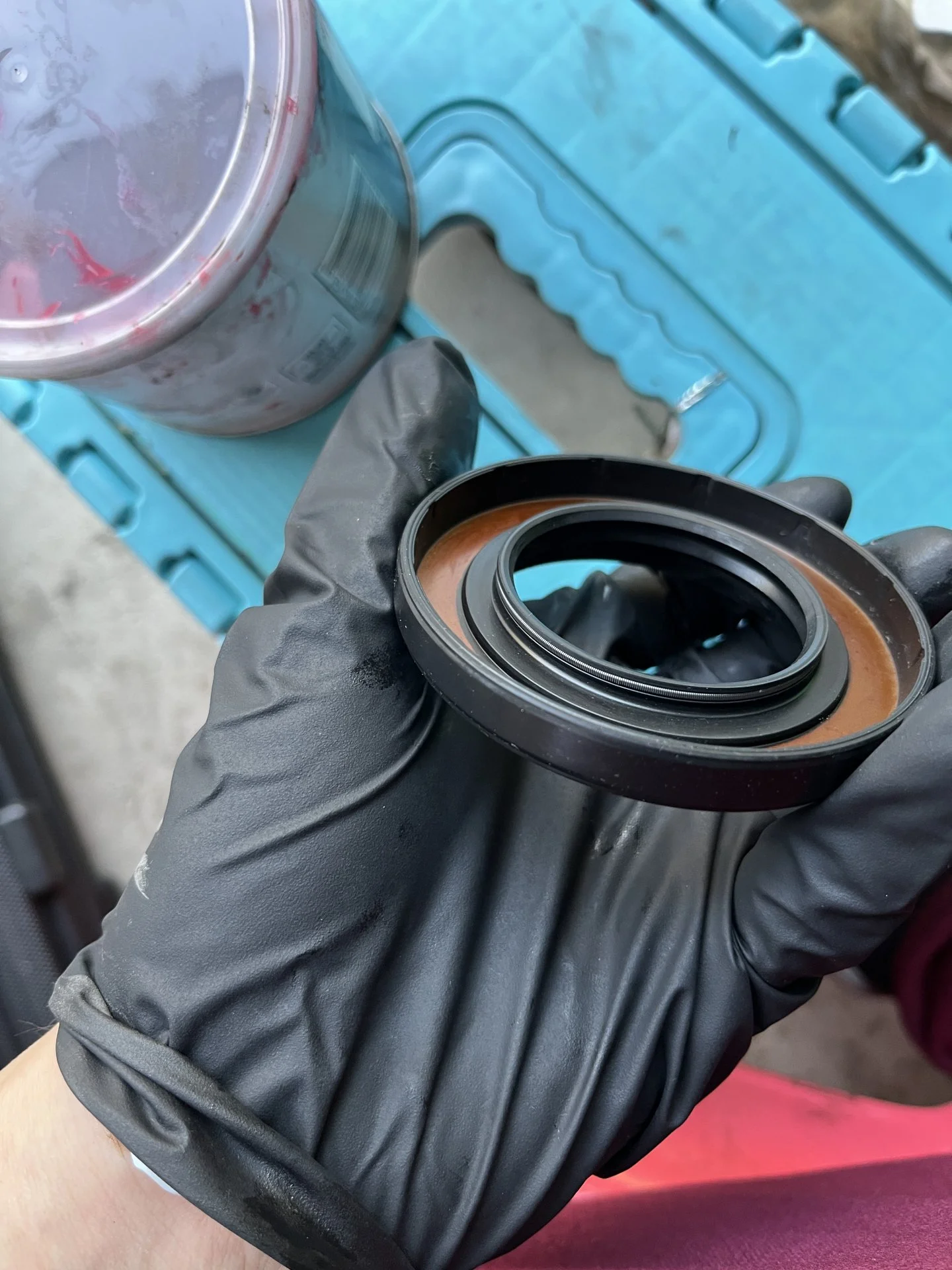

Any idea what this spring is? it came out of the diff housing together with the diff oil seal. DS.
It’s just a spring that keeps the inner lip of the seal tight to the inboard CV axle shaft. Throw it in the trash - your new seal will already have one.
