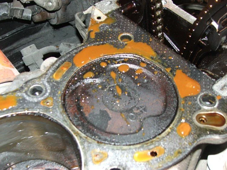

After seeing how well the "green stuff" protected mine, I'm sticking with Mr T's KoolAid.
With such obvious neglect by the PO, why do you blame the "green stuff"? Anyone who reads the FAQ on the cooling system can see that the long life coolant has it's problems and shouldn't be used in the 80. The "green stuff" that Andrew & I are referring to is Prestone All Makes and Models, not Long Life. What's important, whether you use green or red, is 1. stick with what your using and don't mix; & 2. Don't neglect your cooling system. Flush & replace at least every other year.

If you are using some other brand of coolant, rock on. I have seen many vehicles with nasty cooling systems over the years. Do you blame the coolant or the owner? Both? In my case both with this particular 80 and other Toyotas I have owned, I put much of the onus on the coolant. After speaking with a couple of people who have way more experience with metalurgy than I do, I now understand why Toyota has a particular coolant for their vehicles. From what I gather, their coolants are formulated based on the various metals and alloys used in their engines and cooling systems. Having dissimilar metals with water flowing through them can create a type of galvonic corrosion. Universal coolants can be formulated to provide some degree of protection from this process based upon a general "recipe" of what metals and alloys are used in current production vehicles. While this does provide some corrosion protection, it doesn't stop or prevent it as well as a specifically designed coolant. End of rant.
