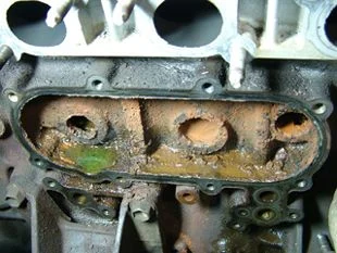

Forgot about that thread. Pay me now with frequent flushes or pay me later with .....
attachment.php
-B-
Short of dismantling the engine and boiling all parts in a chemical bath, what can be done to effectively clean the cooling system in an engine that looks like this one?
Dunno.
Prevention is the best plan but sometimes we buy trucks with no maintenance history and sometimes the insides look like this. If that were mine, I would start doing some Google searches and try to get a consensus for a flushing plan. Just guessing, but the plan would probably start with some chemical flush done routinely over a period of days and weeks, followed by a new radiator. All that crap has to end up somewhere and it is usually in the bowels of the radiator.
