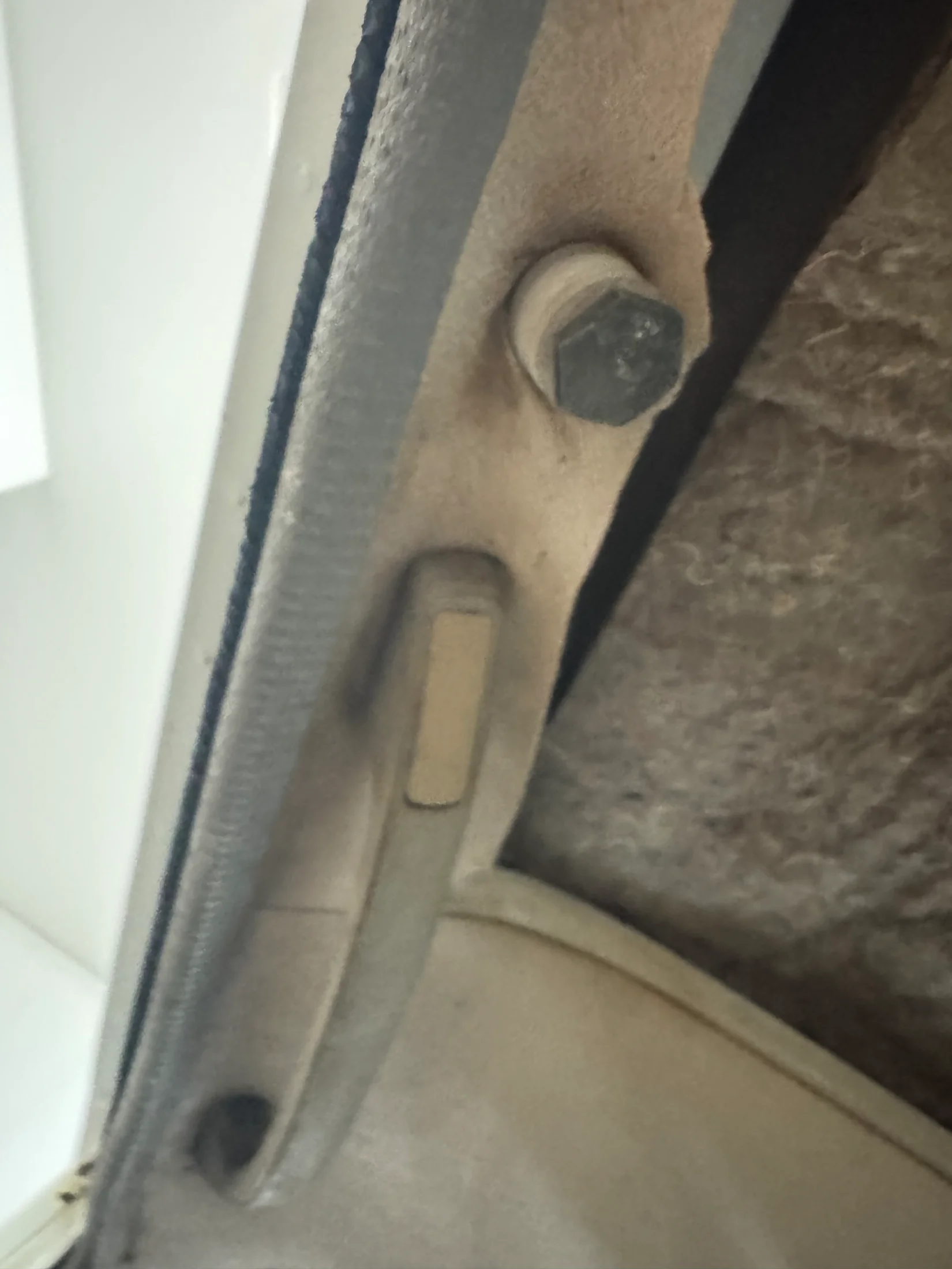

Also, what are these by the rear handles in the roof?
IIRC some 55's I've disassembled had a 3 point seatbelt, but it was a 2 piece design.
regular lap belt and then had a belt across the shoulder that you hoked into the clip of the lap belt, the shoulder was adjustable but not retractable
All the Pigs I've owned had those over the rear doors. I added them over the driver and passenger doors. Holes were already there to mount them. Useful in getting in and out...especially as more sand accumulates in the bottom of the hourglass.
