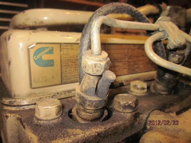

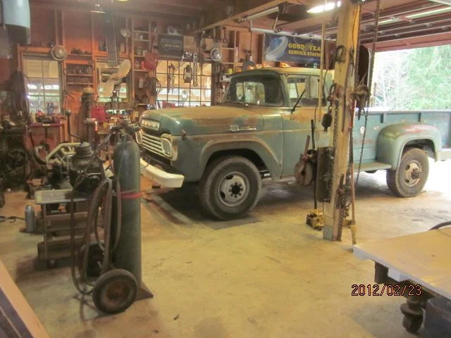

Some of us dinosaurs still like the cummins 6at. 6 cyl, turbo diesel, 120 hp in stock form. They were developed for onan gensets and in the 80s cummins offered an automotive version used primarily in UPS and Frito-lay trucks. Pretty much a direct replacement for the 292 chev inline six they took out. The bellhousing is set up for any gm tranny. (or lc adapter)....It's all mechanical and only needs a couple of wires and a fuel line to run. UPS repowered with a gm v6 in the 90s and a bunch of 6ats came on the market. I have one in a 54 gmc dump truck with a turbo 400, another in a '59 ford f350 pickup with an sm465 and a third running on a stand in my shop. They are indirect injected and develop rated hp at 3400 rpm. If nobody stops me, I'm gonna stick the last one in the fj 60 I bought this morning. To see and hear the one I swapped into my f350 last winter, go to youtube and type in (59 f350 with cummins 6at). I talked to a guy who ran one in a fj55 for 15000 miles before he sold it. Don't know the mileage on any of mine, but they all have great oil pressure and no blowby. No big powerhouse, but I get almost 20 mpg in the tank of a pickup. I see them on CL here and there. Good luck in whatever you do. Diesels are awesome.

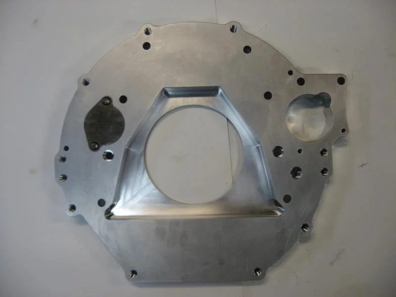

We make the adapters to go from Dodge auto to Landcruiser splitcase too, but really wouldn't recommend that route compared to keeping the original Aisin tranny. Your miles ahead beefing the old Aisin up a bit compared to re-engineering the entire drivetrain downstream of the engine.

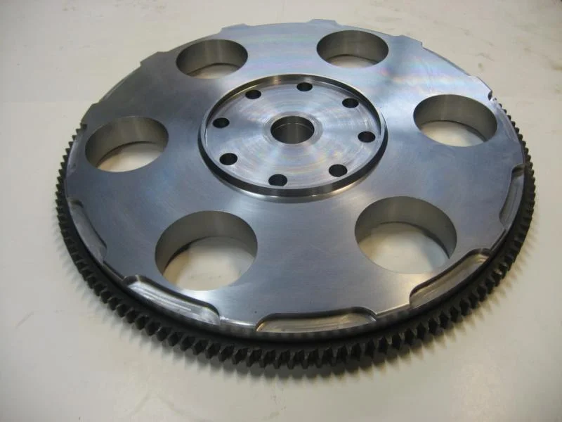

For a 4BT I'm sure it would work very well though. And they look very well machined. Do you offer steel and aluminum versions?

The bellhousing adapters are machined from 6061 plate, the flywheels are fully machined forged 1045 steel, the flexplates (not pictured) are coined from chromoly steel. If you're asking whether the bellhousing adapter is available in steel the answer is no. It would weigh 200+ pounds and offer zero advantage to heat treated 6000 series aluminum.
