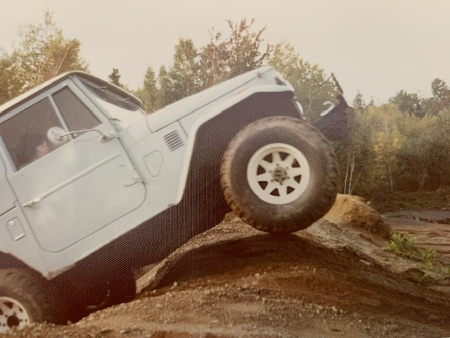

If I can impress on anyone to enjoy all you can when you can, I would sit back and smile. Don’t get me wrong, I ain’t putting anything way for good, just toning down the action…from this
———— TO THIS — ——-
