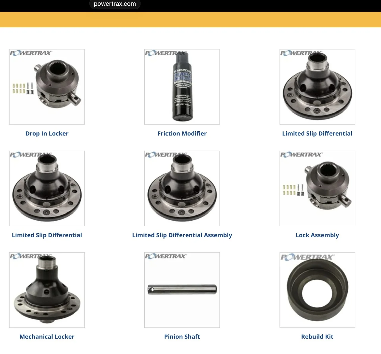

@Slammer61 you’ve got me thinking and re-thinking…did a bit of reading but which of these is the model you used in your FJ40? Might you have the part #?
View attachment 4076944Knuckle 47: Sorry for the slow response as I don't get on MUD regularly. Powertrax part number "for my year fj40" is 9220883001
