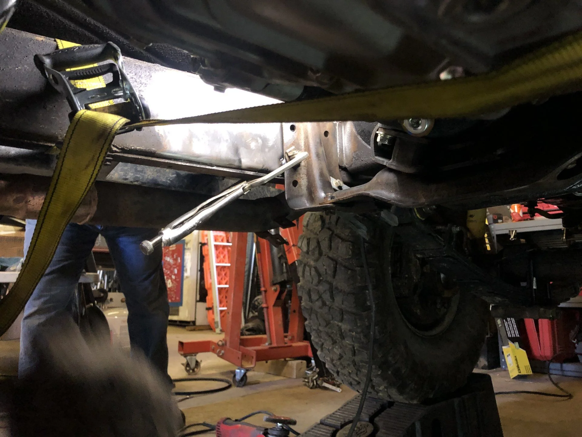

The only real issues we ran into getting the engine is were
1) I had to remove the long passenger side motor mount
2) Because of clearance issues with the exhaust we had to cut out the passenger side old oem rear motor mount. I should have just done this ahead of time but others had not so I didn’t
3) The early small square motor mounts have locating tabs on the top of them and the later mounts I used don’t have the recess for them so we had to pull them and grind them flat
Once we sorted all that out we located the height of the rear of the motor and burned in the sides of the FJ60 3 piece crossmember
We had to oval out some of the holes to get more adjustment out of the bars. We think it’s pretty close and “good enough” for me

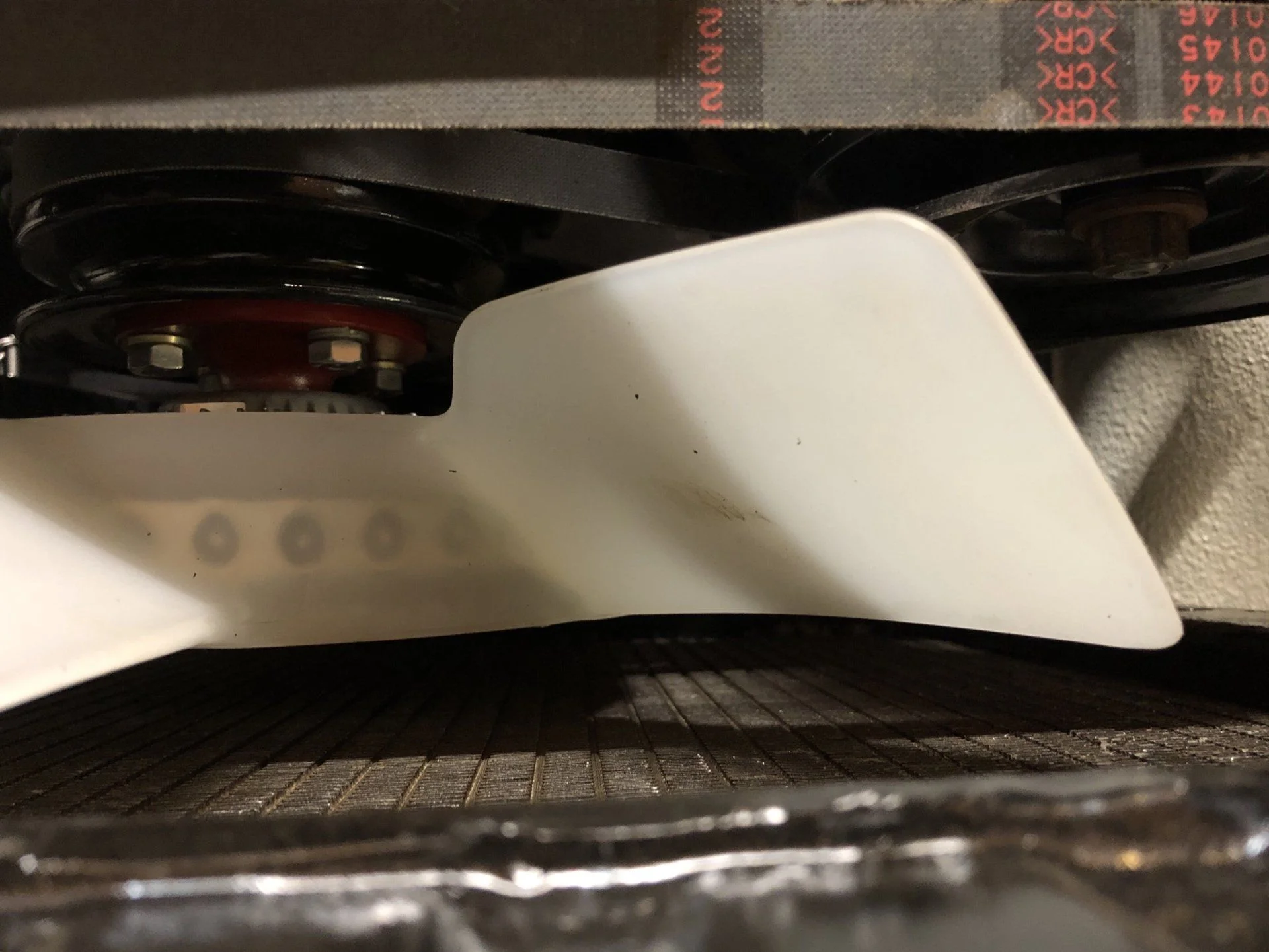

We used the fan on the radiator to get it square as we could.

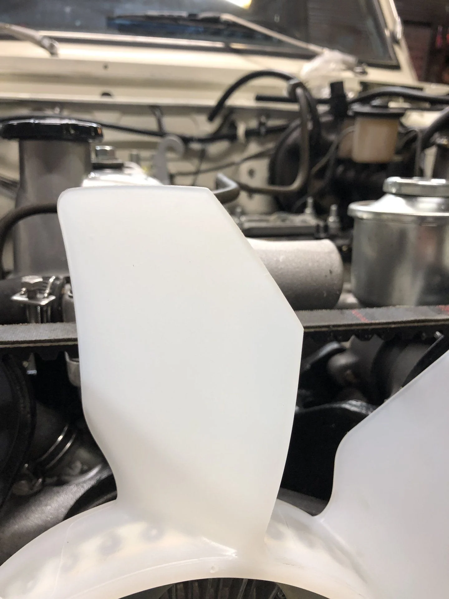

Turns out all the homework @cruiseroutfit and I did on fitting the clutch fan and T100/Taco Fan was spot on. We had 1” clearance all around

The fan was a bit close to the upper tank at the top of the arch and bottom so I trimmed the corners off the fan just to be safe
...We used the fan on the radiator to get it square as we could...
They don’t sit square from the factory, so it’s probably spot-on.

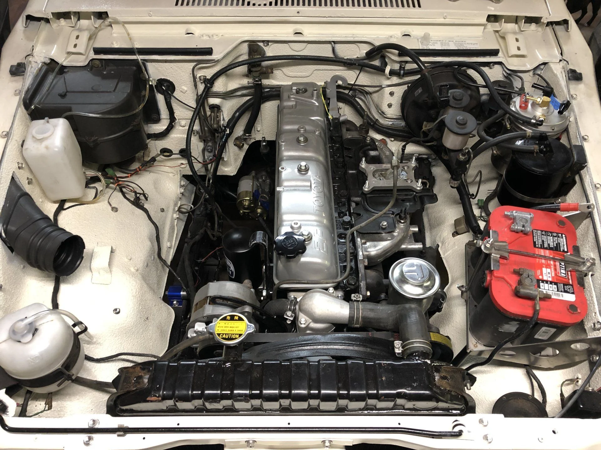

I was too close not to get some final stuff added before I called it quits.
I got the fan shroud on. Radiator. Grill. Starter. Maybe some other stuff. I forget.
Here is where I left it.

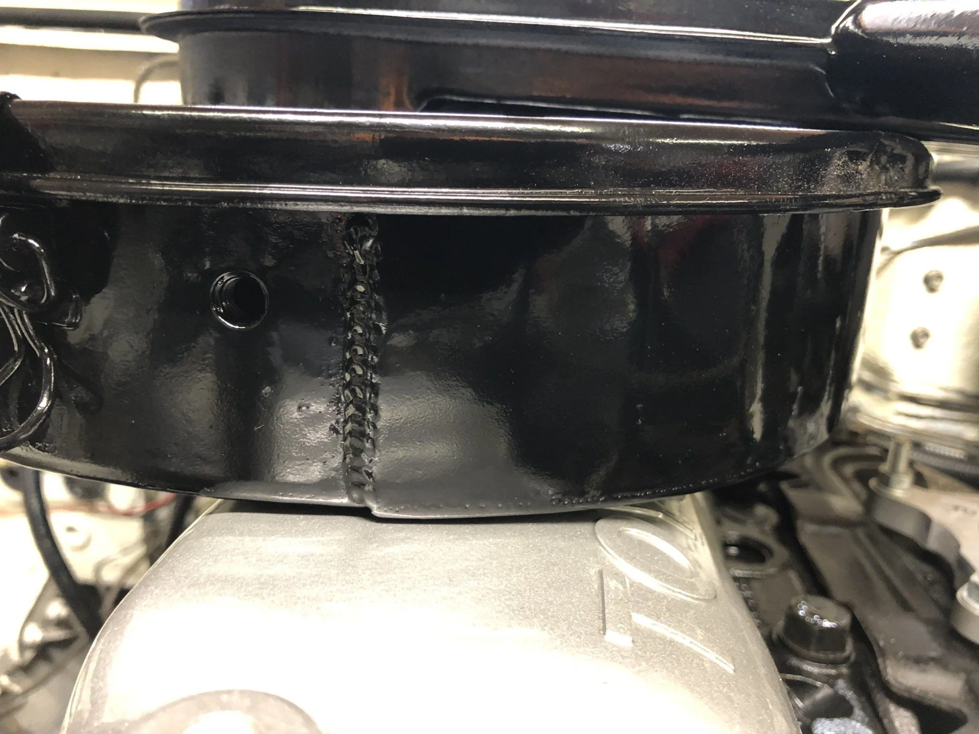

I picked up the modified OEM FJ55 air Cleaner from @lvrlose54 aka Shaw Fab.
He cut the intake off the drivers side and rewelded it on the passenger side.
Sweet work. Making the snorkel work will give the Warthog nice clean air on the dusty roads

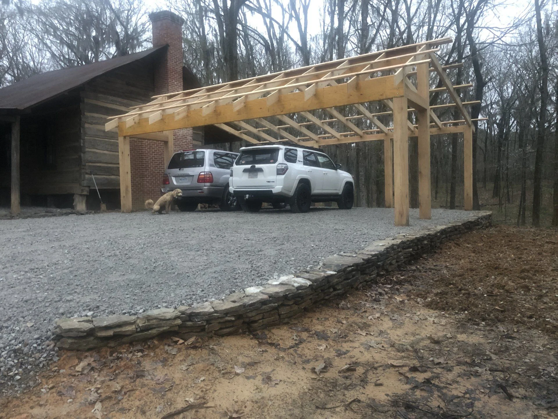

I had a full week of work this week, finished a carport Project AND my daughters 100 series brakes went out. Hopefully I can finish the brakes tomorrow and get back on the Warthog. I’m taking next Wednesday off and @USMC22 is coming up and we are gonna Fire it
