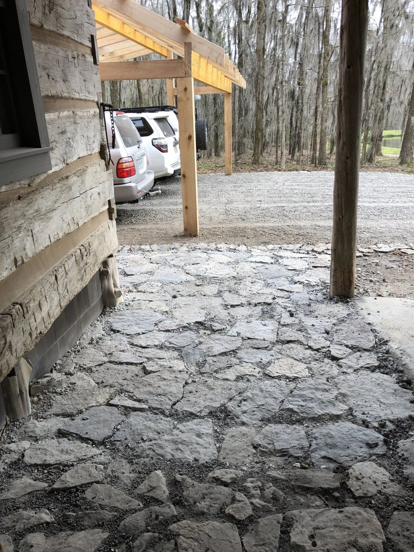

Spent the morning fixing the 100 brakes then most of the day laying 3 pallets of flag stone

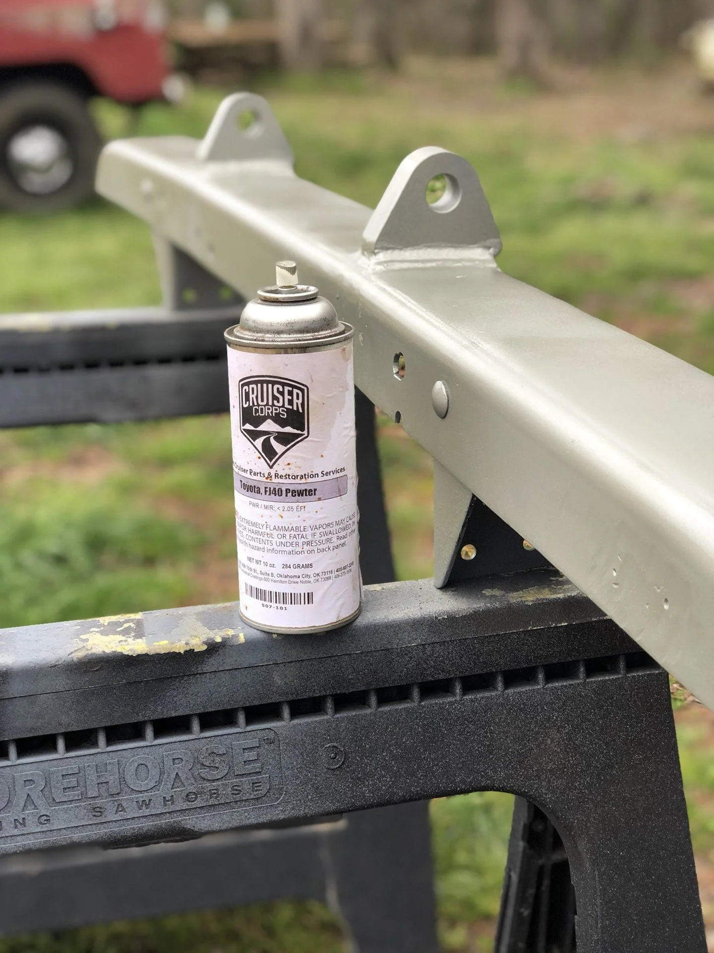

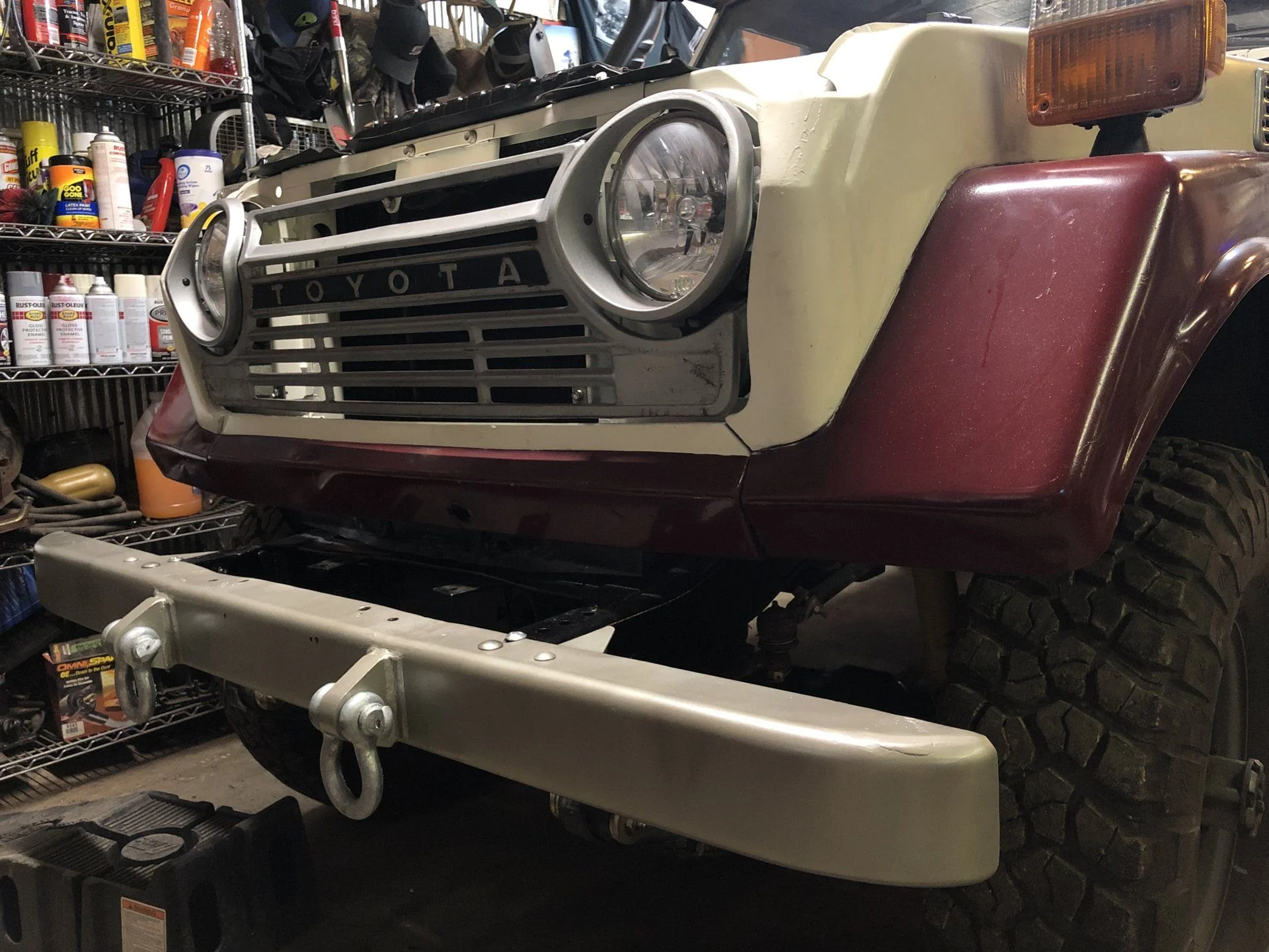

Also, they sell pewter paint in a can. I was able to lay a coat on the primed bumper

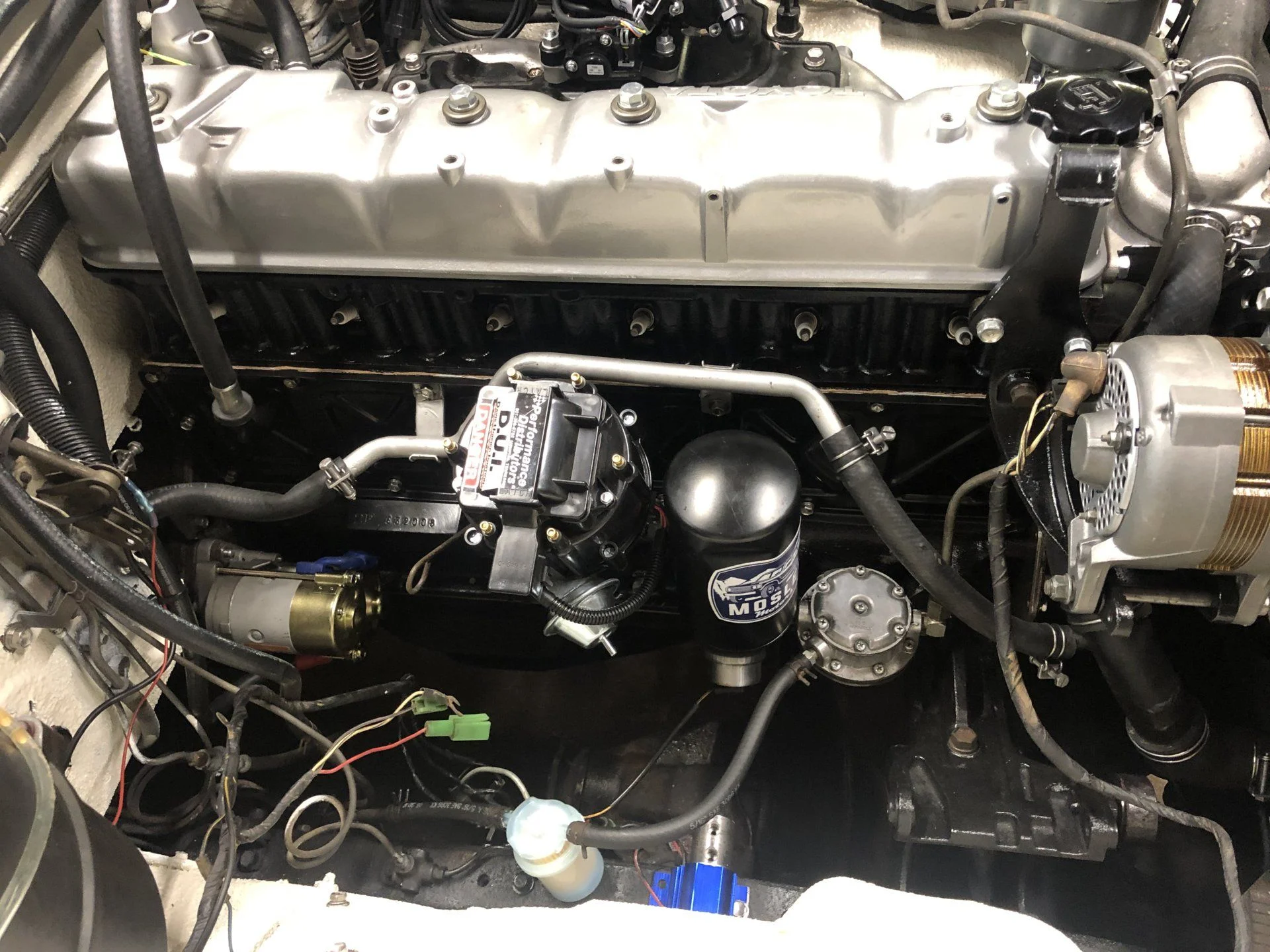

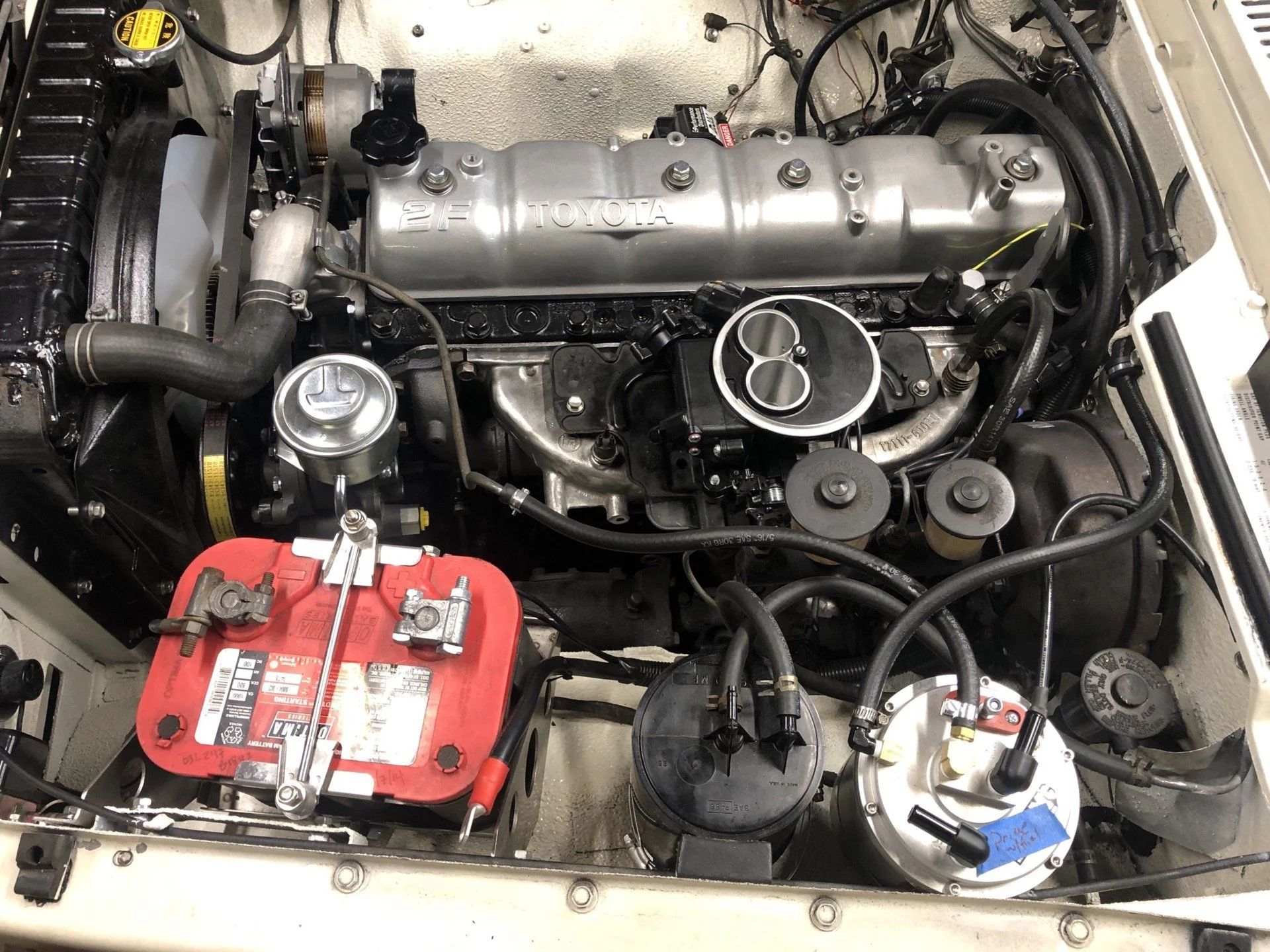

I knocked out some easy stuff.
Plumbed the heater hoses. Cleared the huge dissy. That takes some bending and banging.
1918945
Fuel lines.
Lots of little stuff.

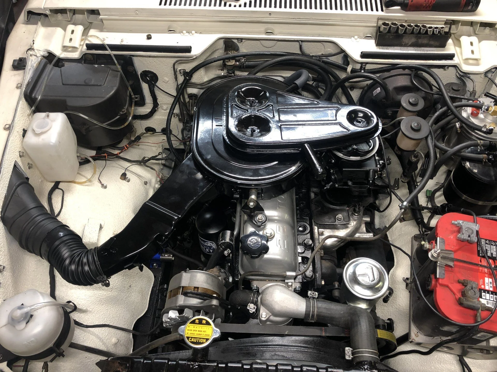

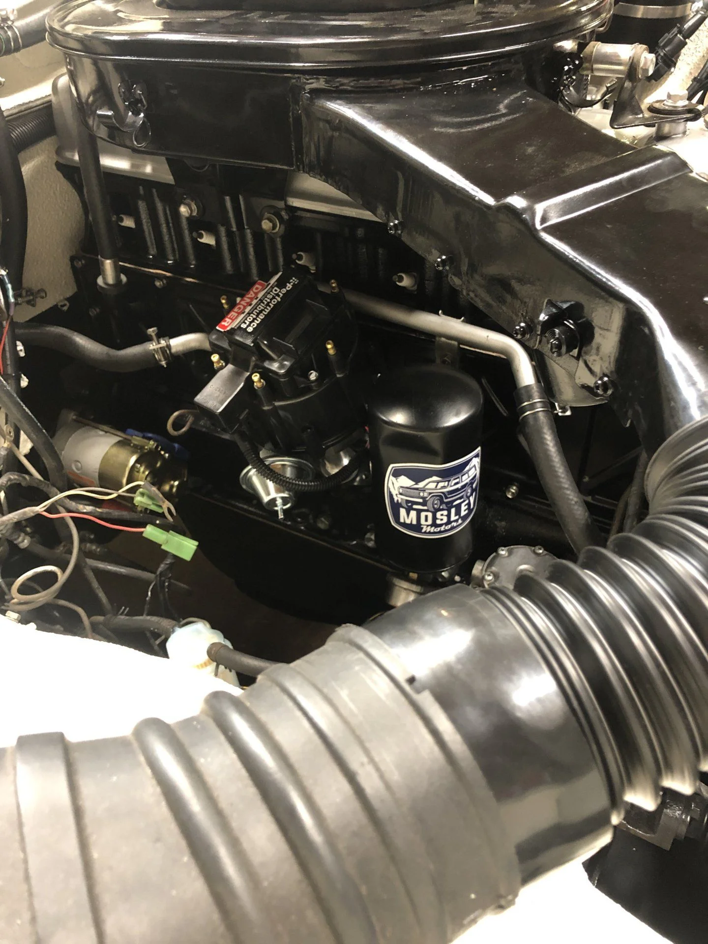

Next up was to fit the air cleaner.
I did not realize all the mounting points were different on the late valve cover versus the 1977.
I monkeyed around with it and made an extension for the front bracket. Aluminum tube with 5/16” hose inside to make it a bit flexible.
1918950
It all lined up pretty good.
1918949

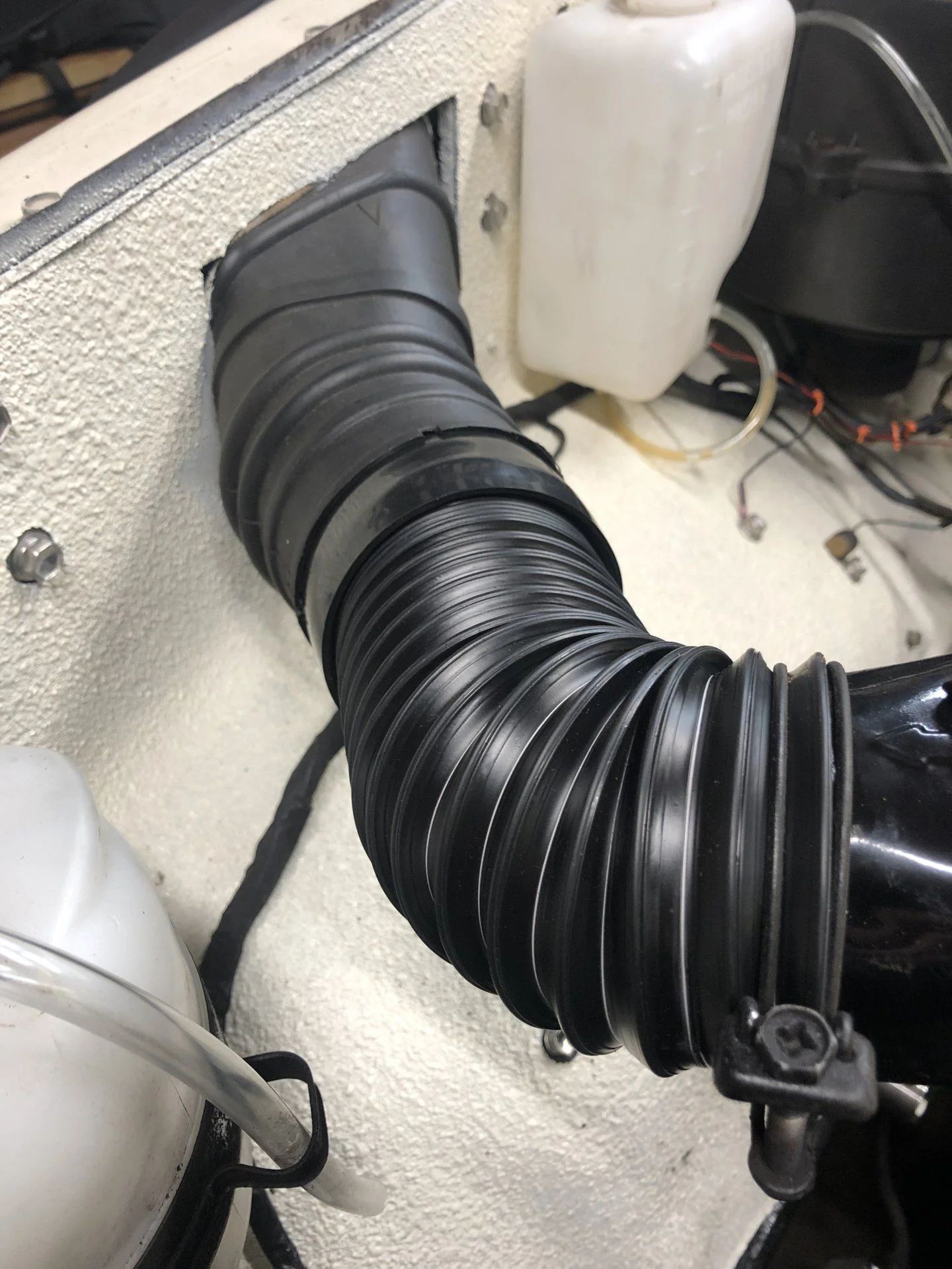

Even got the snorkel plumbed
1918948

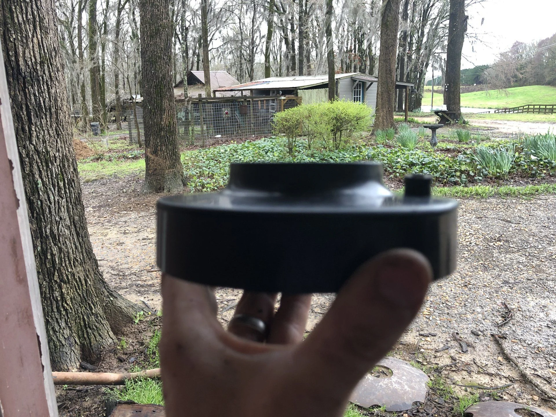

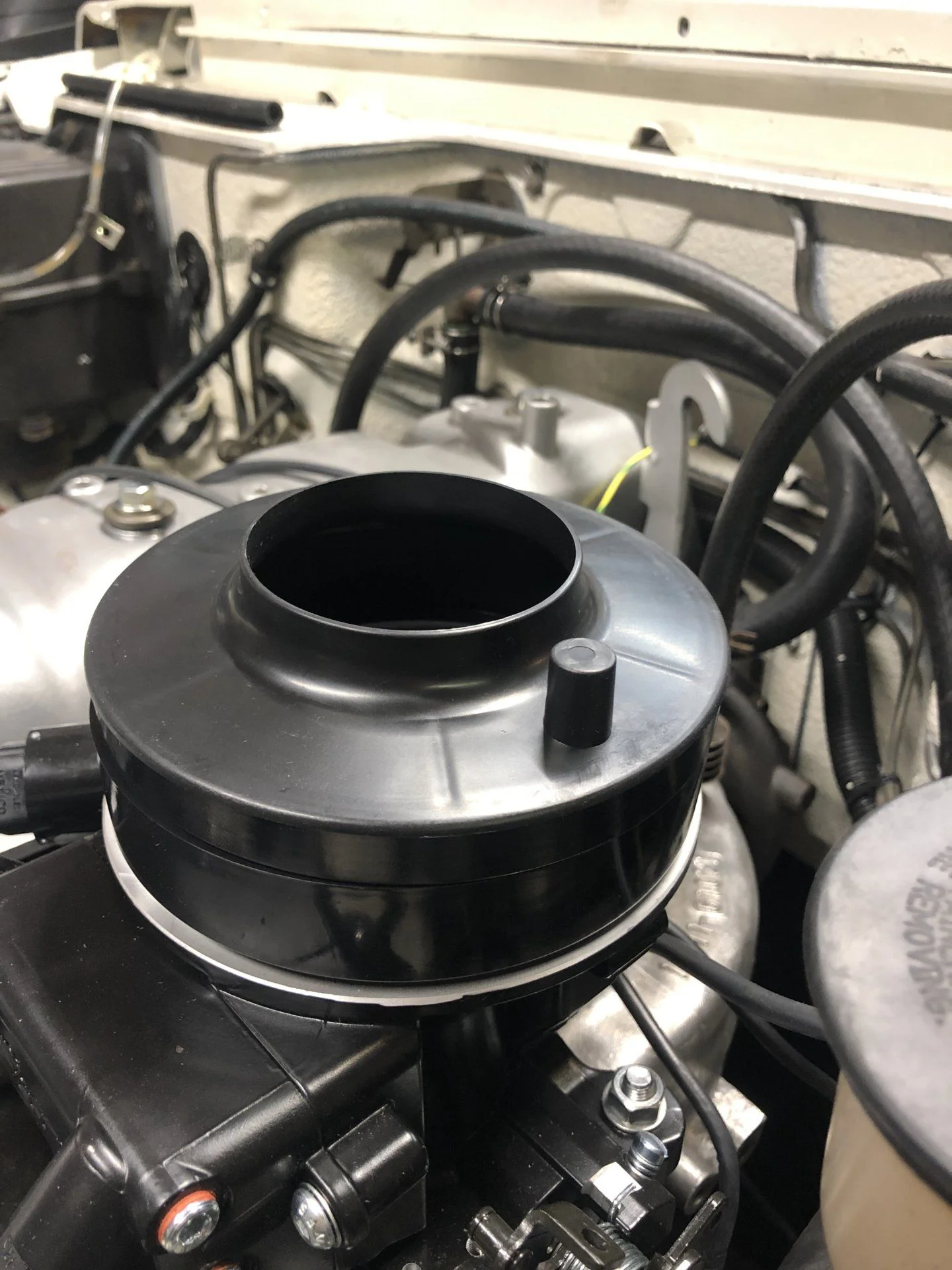

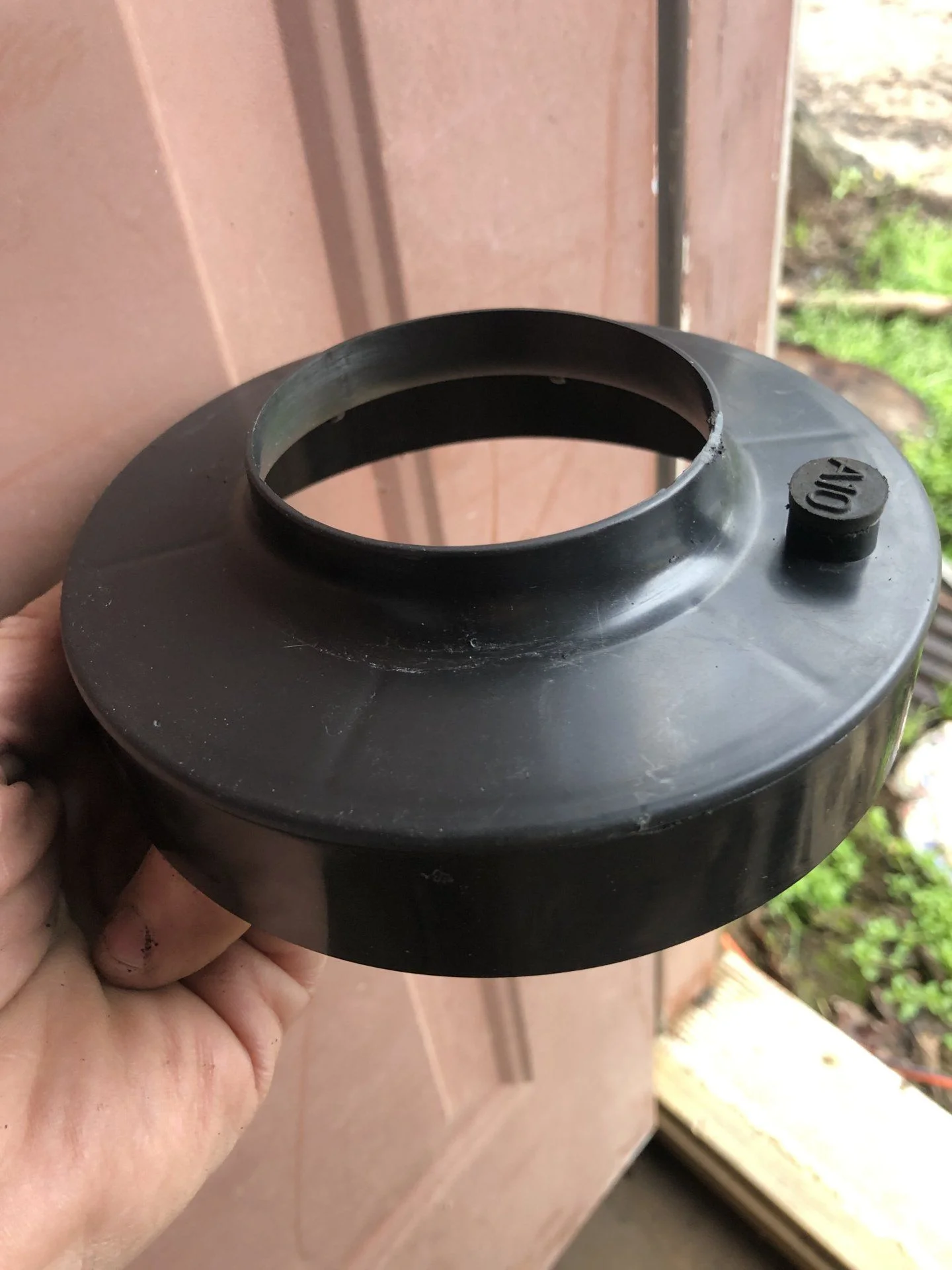

I cracked open the Mr Gasket adapter thinking that would be a 5 minute job.
Ha.
Turns out the 77 air cleaner has a smaller throat so I had to modify the smaller hat to fit. I ground down the nub and plugged it.
1918964

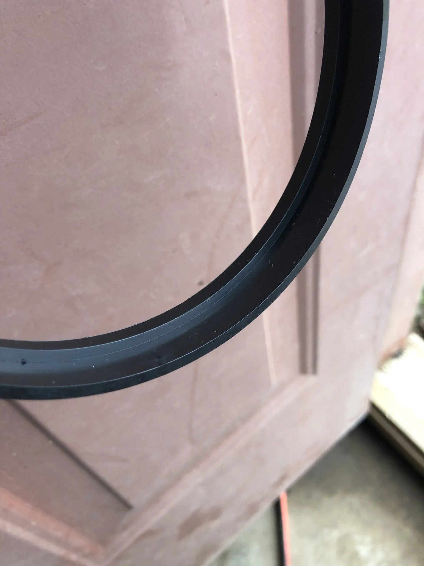

Then I tried to put the two pieces together but for some damn reason they don’t fit flush.
I had to grind out the shoulder so these two would fit flush.
1918963
1918967
I think I blew an hour or more on this.
In the end I melded them together with silicon on the inside.
1918965
1918966

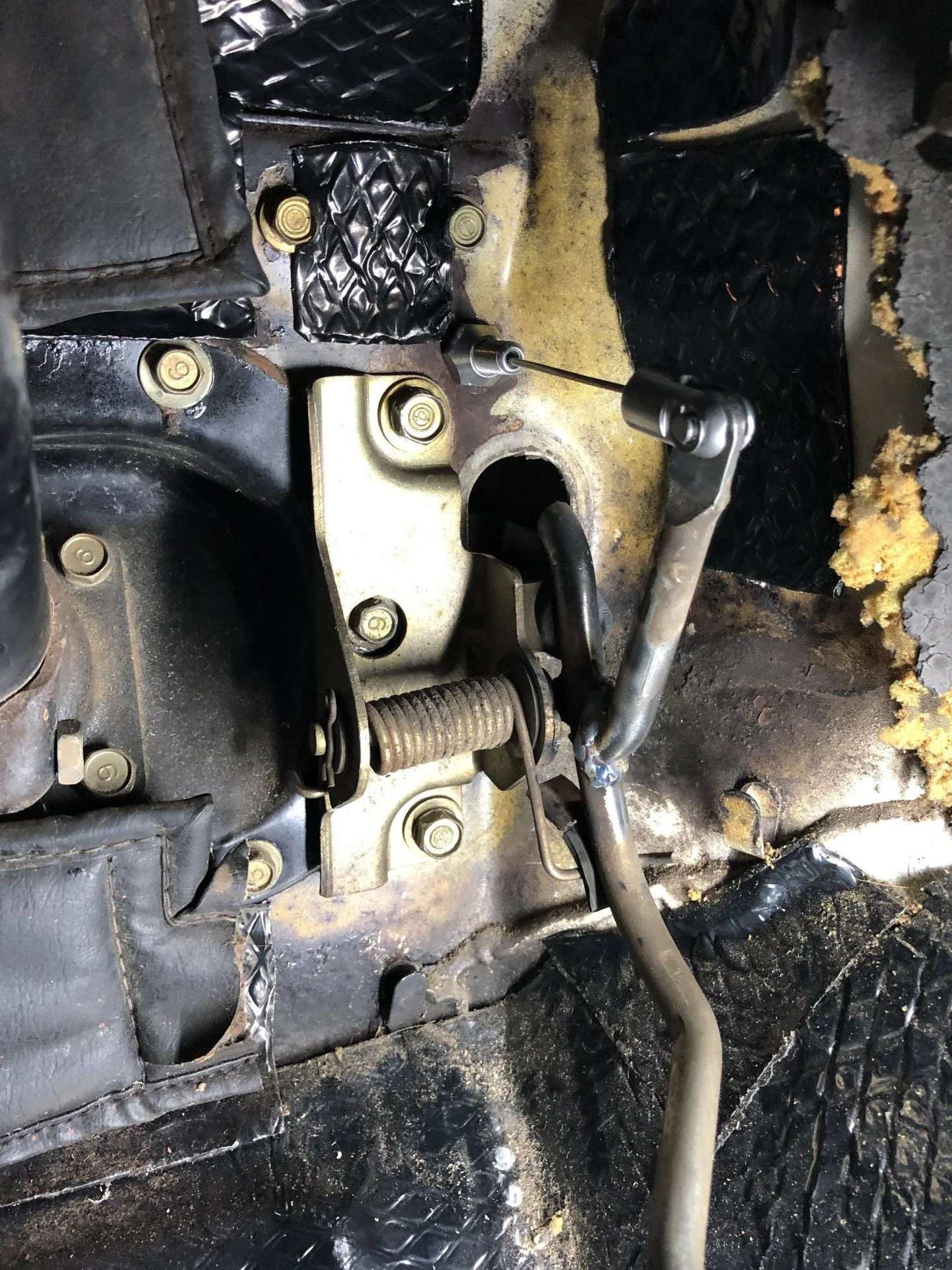

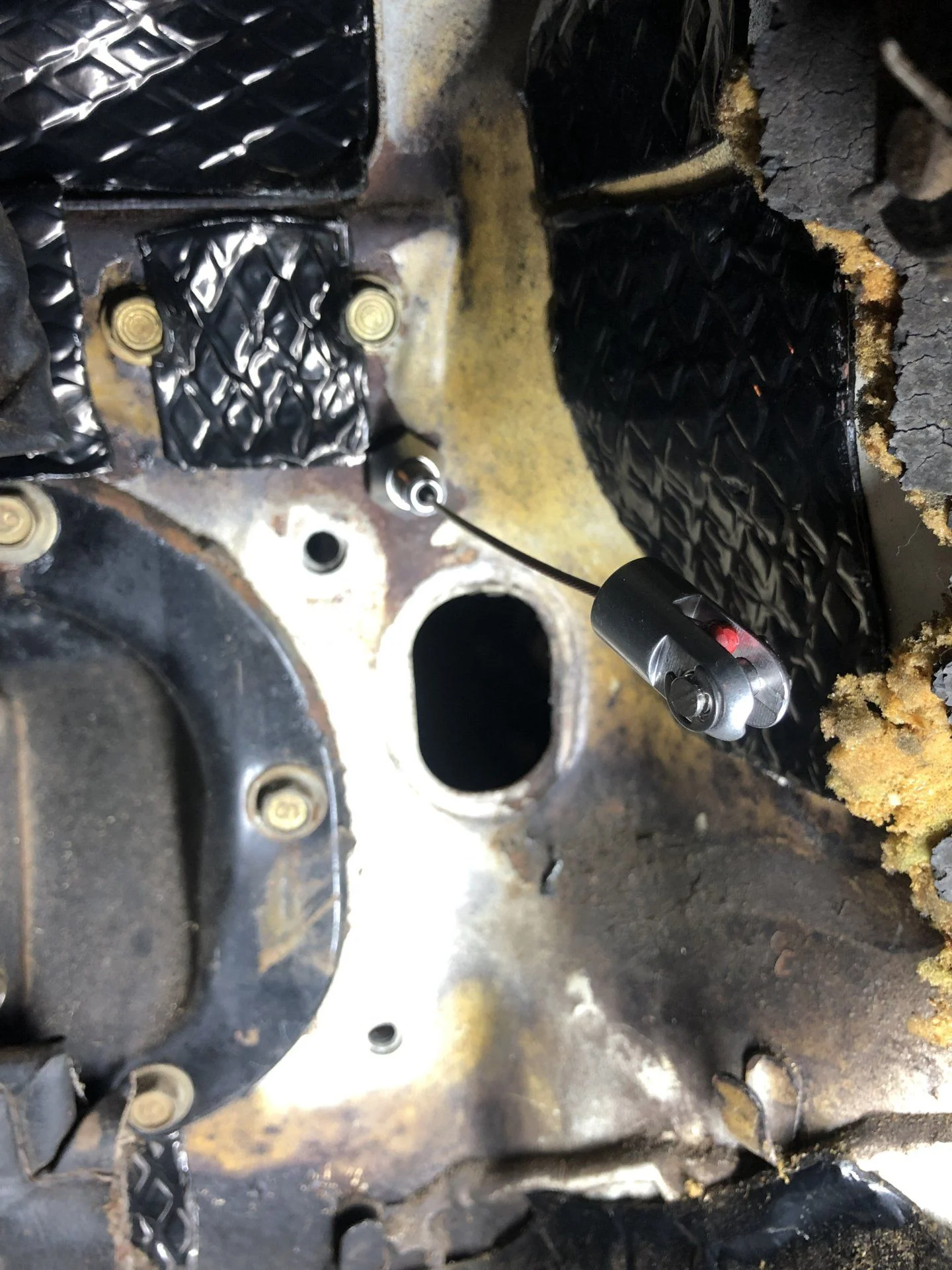

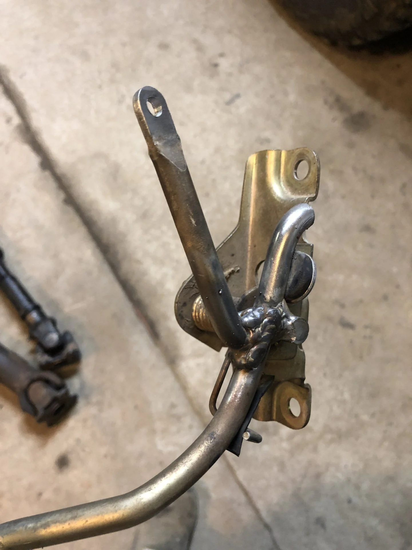

Setting up the Lokar throttle cable and the Lokar bracket.
@under_psi came out and helped me wrap my hands around the mechanics and make a plan

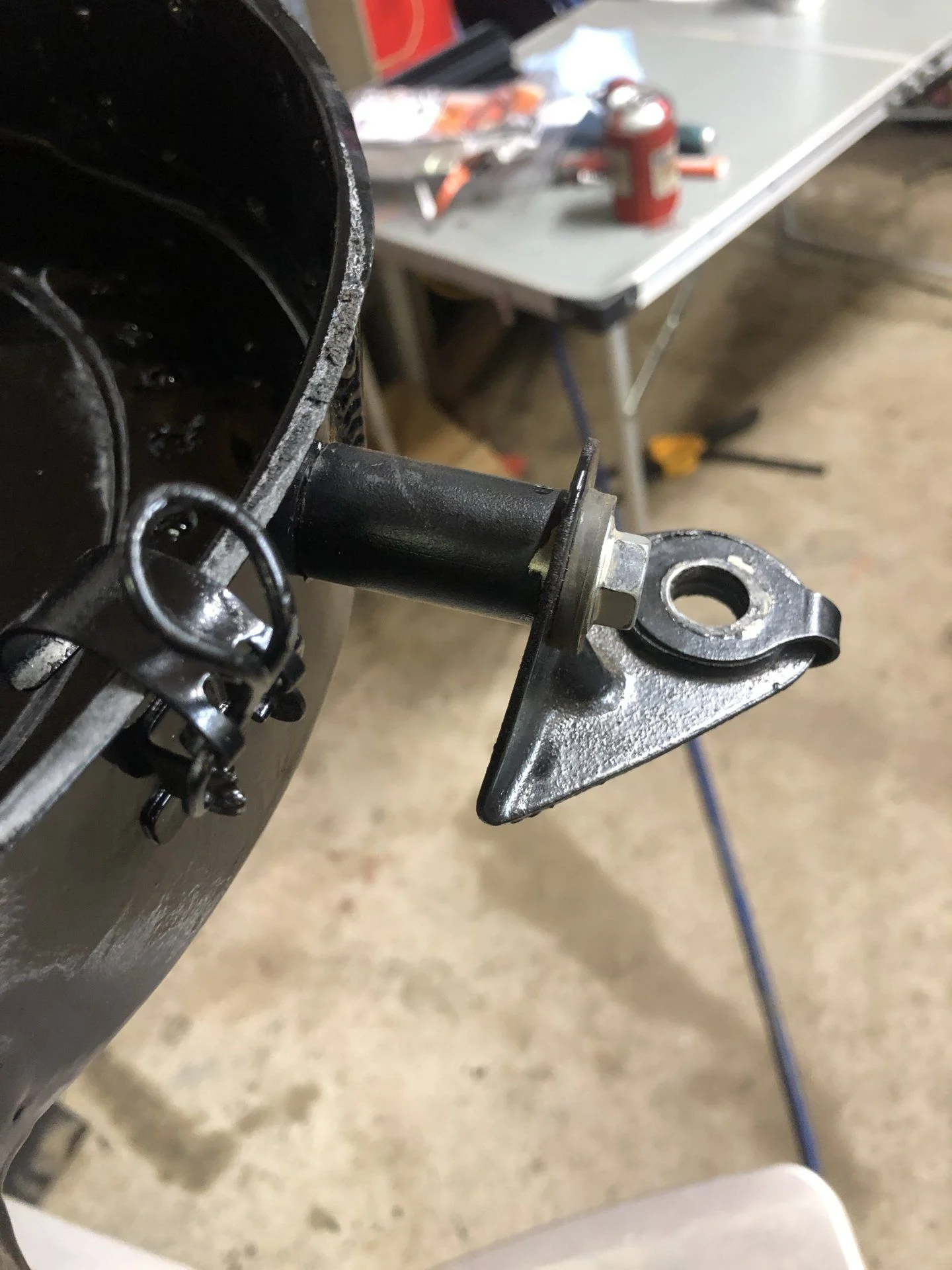

We drilled a hole at about 11:00 on the stock hole to have a nice flat spot to mount the cable to.
1918969
Then we chopped the pedal arm off where it curves into the firewall. After that we drilled out the throttle linkage stud then took the piece we cut off and welded it to the pedal.
1918970
1918971
I plugged the hole in the OEM accordion bushing And reinstalled that.
Done. Done for the day. Lots of progress but slow.....

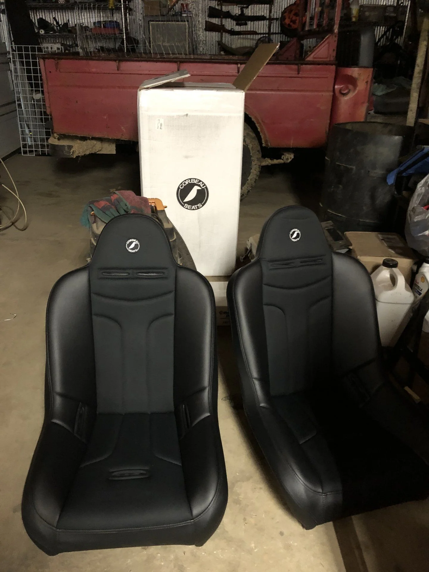

I got home, cracked open my seats.

Added my bumper back on. Holding off on the winch so it’s not in the way.
1920513

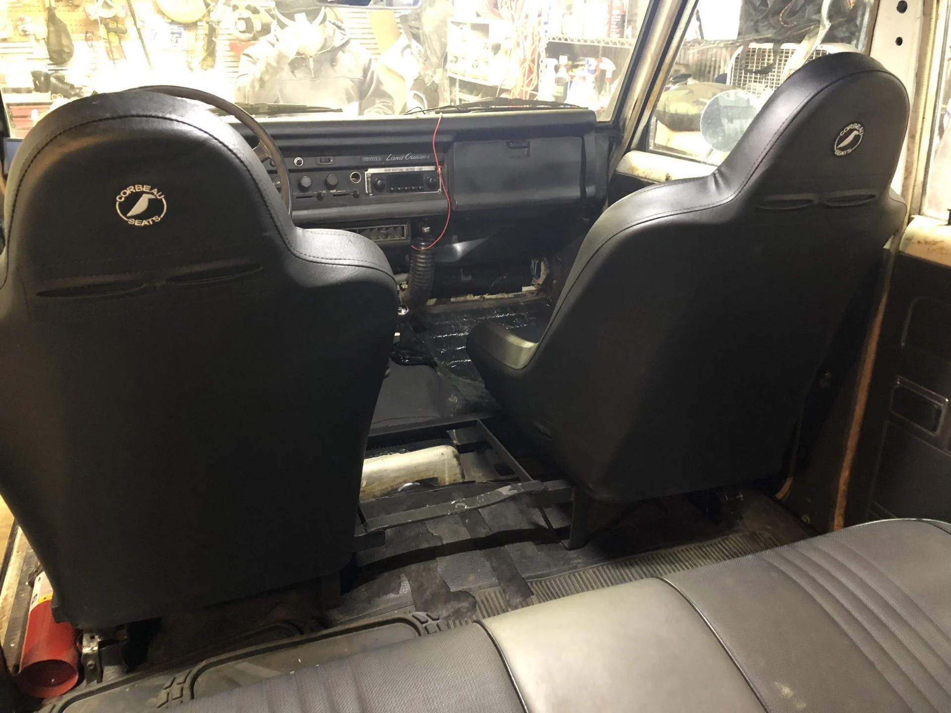

Big day for the 4.4 project!
First.

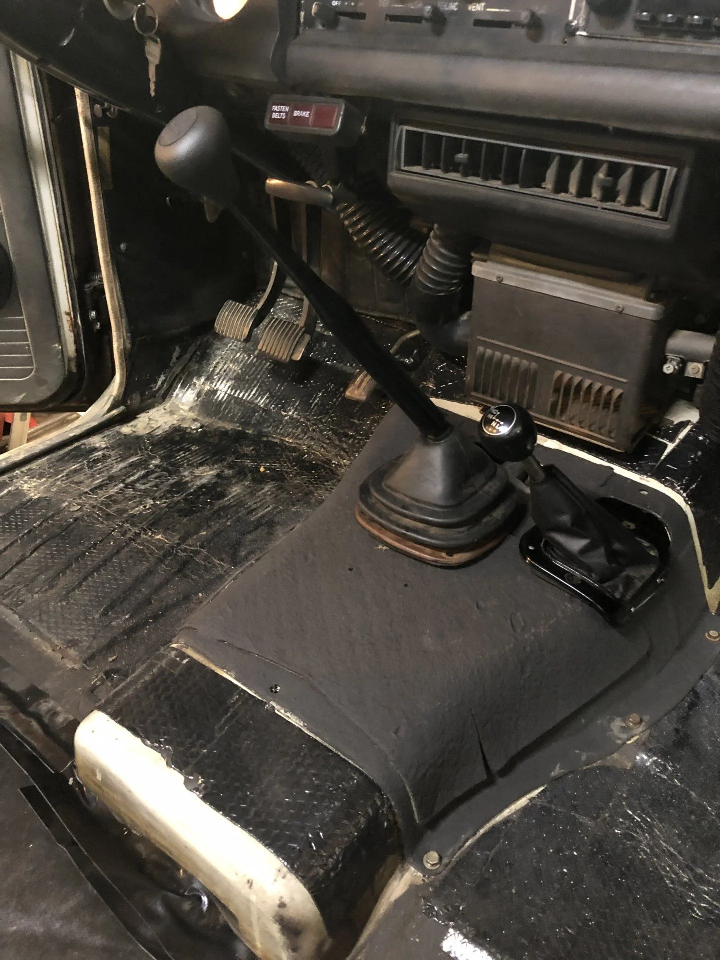

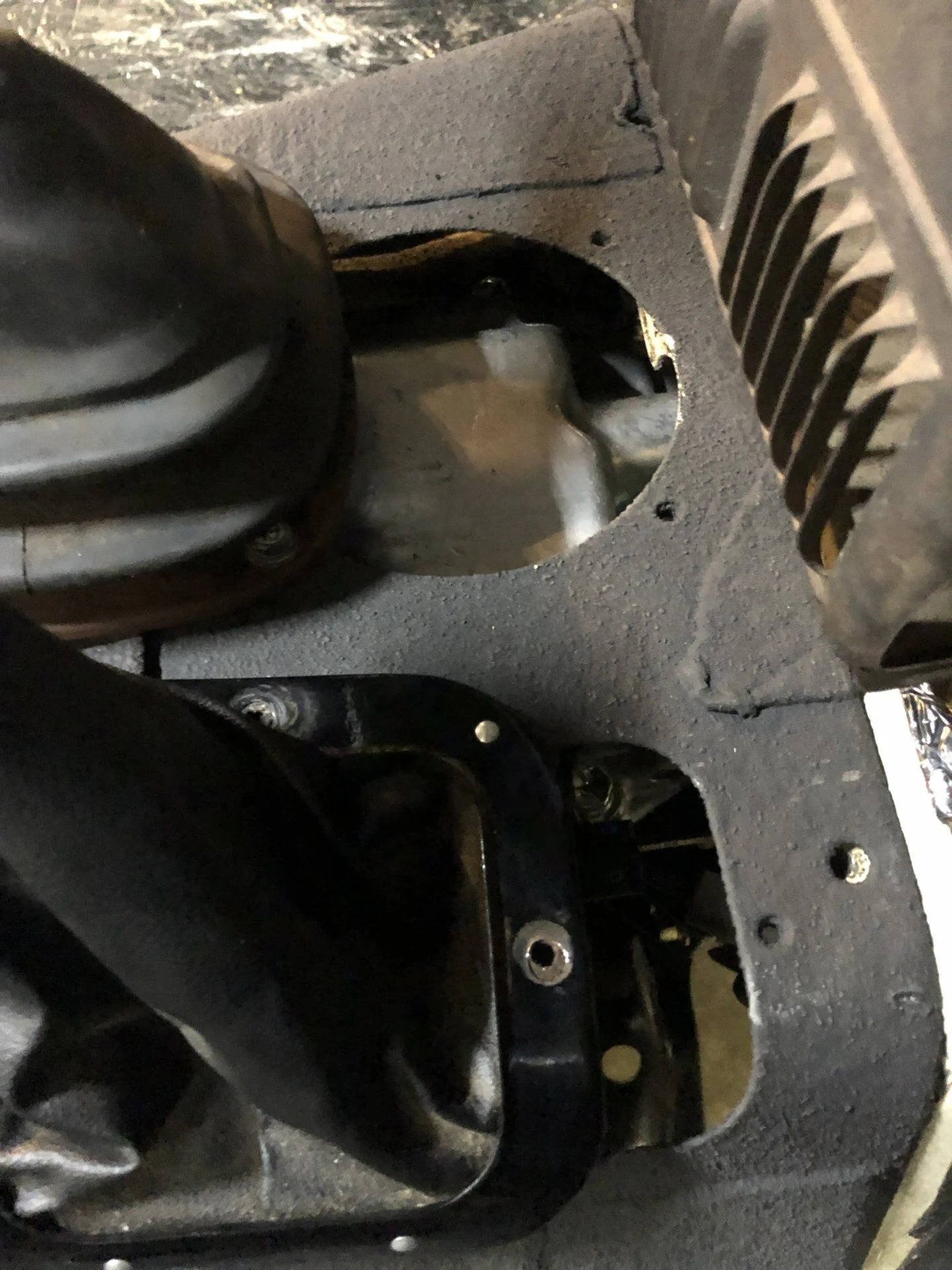

I got the shifters set and in the truck. I’ll be adding some sheet metal where I hacked the bump later.
Next up, I got the seat bracket installed and the Corbeau seats installed.
They are super comfy but I got the suspension seats instead of the “Jeep” style I thought I was ordering. These seats are tall on the sides so you have to get up and over the sides.
I’ll get used to them. Not worth the money I would have to spend to return them to fix it.
All good. I’ll order a console for it tonight.
