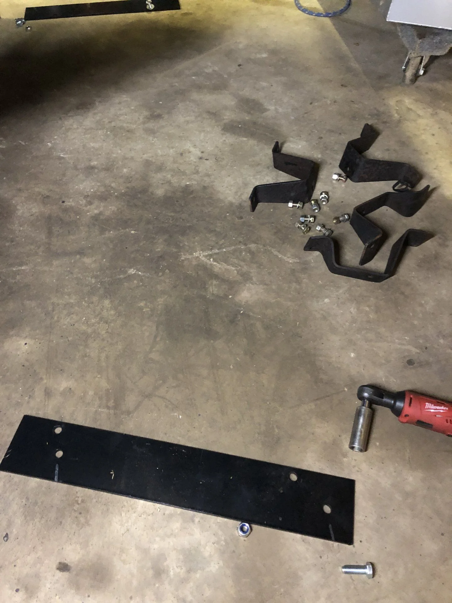

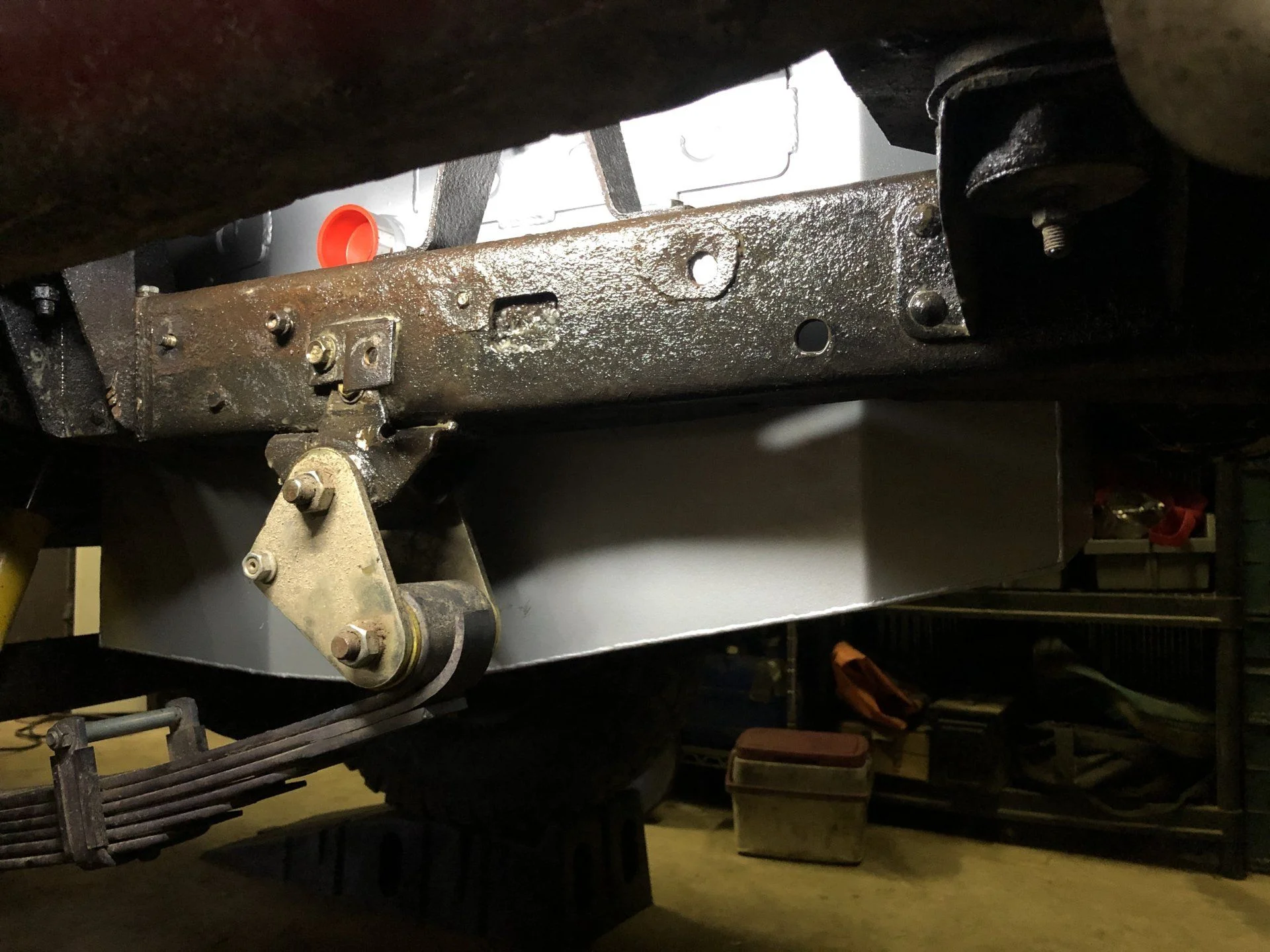

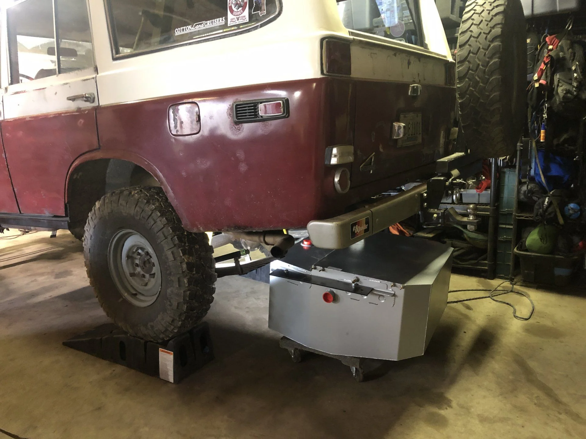

I laid out the parts. Installed the side pieces and hose fitttings.
Realized that on a 4 step process I should have listened and had to remove the bungs.
I then took all that crap off and reinstalled the tank towers on the frame.

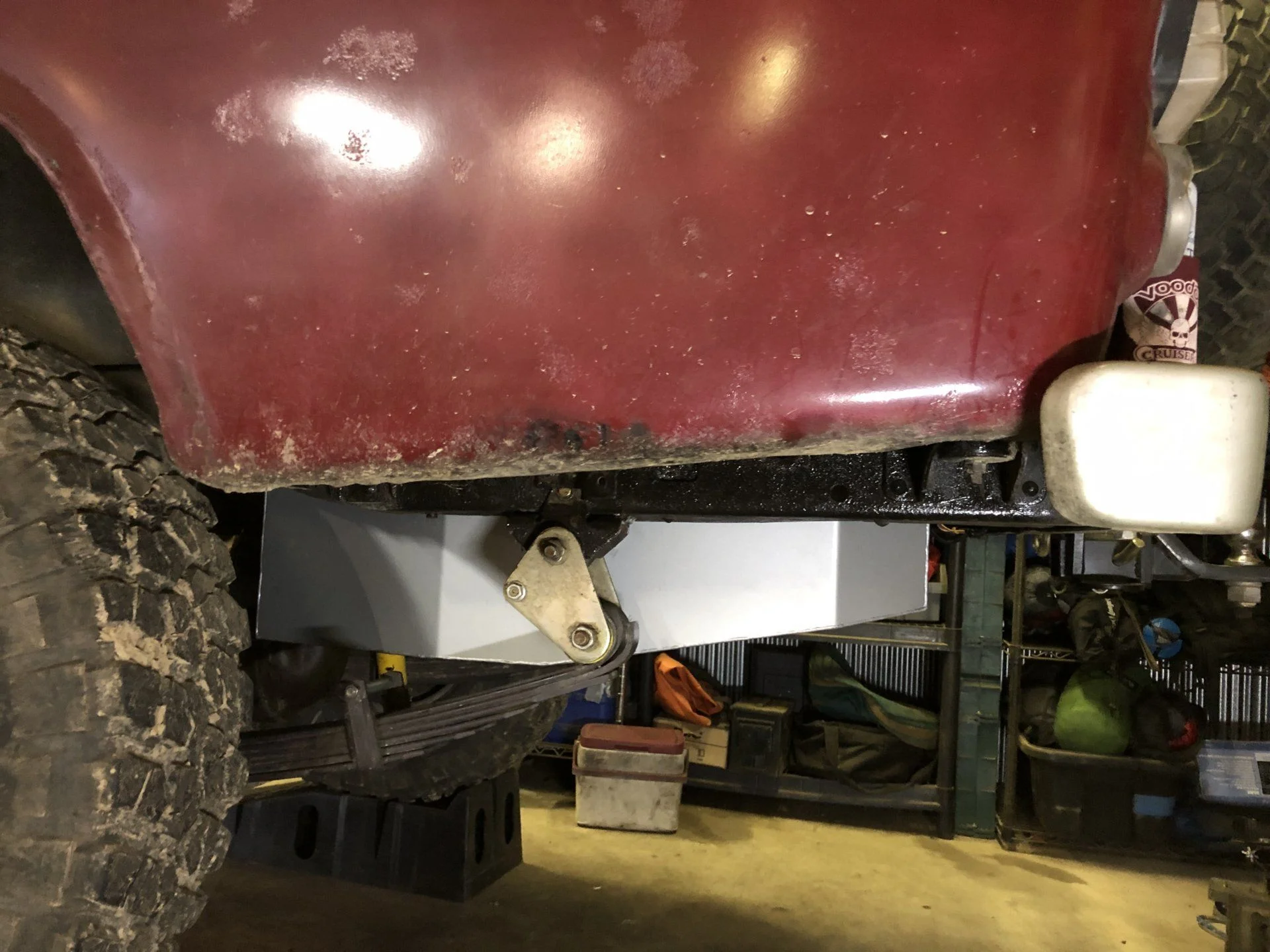

I used a tranny jack to lift it into place.

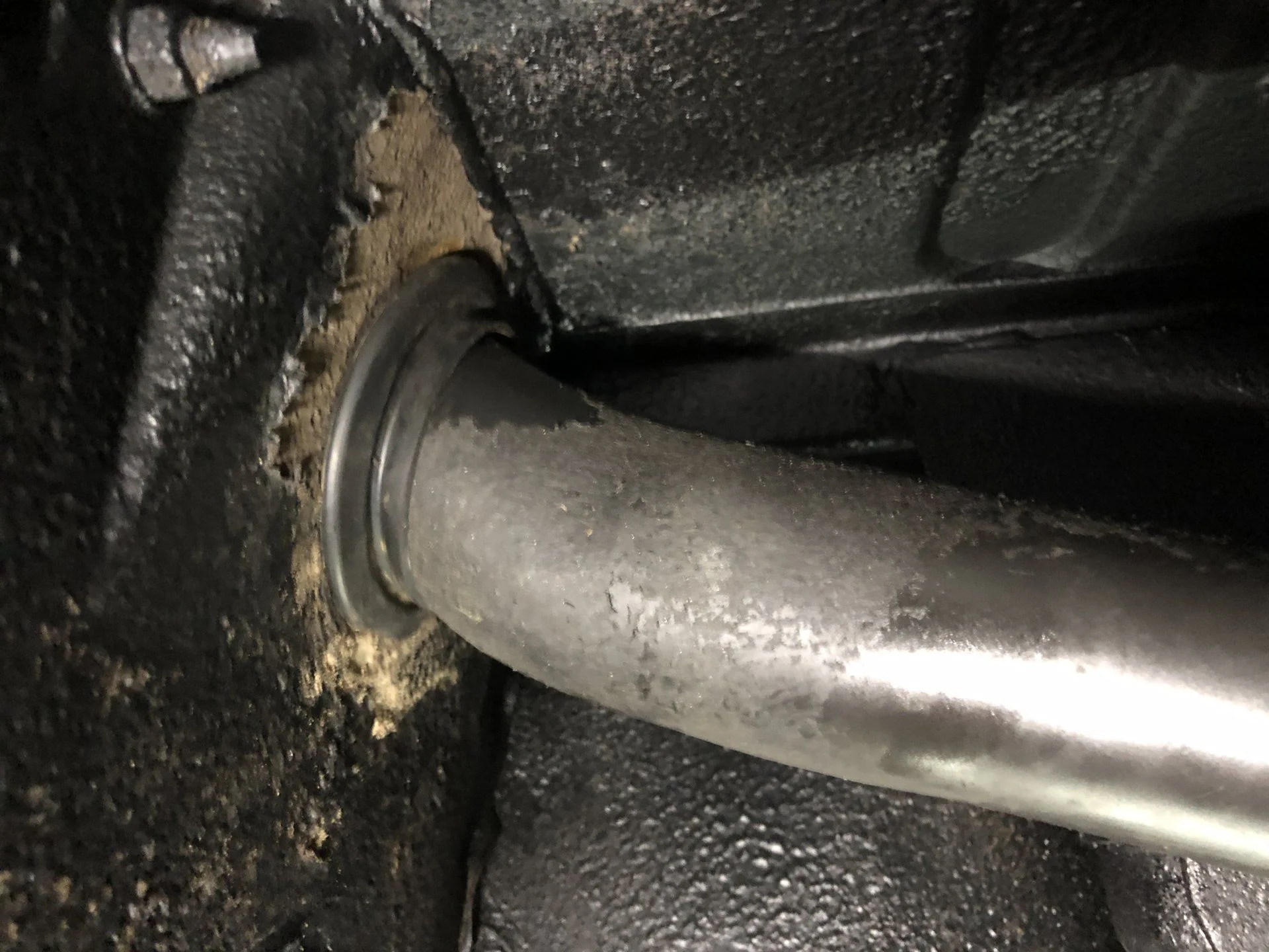

If you want a LRA tank in your Pig the stock exhaust location won’t work
Sawzall cures all.
I had one of the LRA brackets on backwards and my passenger side bolts would not line up. I had the drivers side started so I chose to take the bracket off with the tank up there. Wow. Awful but I got it.
The fill hose on my 77 is too short so I’ve got to find something at the auto house tomorrow to get it plumbed
Another bummer is that I installed my rear shackles with the grease zerks to the inside because the exhaust was in the way to grease them.
Now the tank is in the way and with it up on the ramps I could not dissect them and install them correctly. I guess I’ll tackle that job when I kill the bushings.

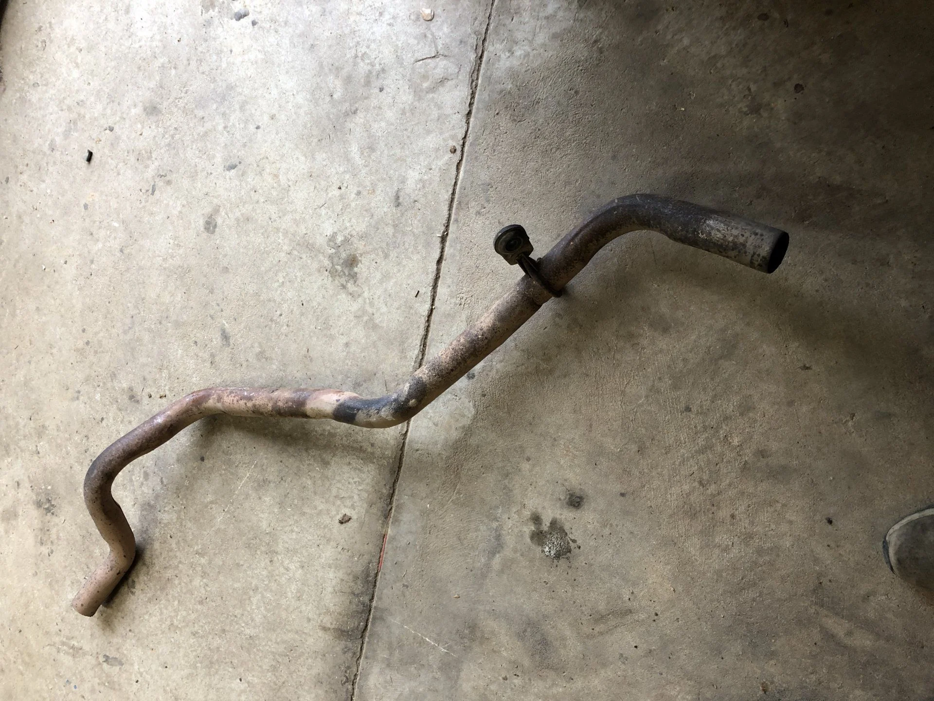

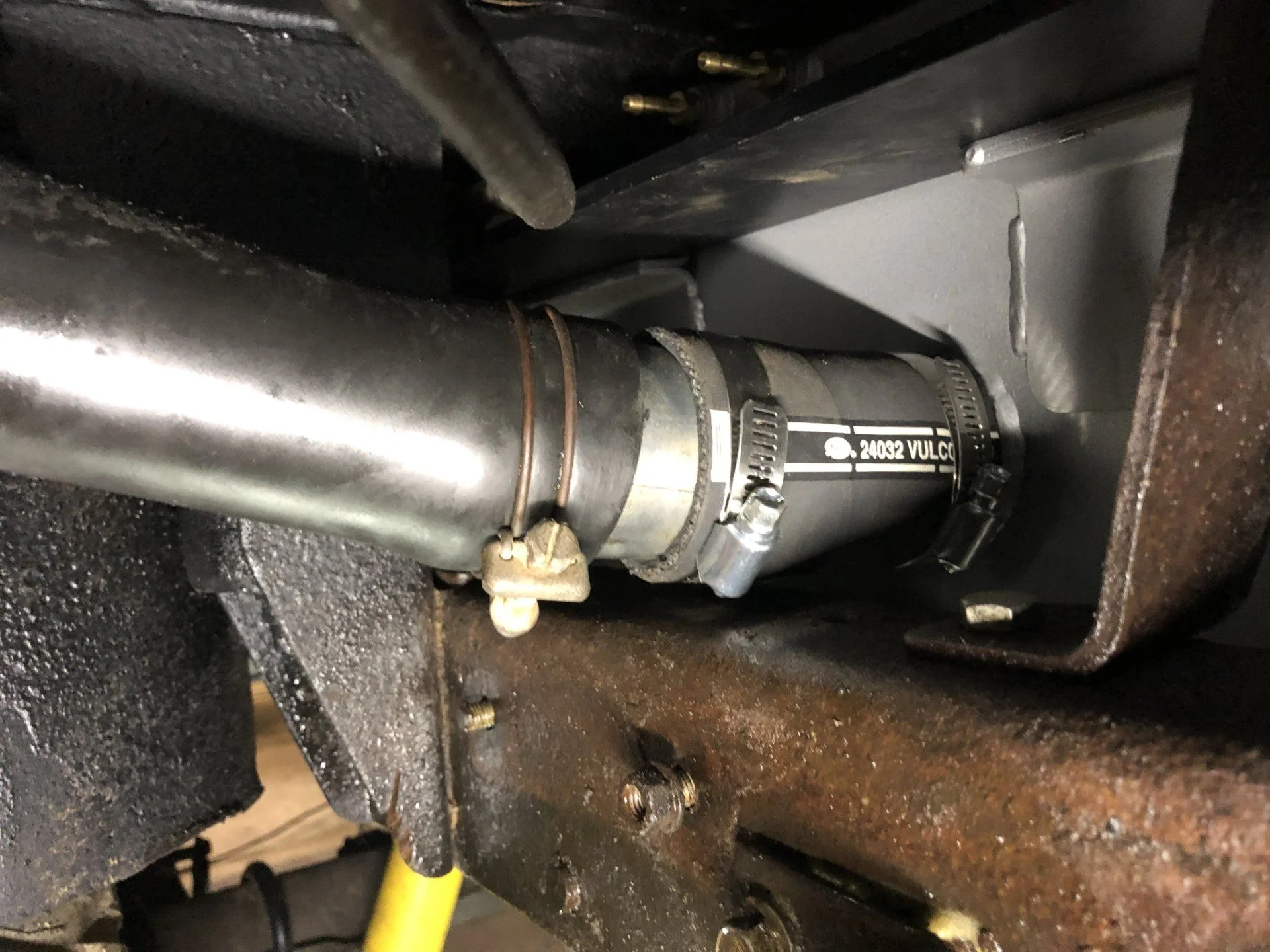

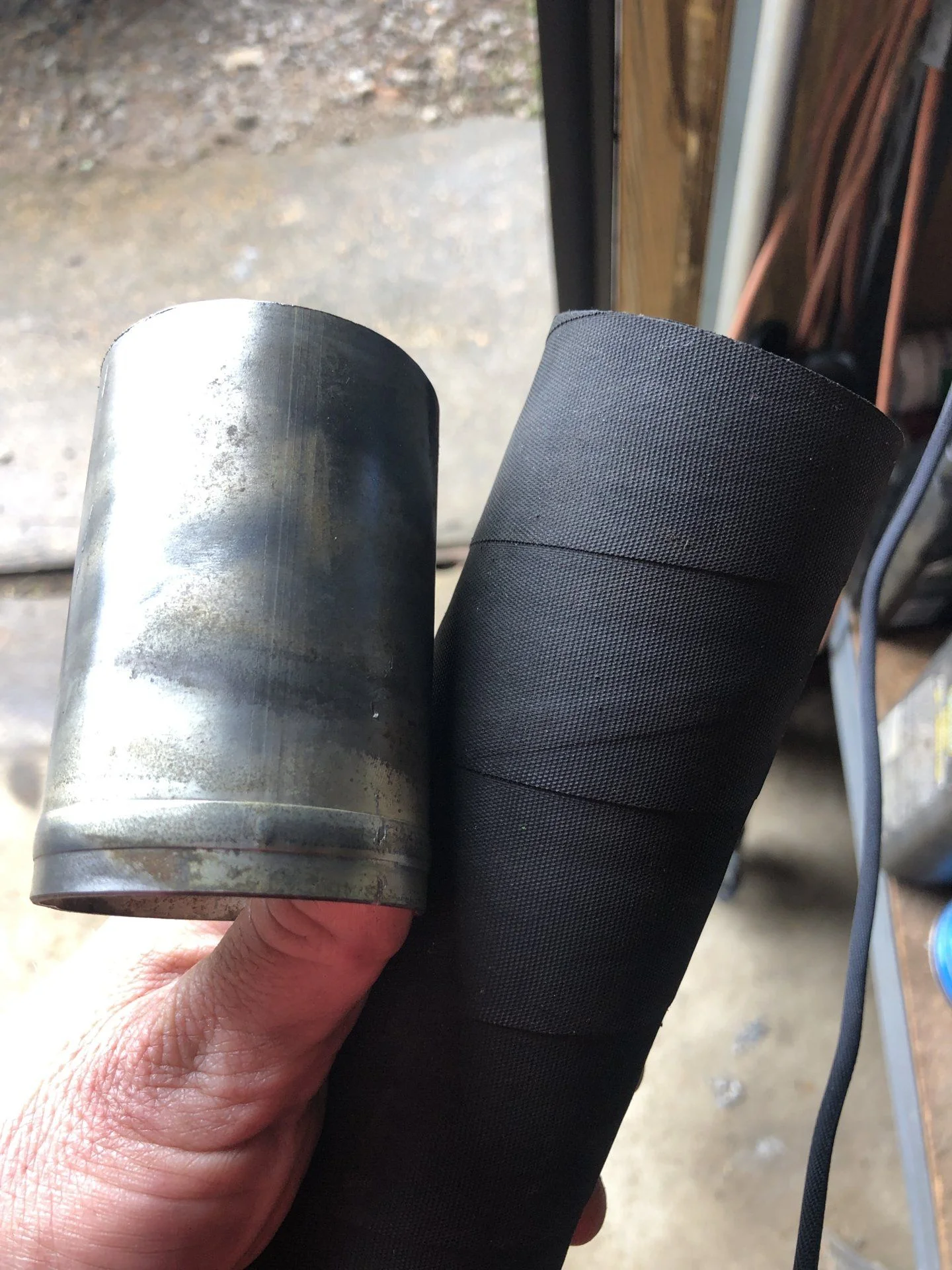

My fill tube was not long enough and finding that part was going to suck.
I did find some 2” fuel line and grabbed a filler neck off the parts pig and made a Union
Also the gaskets on the parts pig were better. It’s all in and sealed up.

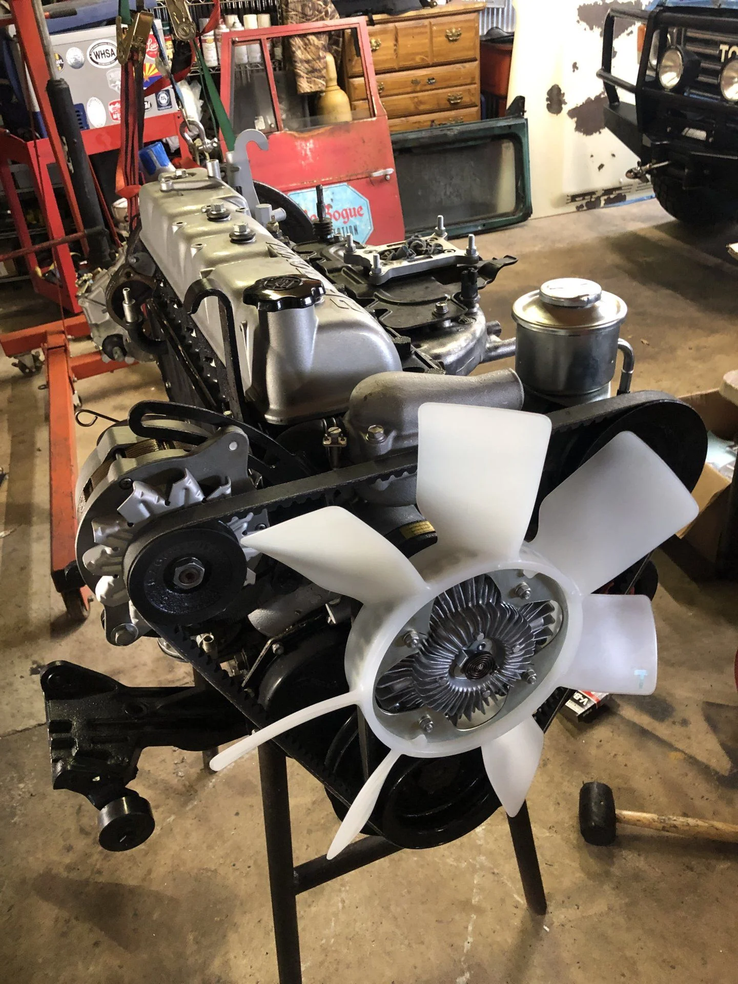

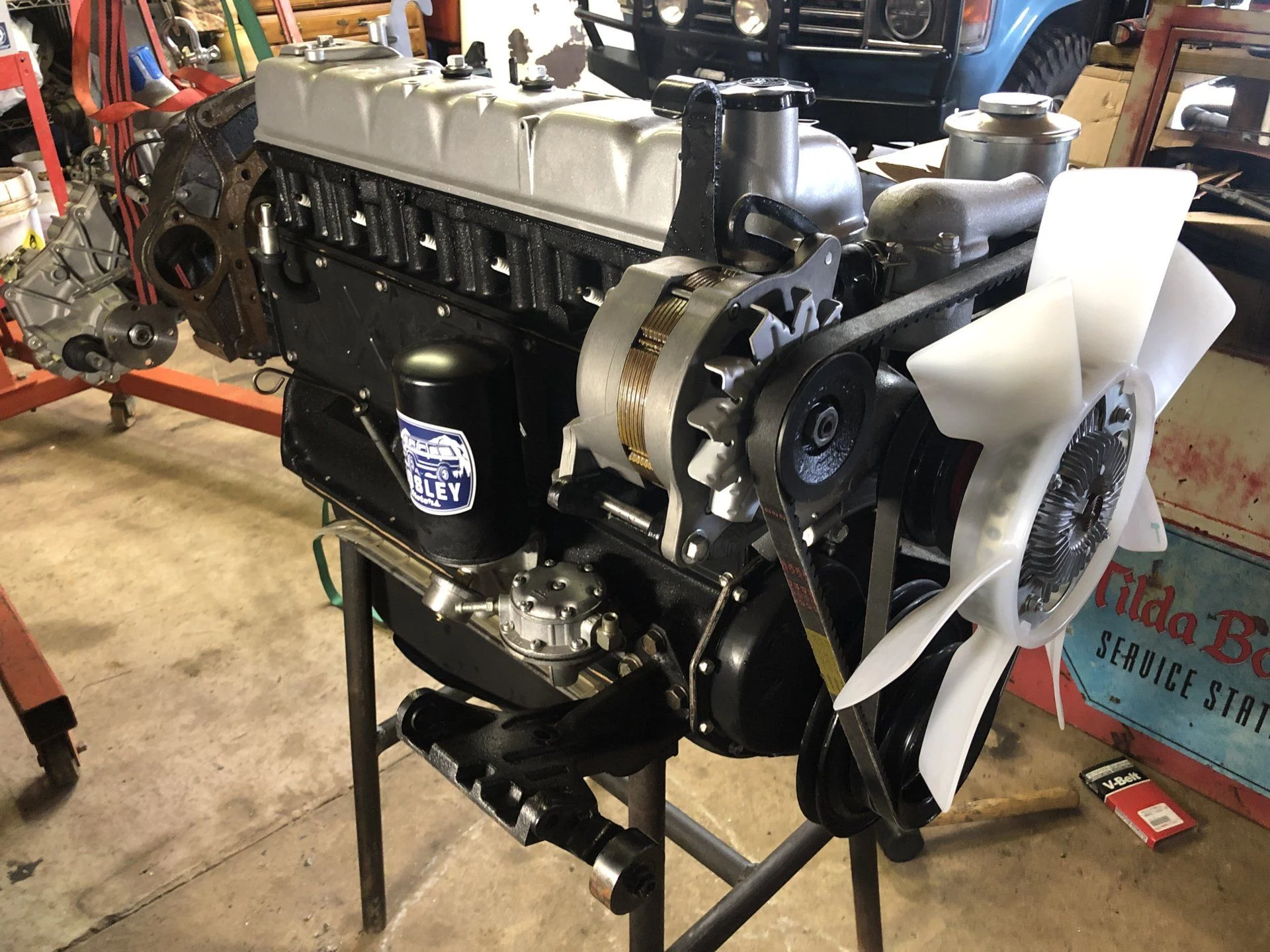

Now that that damn fuel tank is behind me it’s back to the motor.
I pulled the 60 into the shop so I could make sure I was doing it right and finished up mounting all the accessories on the motor.

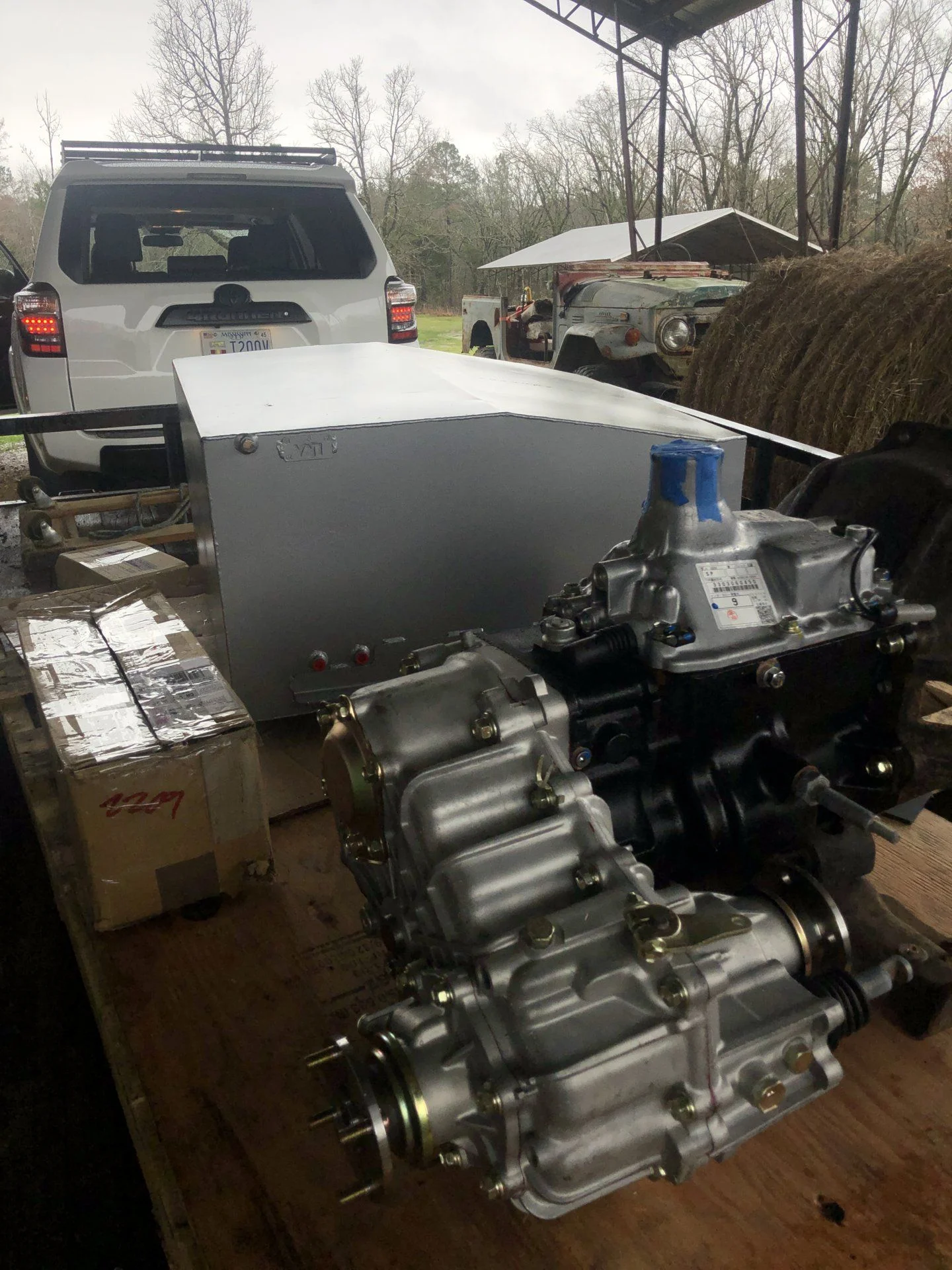

Next up. Bellhousing. Clutch. Stab transmission.
Clutch Flywheel Pressure plate torqued to 15#
Realized I don’t have a clutch fork. @USMC22 is going to bring me one tomorrow.

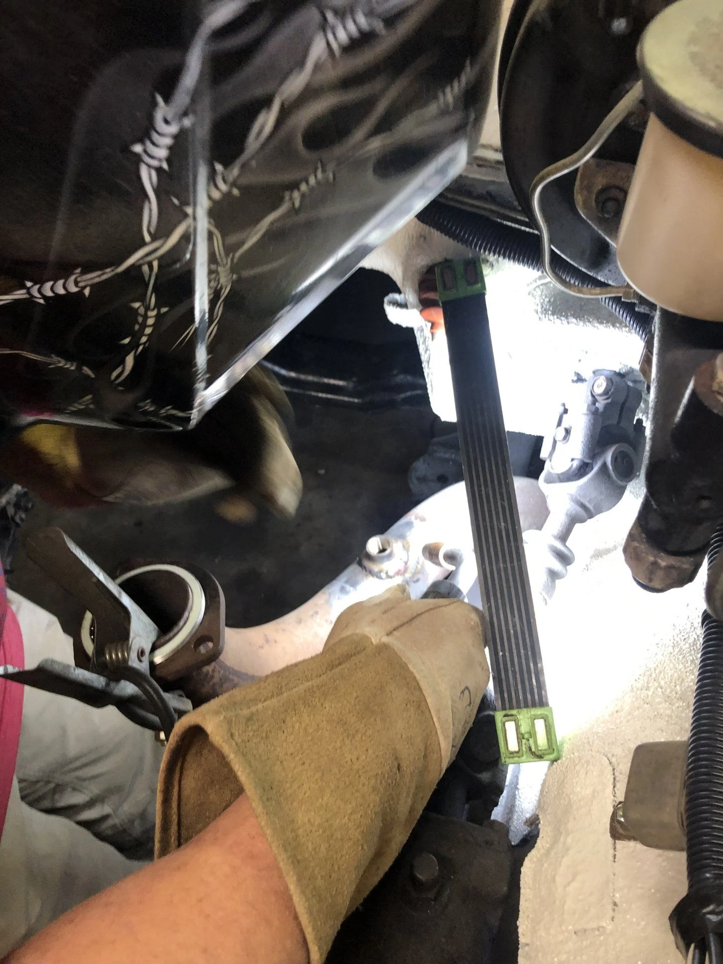

We got started pretty early on this. @USMC22 and I stabbed the drivetrain while @under_psi got the stuff ready to weld
The welding started with the O2 sensor on the stock Pig downpipe.
I passed on the clamp-on that came with the Holley Sniper and chose a small bung via Amazon

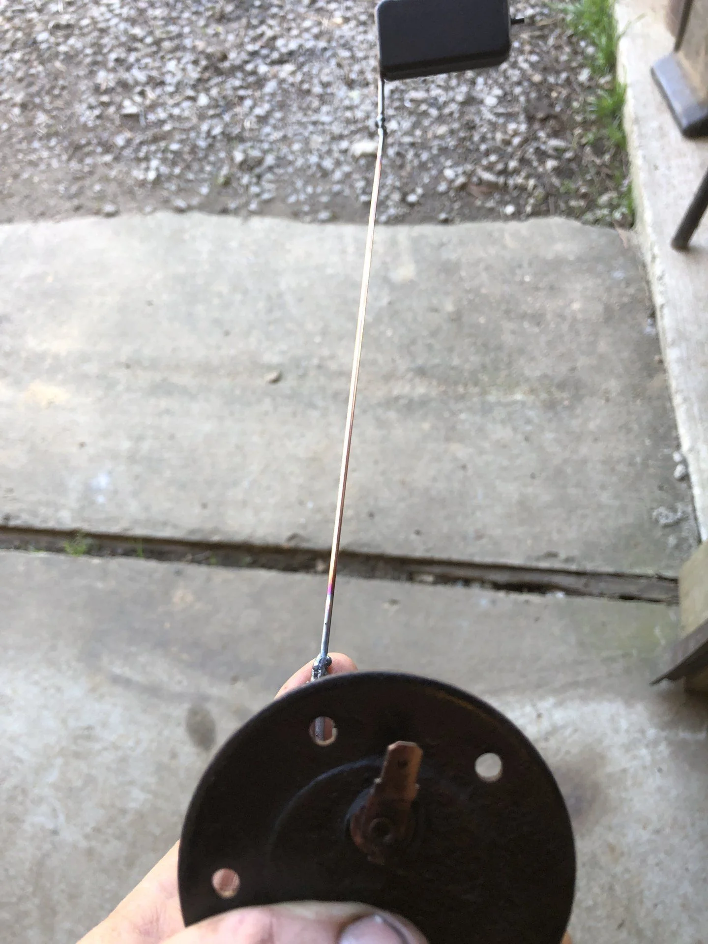

Last Lou welded the extension rod in for the stock sending unit to work with the deep LRA tank
