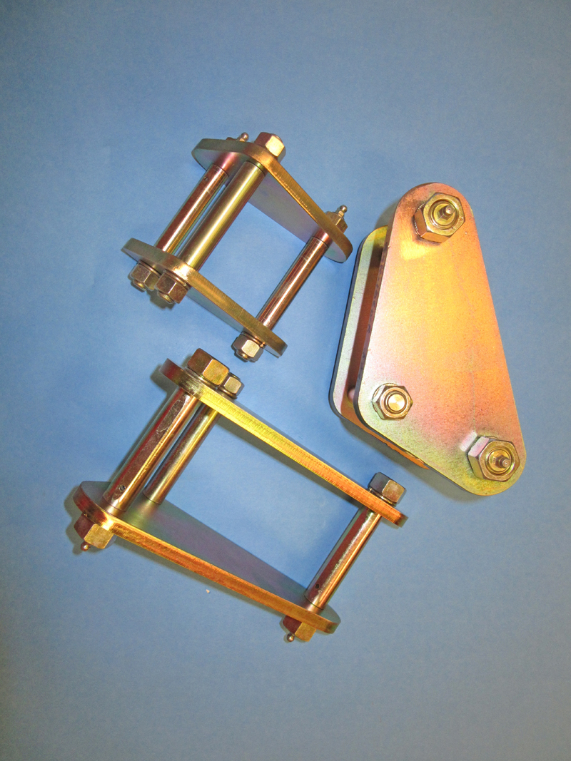

I like the shackles you made. They look like the ones offered by Ruff Stuff.
They’ll work just fine
Holy hell they are cheap too. I just ordered some 5” ones from them to see if that keeps them off the frame

The monster Man A Fre rear shackles put the rear back up where it was before all this started and a better angle for when it squats with 52 gallons. Sitting with about 20 now. I did not install shims. Hopefully it won’t put my staft out of whack.
Take a look at the shackle I had to remove. These were installed before the monster fuel cell. That was fun.....
This thing is ghastly(er) now.
What part # from MAN - FRE ? and dimensions, including thickness! 😉👍
