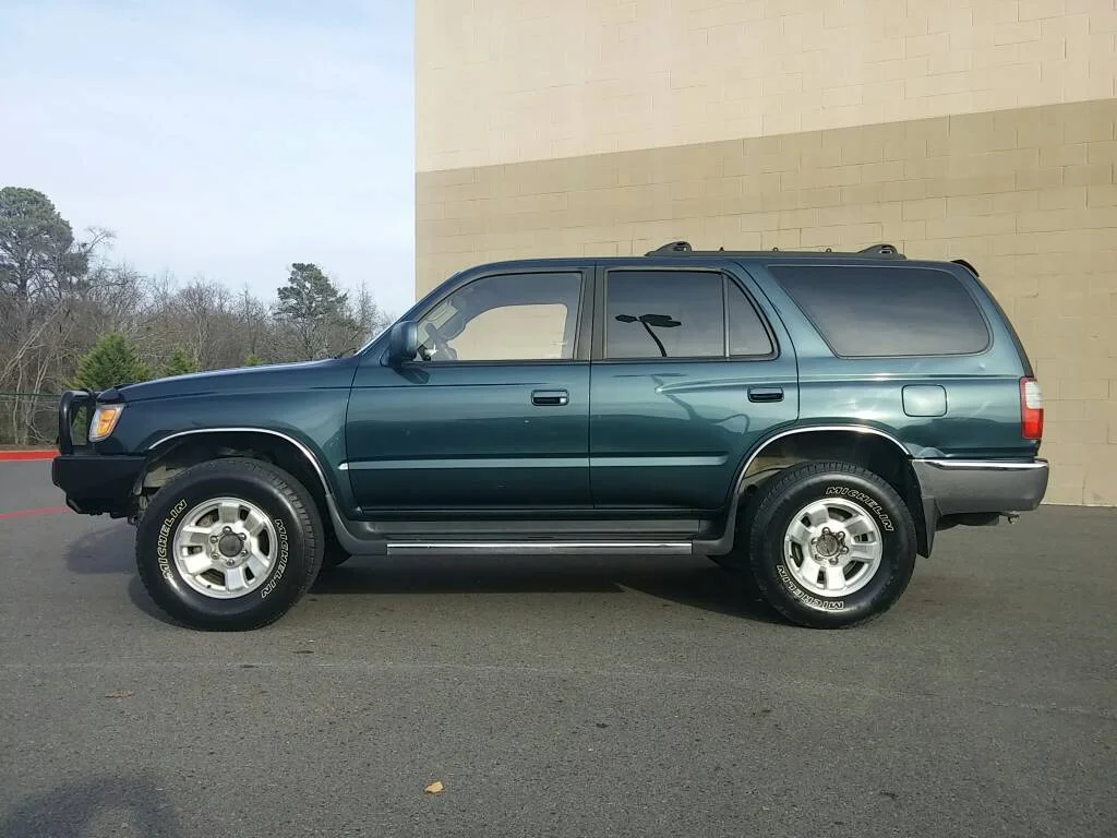

So I'm doing a refresh job on my 96 that has been a workhorse for my family.
Last week it just got a new timing belt, water pump, plugs and wires, and antenna.
I just came back from Sam's and she now is riding on some new 285/75r16 Goodyear Duratracs. They look and drive awesome but are rubbing in the tight turns.

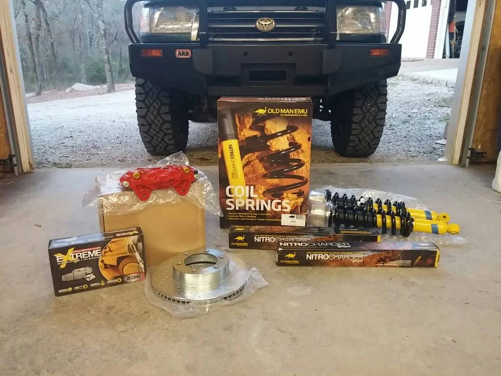

Yesterday my favorite UPS guy dropped off a whole new OME 3" suspension and assorted bushings from Wheelers and an entire set-up of Tundra Brakes (new calipers, rotors, and pads) from Rock Auto.
Tomorrow is shop day. By tomorrow afternoon it will no longer rub fenders and will stop like it is supposed to..... And be a little taller....

Here are some pics.... Before new tires and after. And all the goodies to be added tomorrow.

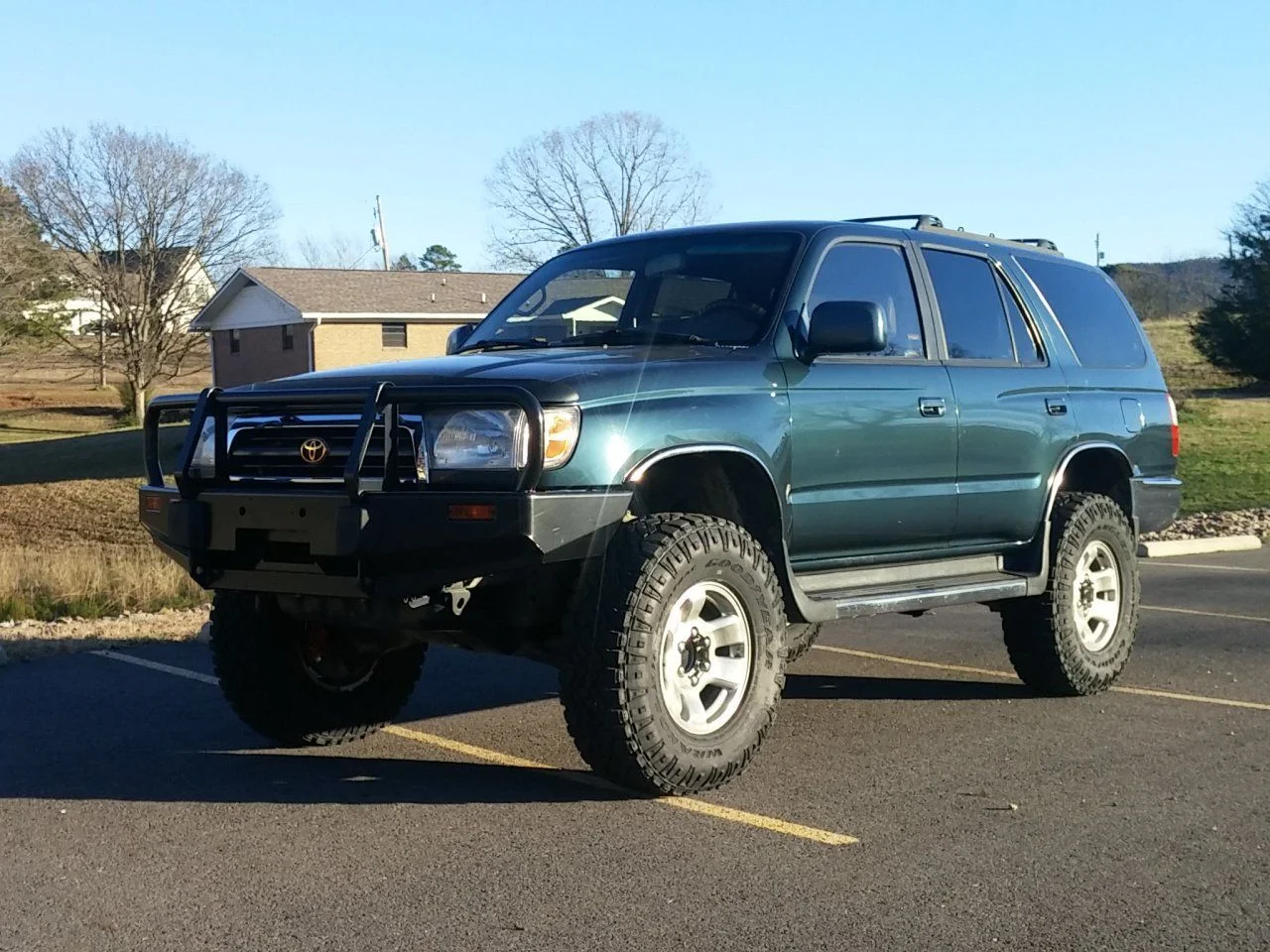

Well... Let me help you out a little.
Here is the finished product.... Well almost finished....

- 3" OME Heavy Lift ( springs, shocks, rear brake line, and coil spacers)
- Tundra Truck Brake upgrade (Powerstop 137L Calipers, drilled and slotted rotors, and Extreme ceramic/carbon fiber pads)

Had a little difficulty getting the brakes bled after installing new calipers and brake line but once I figured out the problem......damn! This thing STOPS now like it is supposed to. What a difference just the brakes made.
The 1/4" wheel spacers allowed the 3 spoke split wheels to mount over the 231mm calipers. I have about a 1/8" clearance now and the factory lug nuts fit back on perfectly with plenty of thread bite.
It drives and rides now like a new vehicle.
Going for an alignment in the morning.
