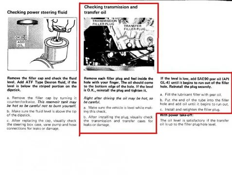

oh crap. I haven't done that yet. Is there a write up on how to change them out?? The shop manual I have is vague. I guess it's too easy to bother writing up exactly how to do it. I never have though. dumb newbs.
You probably have a dead rat getting cooked.
OK. I'll try to make up for my previous rude/unhelpful comment.
Here are the fill/level plugs:
And you should find the drain plugs easy enough to find because they're right on the bottom of each gearbox.
80w/90 EP gear oil.
:cheers:

changed the oil in the diffs (brown and watery), changed the oil in the tranny (brown and very viscous), and changed the oil in the T-case (brown and not much of it).... thanks Lostmarbles for the diagram.... Now I need to do a long test drive on a hot day to see it that fixed the odors. I haven't checked the heater core or the vent by the hood yet. Maybe there's a surprise waitng for me yet. If there is, I'll be sure post the carnage.... Thanks again Lostmarbles.
