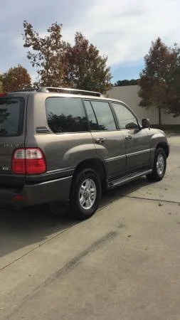

I bought this LX in the Spring of 2016 with the idea of having a vehicle that could be used to go camping, pull a boat, carry a family of 5, and be capable of some mild trail riding.
It spent its entire life before I bought it as a South Texas mall cruiser. The Lexus service record and the rust free chassis confirmed it. Since I bought it I’ve baselined every fluid with the exception of brake fluid, replaced spark plugs & coils, timing belt, water pump, fan clutch, fan bracket, done several complete AHC fluid swaps (AHC still works perfectly), several mobil one oil changes, and done a host of upgrades.

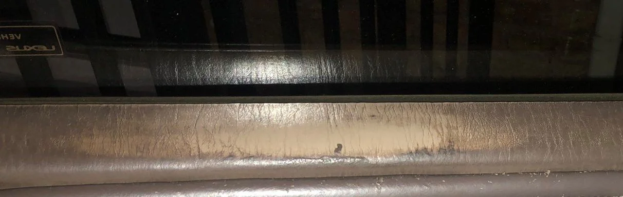

Door Trim sun fade fix:
1921018
Use SEM Color Coat 15713 Color Coat Spray:
1925715
Makes it look brand new again:

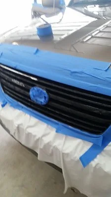

How to make quick work of stripping the paint from your front grill if you are wanting to repaint or just show the shine underneath.
1921035
at first I started with just using a scotch pad but grew impatient with my progress so i grabbed a spray can of chemical stripper
taped around the grill and put tarp underneath to protect everything else from the chemical stripper:
1921038
This of course worked like a charm I only had to spray the pro stripper on and then hosed it off and this is what it did:

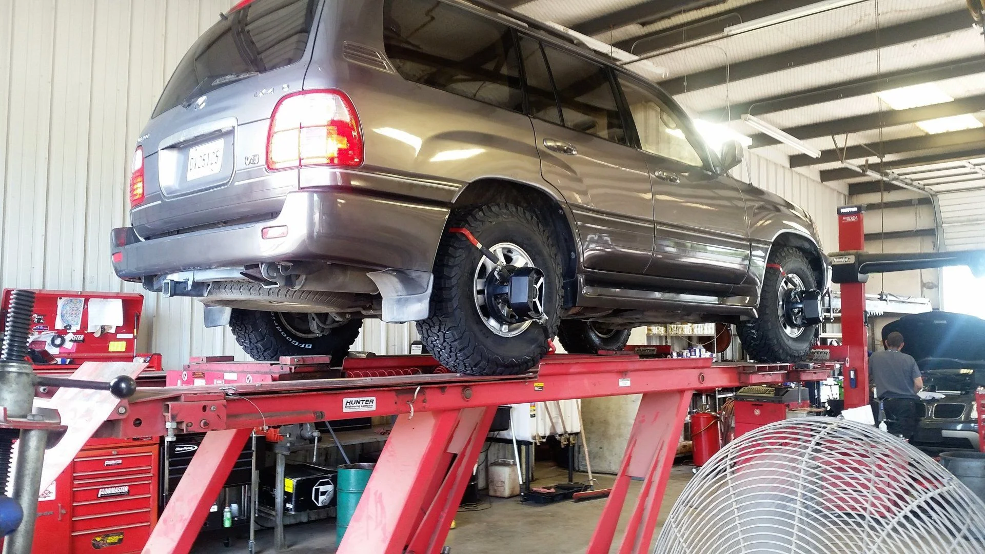

I can't really think of any one thing that does more for a 100 series than a pair of new shoes.

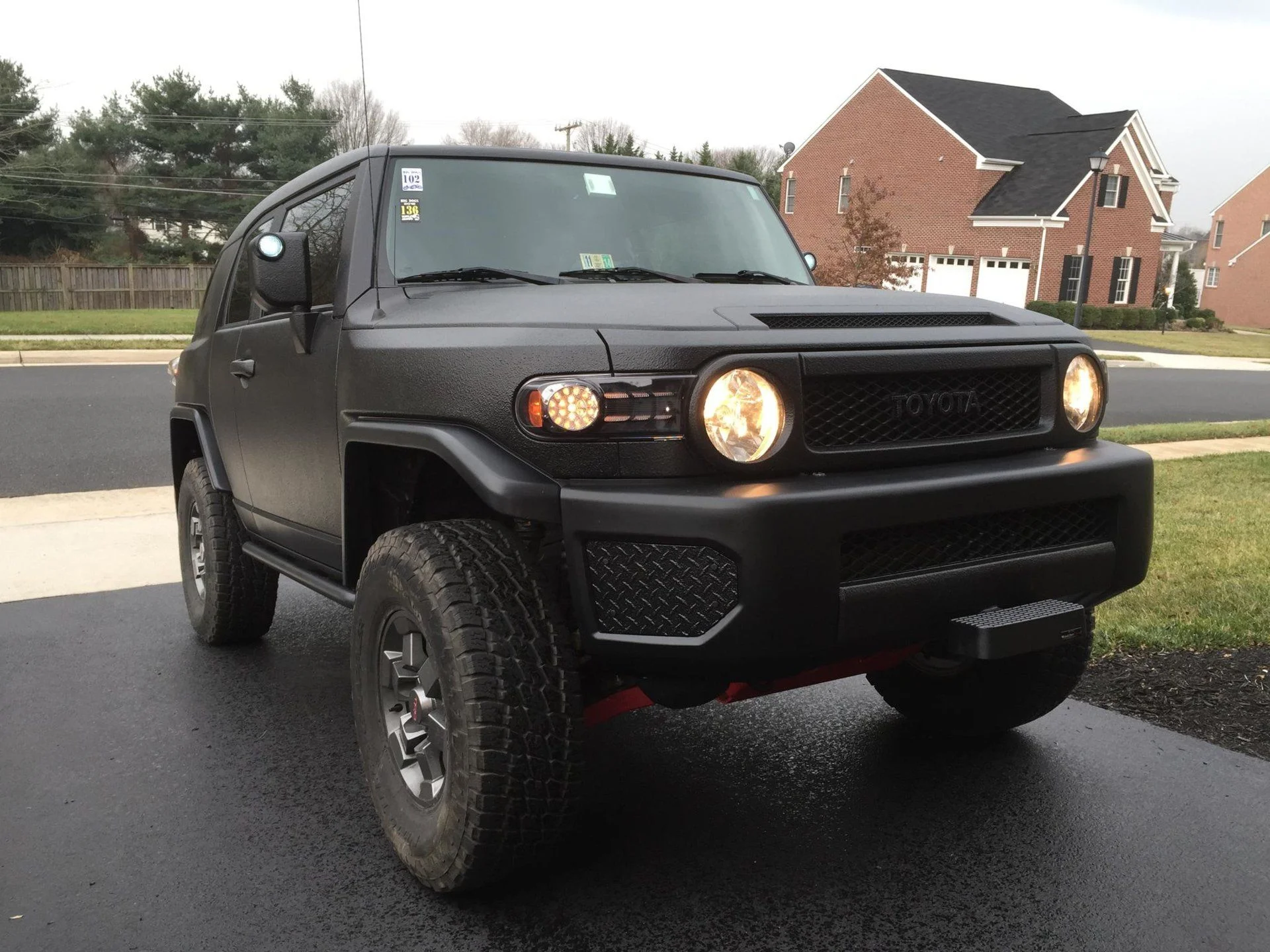

The answer... Monstaliner
This FJ Cruiser is my inspiration. After seeing this on a FJ cruiser forum I knew thats what I wanted to do.

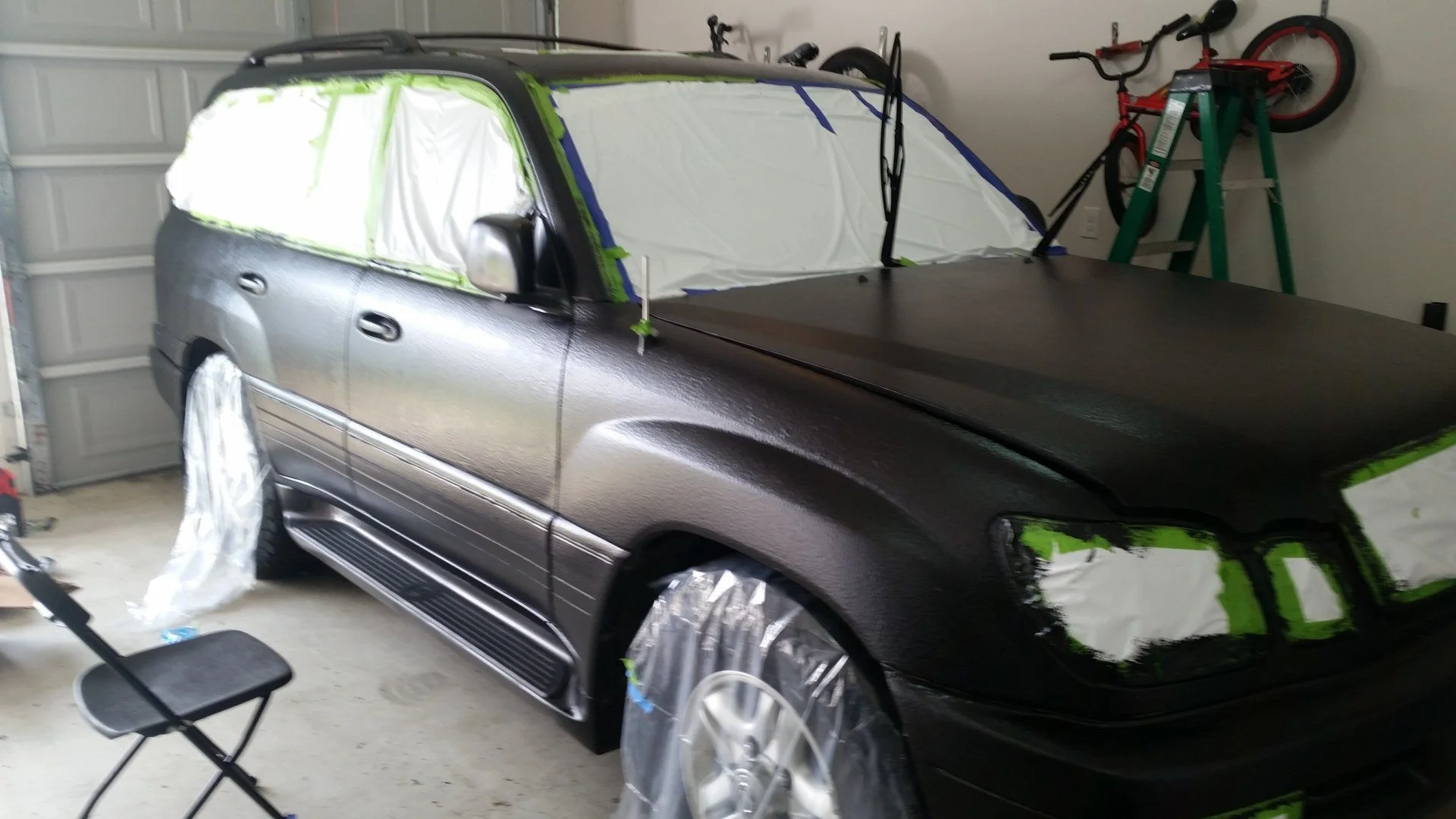

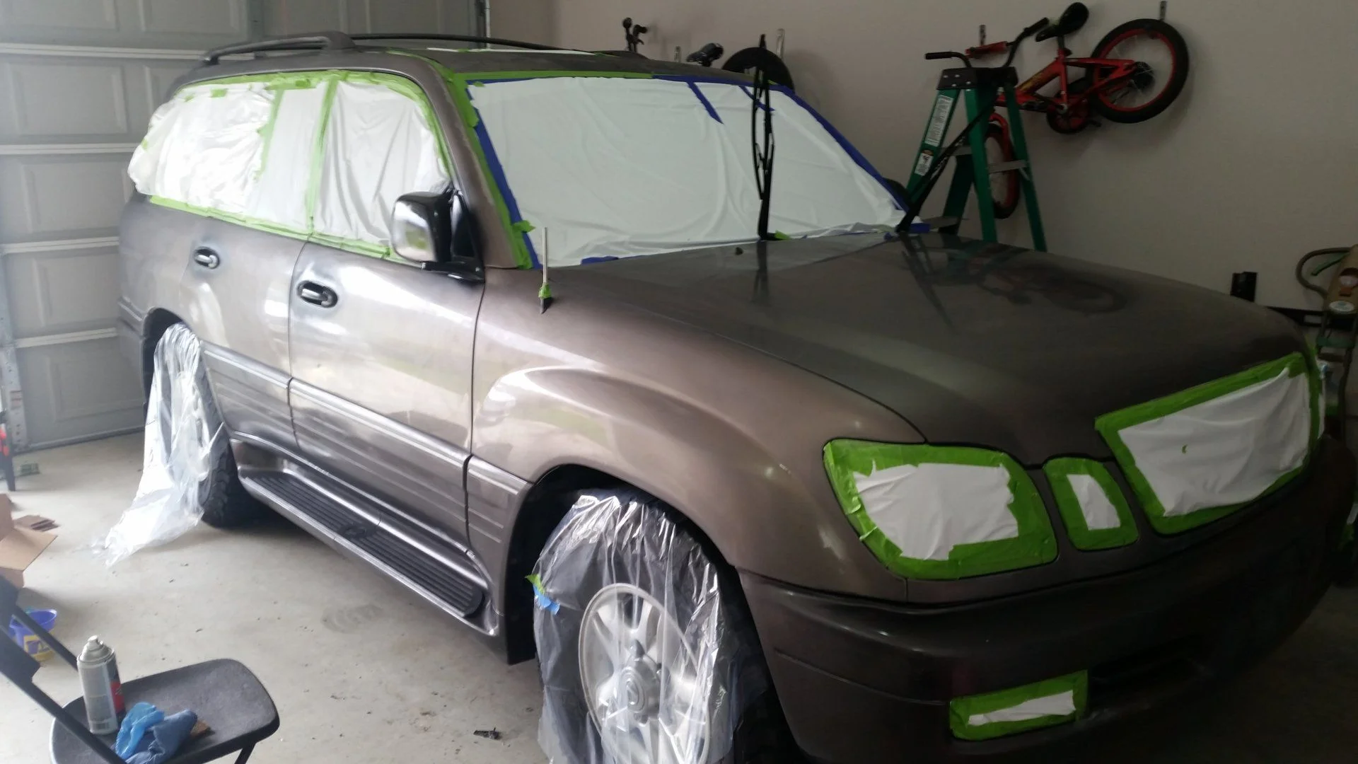

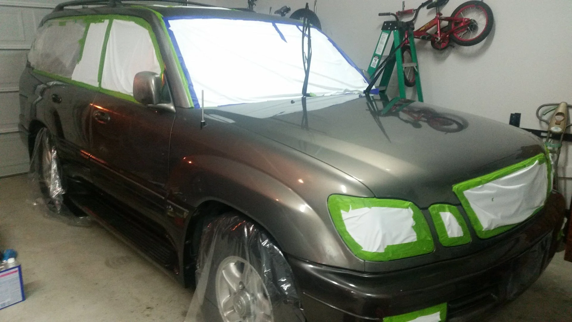

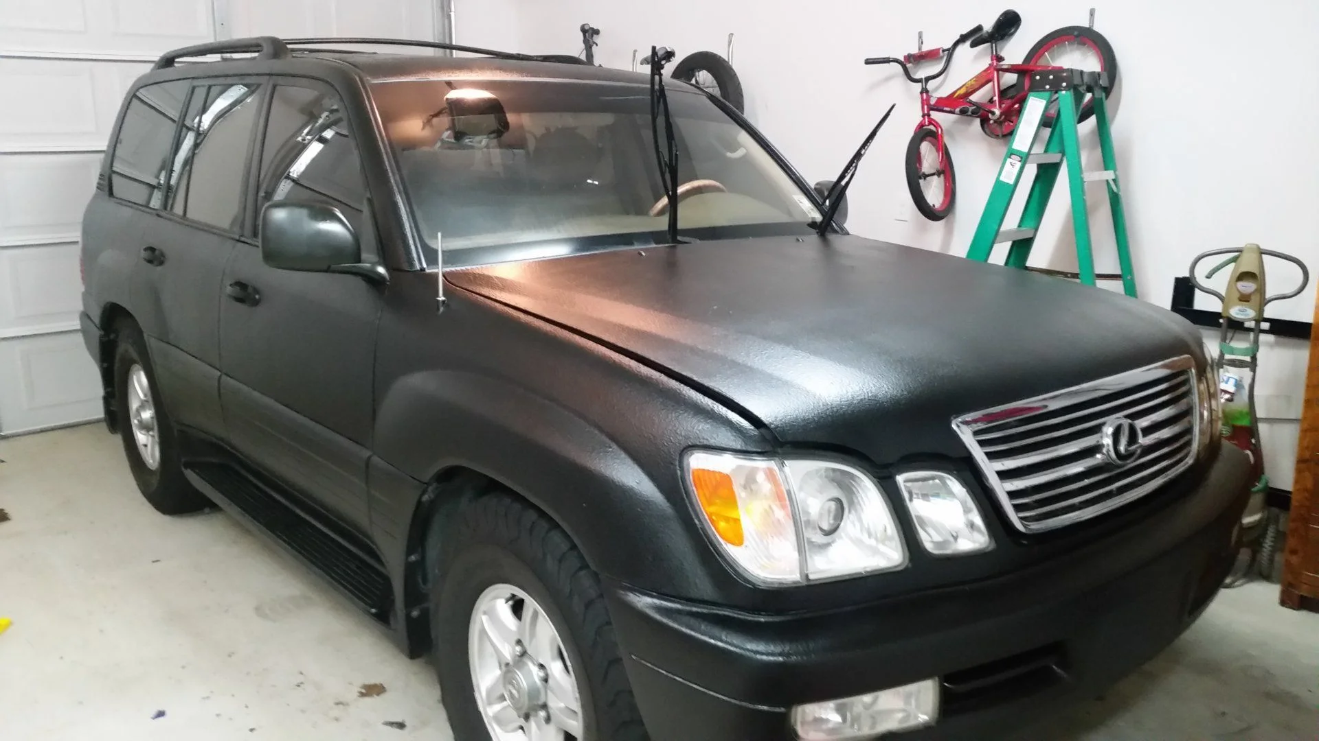

Prep is the most important thing here. Make sure you have plenty of time set aside for it. I spent Friday Evening all the way through Saturday night just doing prep. I washed the truck very thoroughly and removed taillights, emblems, etc. Then wiped the entire thing down with MEK. Next I sanded and scuffed it down, you can use the pads that come with the kit or 120-180 grit paper, I used both. The only places I didn't have good adhesion were the places I got lazy on prep so keep in mind the prep is 90% of this. After the sanding I did a final wipe down with MEK and decided to wait until the next morning to apply the first coat.
1944593
1944594
You absolutely have to have all of your prep completely done before you mix the catalyst with the bed liner. the instructions will tell you that have 6-10 hours to use the monstaliner once it has been mixed, but honestly I found that realistically its much closer to 4 hours before its consistency has changed. As far as applying I rolled it instead of spraying but I've seen good results from both methods. Change your rollers early and often. I finished the first coat around lunchtime on Sunday.
1944597
I started the 2nd coat Sunday evening after giving the first coat plenty of time to dry. It help to to have good lighting but I think no matter what you will probably find a spot or two later on that weren't perfect one. The good news is Monstaliner has a touch up kit for $20 that can take care of any imperfections you find after the main work is done.

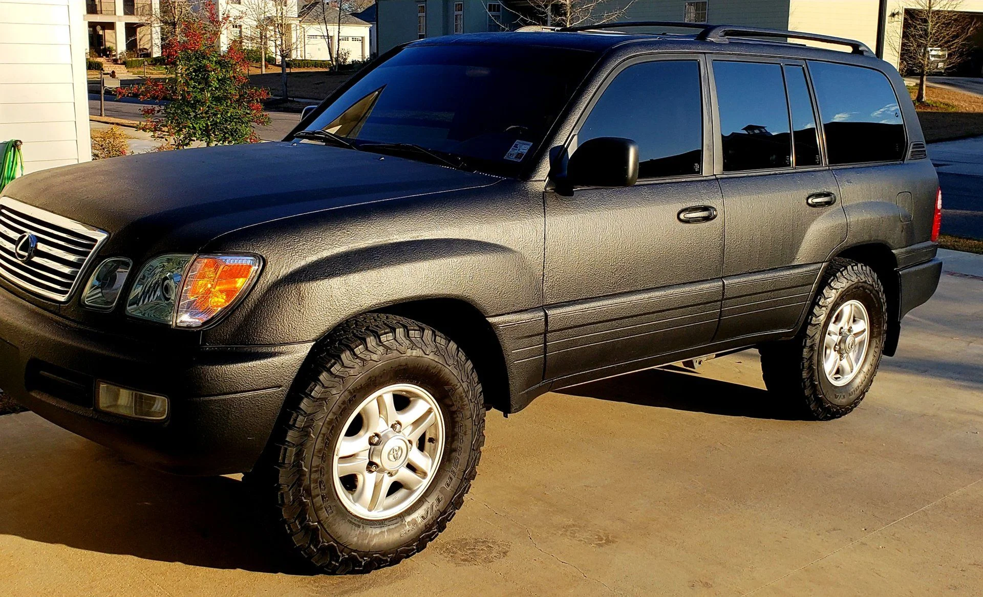

Finished Product -Not a perfect job by any means, but I was pretty darn proud of the way it turned out.
1944599
This is awesome. My paint is still in nice shape (and I like the color) but would consider doing the bumpers and plastic trim and this makes it seem fairly straightforward.
285/75/R16 poser pic at full height, but you could always make it go higher if you wanted to.
