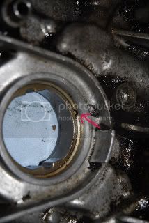

Someone suggested removing the bell housing brackets to get those nuts. I did that tonight and the housing plate covering those nuts slid right out. Piece of cake. Oil pan came off nice, I just pounded it loose with my hand. There are two spots in the pan that the paint is flaking off. Is this a big deal? I know the FSM says not use any solvents that will erode the paint, but if i just remove any loose paint and clean it well is that ok?
Baffle plate is still giving me trouble. I think I'll try tapping a puddy knife in there to wedge it free. I'm gonna start taking pics because I haven't seen anywhere where these two jobs were done at once on a 3.0.
Having never pulled a seal before is this oil pump normal?
