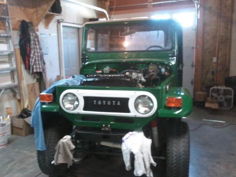

The Great Gazoo from 1972!
I was hoping apeterson's visit was more productive but my suspected bronchitis has kinda kept work at bay. BUT some lights are working and the truck turned over for the very first time this morning.
Posted from a brick.
Came home to a brand new Trollhole carb and slapped that on. Sure is easier when the truck is partly taken apart.
Also started putting hose clamps on everything.

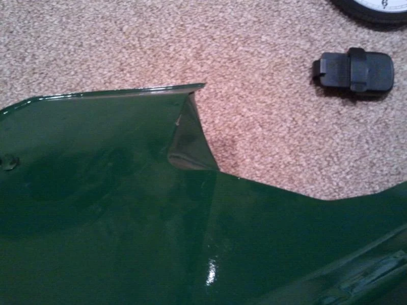

Finally, I discovered the cause of my big fender gap. The fender is touching the minitruck steering box. :bang: The only solution I see is to clearance the nicely painted fender. :bang:

Post up some pics?? What year fender? Wonder why mine fits fine.. Ugh..
I am thinking it is because of the mount. I can't remember where I got it but it never fit quite exactly right.
I have no idea what year the fenders are.

Here are some s***ty pics of where the steering gear is hitting the fender.
It is just at the edge of the cut out for the oem box. I am considering cutting about a 2 inch hole with a hole saw. That would give the corner of the box just enough room to protrude.

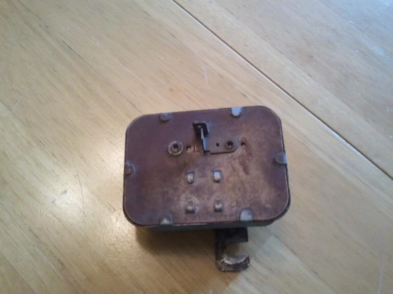

I am also in need of an electronic flasher for the lights. There are no helpful part stores nearby so without a year/make/model or part number I am SOL. Anyone know an electronic flasher that would replace this one?
I've never heard of a bad stock flasher. Does it not work?
The wiring of the EJ40 is weird in that the same flasher is used for turn signals and emergency flashers. THat's why the wiring around the hazard switch is so complex.
That's too bad about the fender clearance. A hole saw cut will look tacky and you've got a nice looking fj40 here.

The flasher is not bad, I have rear LED lights and all I have read says they do not provide the resistance I need to make the flasher work.
This thread is helpful:
https://forum.ih8mud.com/40-55-series-tech/533110-led-flasher.html
And I did have a bad stock flash in my parts bin. If you shook it you could hear pieces rattling around in it.
From my internet travels, it does not appear there is an electronic flasher available with the spades arranged the same as the OEM box so I will just use some jumpers.
So what would you suggest to clearance the fender, Drew? If I get a new mount it will likely require reworking the steering linkage a bit, plus filling drilling new holes in the mount and maybe the frame. Getting another fender is not an option at this point and repainting it is not a great option. I am open to suggestions.

Just grab any electronic flasher that has 2 prongs. The Autozone I got mine from only had 1 or 2 choices when I got mine.

didn't get it - what exactly is the wiring problem ?
I still have the old flasher relay box, I think, if that's any help
I have trailer leds on the back. Those require an electronic flasher, not a solid state one. The leds will not give enough resistance to make the flasher open and close. The other issue is that since I have not gotten the driver's side fender mounted, I do not have a good ground so the circuit is not complete to fully test it. There may be something wrong with the brake light circuit too :meh:

Well, this is what I had to do. It needed considerable space but you can not see it from the inside. :meh:
I shot it with some rattle can bedliner.

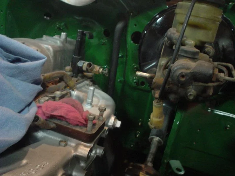

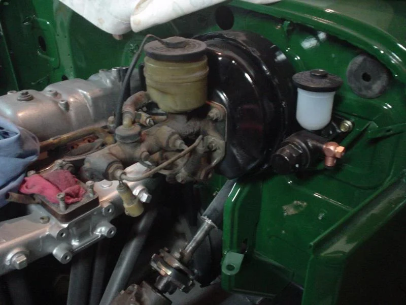

Finally, I found my gasket material and made a paper gasket to go between the master cylinder and the booster. It isn't pretty but it will do the job and it is going to do it for free. :meh:
Booster and cylinder are also out of the '86 FJ60. I had to shorten the shaft at the pedal about a half inch and after turning over the booster it fit right in.
Just a short piece of tubing will get me to the vacuum port.
