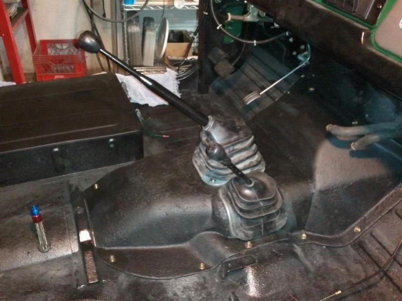

Got the hump and the heater in tonight as well as the windshield washer bottle which is the first thing electric that has not work. :doh:
I had some pics but the app keep crashing on my phone. :hhmm:
Ahh, there we go...
It required some modification due to the H55. The boots are out of a 60.
Posted from a brick.
boots look good - I'll have to keep that in mind [out of a 60, eh :bang:]
