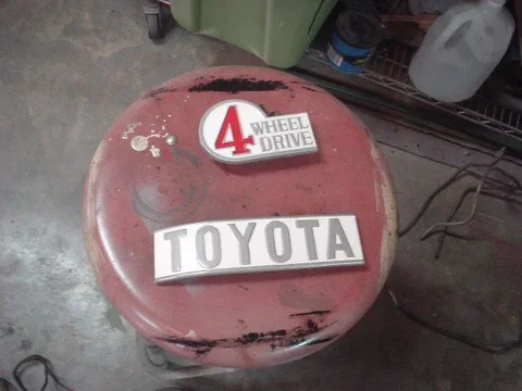

A couple more boxes showed up at the house yesterday. I could not resist installing the emblems on the aprons this morning. I do like the early emblems better, but this is what fits. Still, a thing of beauty.

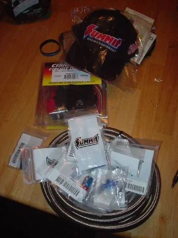

I finally got the hard brake and clutch lines satisfactory and started clamping them in place. What a pita. Also, the wife gave me the go ahead to buy the gauges. Not cheap but should be worth it and spring us forward to wiring. The other thing I worked on was hand painting the emblems some more. So far so good on that....supposedly I am getting a few small bits from a wreck in Nashville coming my way tonight. :bounce:
