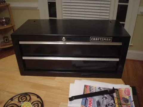

If you don't check out the Home Improvement section, it was posted that Sears has their ball bearing tool boxes on sale 50% off!
I scored this center section for my roll around for $50!
No matter your current opinion is about Craftsman, it is a good deal.
