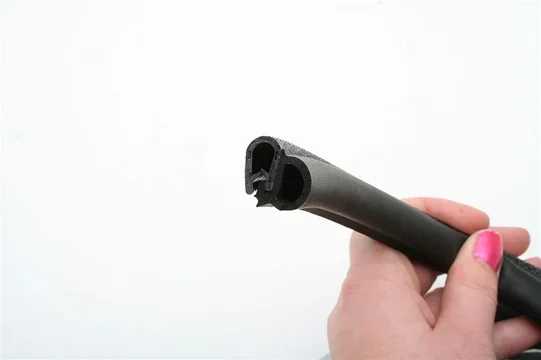

just FYI, on the hood stuff, i just used some i got from home depot and it works great, it's not a place that requires a complicated weatherstrip setup. you can see it here:
That kind of looks like what I just used on my tailgate today! I consult this thread from time to time, usually after a weeklong trip through Death Valley, and I come home with mor dust inside than outside!

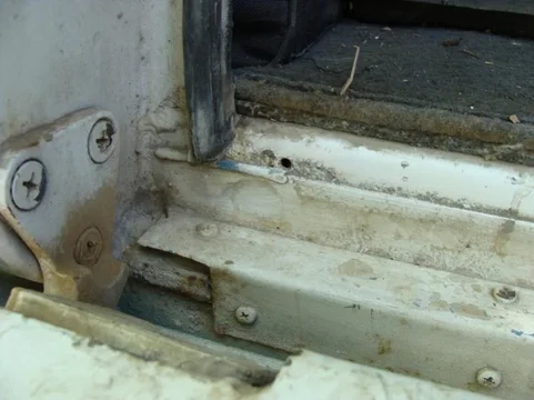

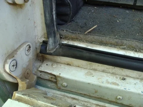

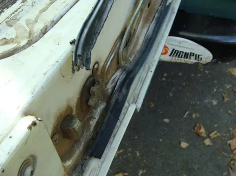

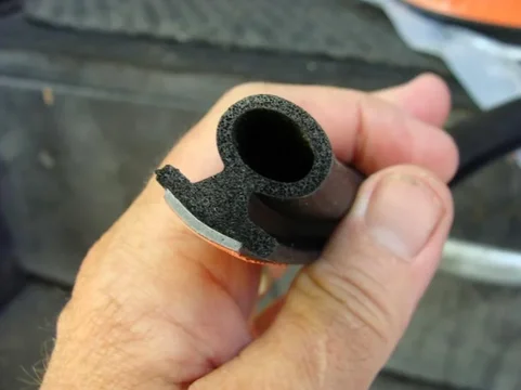

3M Part #08650NA: 8' - 7/8" x 3/4"
The vertical piece appears to be original...

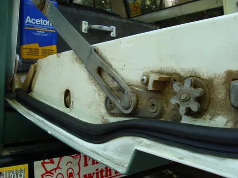

There was exactly enough leftover to do the sides of the tailgate (I believe these pieces were original as well):
There was exactly enough leftover to do the sides of the tailgate:

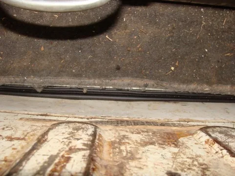

Oh, Tailgate closed, looking down at the un-even seal... Seems OK to me:
I'm gonna go find a dusty trail and see how it works!
:bounce:
By the way, this piece makes a reasonable low budget upper tailgate window channel by placing it on each of the two pinch welds. The glass is cushioned nicely by the nice soft rubber... I suppose you could glue a piece of inner tube rubber between the two pinch welds as well.
