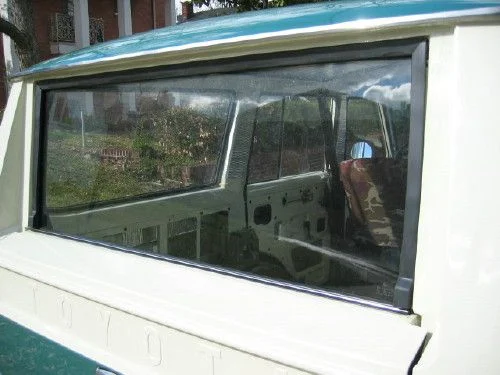

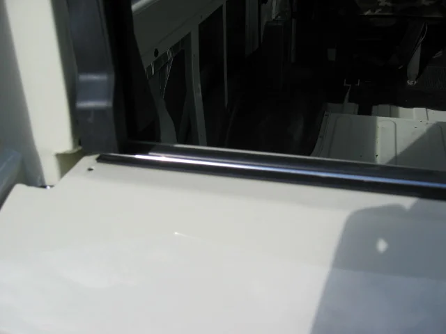

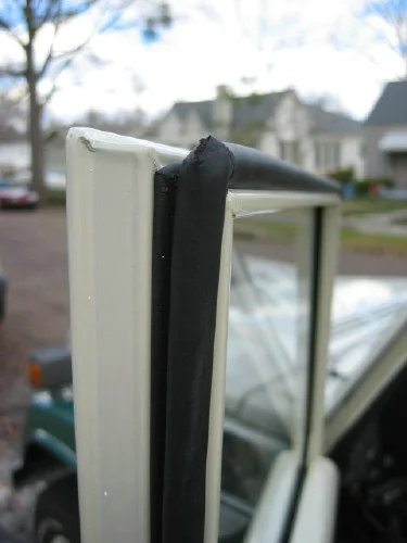

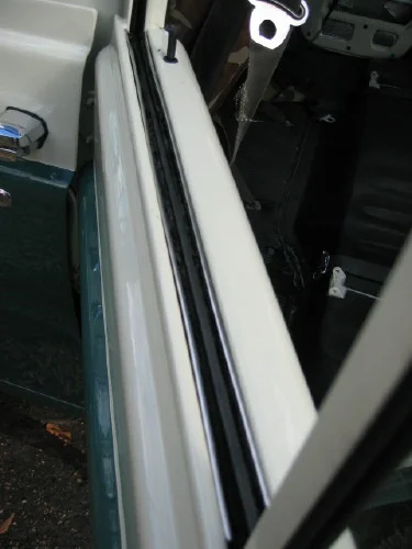

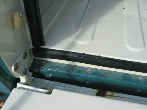

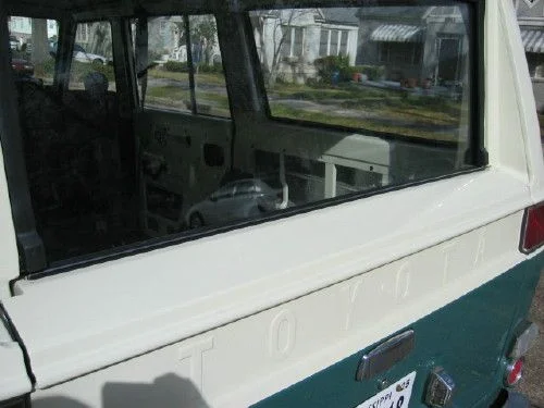

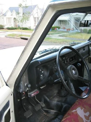

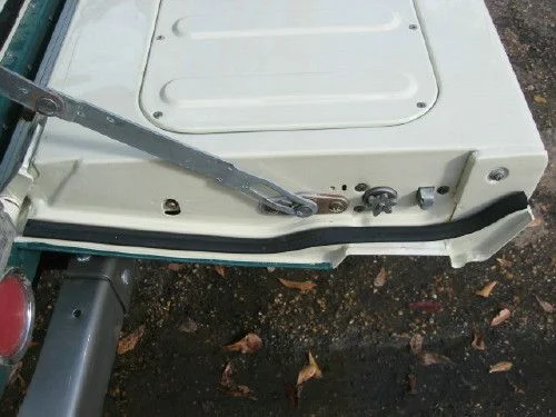

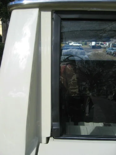

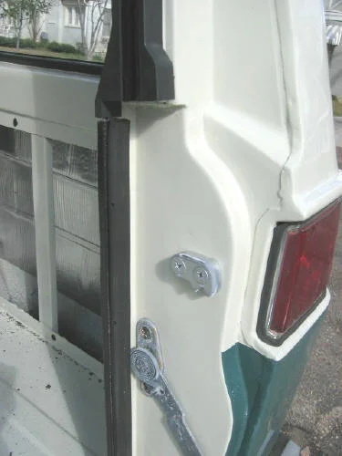

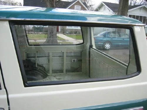

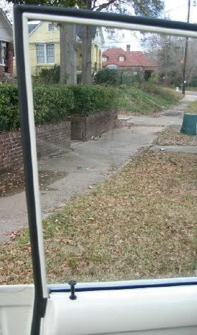

I've been compiling this list for awhile as I have been "refurbishing" my 55. Following are part numbers, prices, sources, and pics for most of the rubber parts on the Pig. Most parts are identical or very close to factory - while a few were chosen for economics. If I left out anything, please add.....

Window Channel
Driver / JC Whitney/ $9/ ZX184879T/ 8 ft
Passenger/ JC Whitney/ $9/ ZX184879T/ 8 ft
Left Rear/ JC Whitney/ $9/ ZX184879T/ 8 ft
Right Rear/ JC Whitney/ $9/ ZX184879T/ 8 ft
Tailgate/ PV Cruisers/ $225/
Window Felt (straight chrome w/ felt)
Driver/ JC Whitney/ $14/ ZX193480P/ 8 ft
Passenger/ JC Whitney/ $14/ ZX193480P/ 8 ft
Left Rear/ JC Whitney/ $14/ ZX193480P/ 8 ft
Right rear/ JC Whitney/ $14/ ZX193480P/ 8 ft
Tailgate Inner/ JC Whitney/ $14/ ZX193480P/ 8 ft

Door Weatherstrip
Driver/ JC Whitney/ $17/ ZX813688A/ 10 ft
Passenger/ JC Whitney/ $17/ ZX813689B/ 10 ft
Left Rear/ JC Whitney/ $17/ ZX813688A/ 10 ft
Right Rear/ JC Whitney/ $17/ ZX813689B/ 10 ft
Tailgate - Sides/ JC Whitney/ $10/ ZX133178W/ 10 ft

Glass Weatherstrip
Windshield/ SOR/ $39/ 120-03G-A
Cargo - Left & Right/ PV Cruisers/ $230
