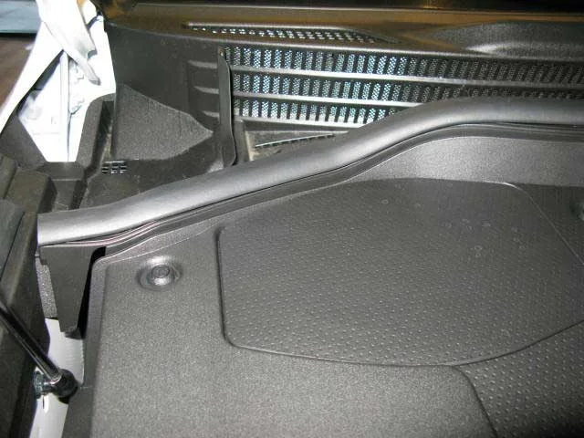

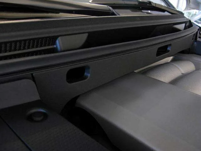

How about this, hood cowl weather strip for a LX570, I just order it , should arrive monday $36.00. I also have samples coming for the tailgate side tracks along with 4-5 different clips for installing belted weather strip from Restoration Specialist.

Lou, can you measure the height of the Lexus seal?; trying to get something close to the 1 1/8 inch of the original :hhmm:TIA

I'll do that to at work today, it appears to sit higher in the middle section and it is hollow with a flat bottom. I might glue it to a flat piece of solid rubber to get the height right. if the function is to direct water and keep it from running down the face of the firewall , this will work.

Retsoration Specialist is strictly retail, I'll have them send me samlpes and we'll see if they work. My concern is the bottom appears to have small curve. The LX rubber is only about 5/8 of an inch high.
