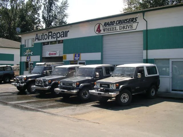

Okay... that's it for now... but first a few introductory pictures.
Coleman's the unit shown in the first picture, and is on the right in the second picture (the other three are HZJ73 - from left to right - 1992 5 spd, diff locks, electric winch; 1990 5 speed; 1990 5 spd diff locks, PTO winch.

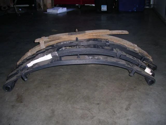

In the first photo, you can see the various springs I put out on the shop floor to compare for measurements.
Springs in photo from front to back:
CS003F
CS006F
CS017RB
CS005Rx

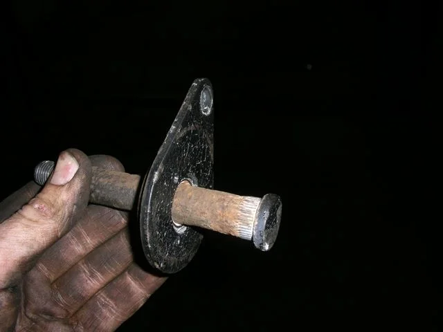

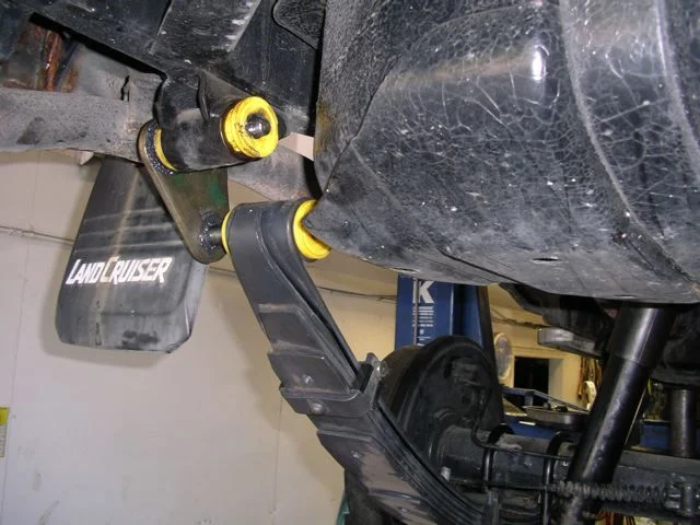

The first photo in this sequence shows the front spring pin for the rear springs. The part is replaced with OME GSP01, which provides for a greaseable spring pin. The front spring pins are the same as the 60 series, and I used the Terrain Tamer units since the quality is good and the prices is quite a bit better than the ARB Old Man Emu parts.

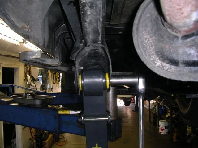

The second picture shows the new pin for the rear springs being bolted up. In the end, it was easier to fit the springs to the shackle end first, and then swing it up into position for the front pin to go in. The placement of the fuel tank and how the rear shackles go in as result was why it was easier to do it that way.

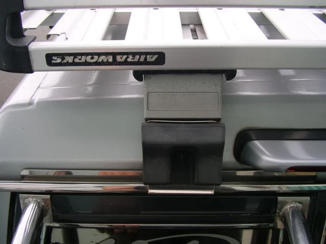

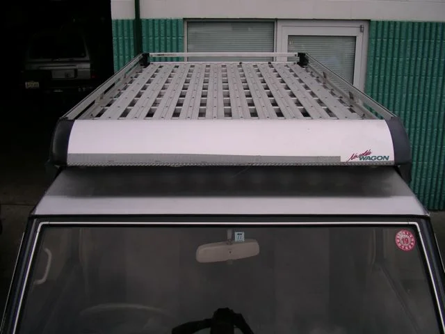

In your pics there is a 74 with a rack that looks like its mounted to the gutters. Do you know the specs on the load this rack
can carry? Would it handle 50kgs (Roof Top Tent) whilst 4x4ing? I'm looking at mounting my rack the same way if the frp can
take the stress and weight.

The extended shackles in the rear are some Japanese units that arrive with quite a few of the JDMs that come in. They are made by "Dune" and are forged according to the stamping on them. They have two length settings, and I cut these ones off to the shorter bolt hole.
In general, longer shackles are not a great way to lift your truck, but I had these and have set up the suspension to make use of the 12cm length quite well.

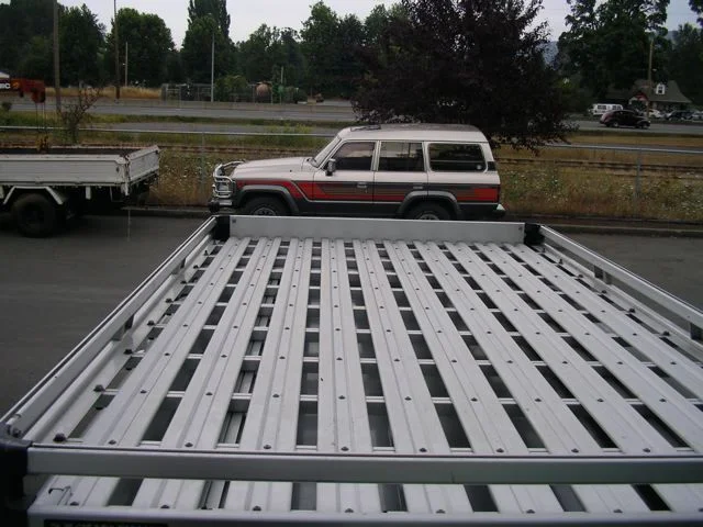

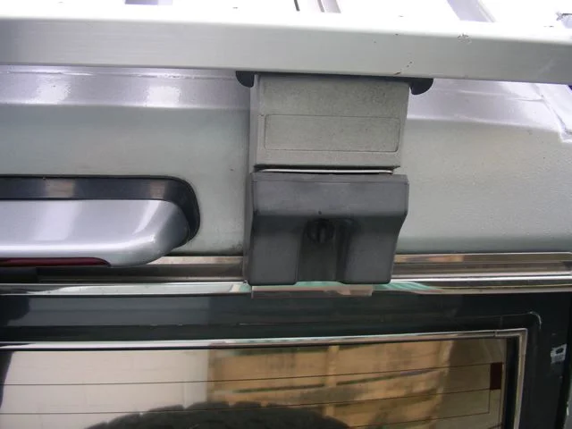

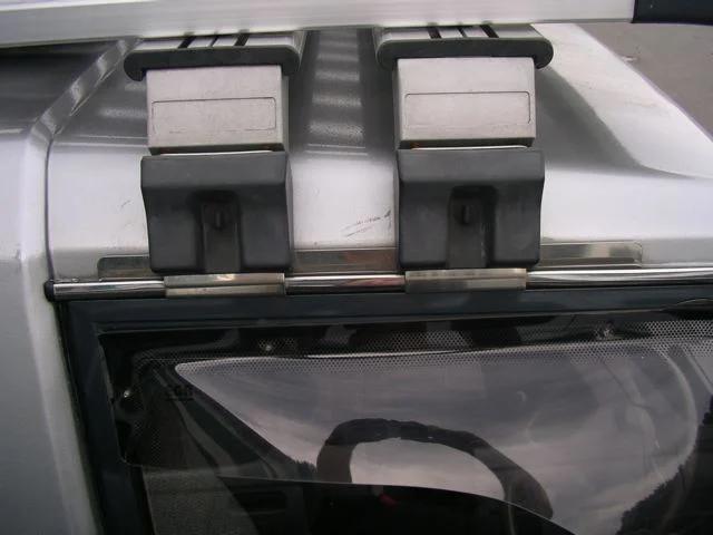

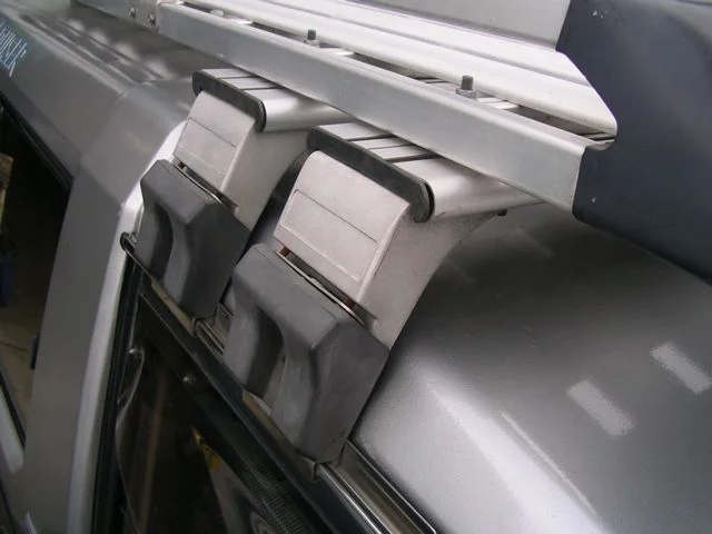

Cheers mate.
I had a look and there's a sticker in there written in Japanese that has 30kg written on it, and I'd assume that's the safe maximum load. The supports sit in a length of stainless channel that's dropped into the rain gutter on the FRP top - for load distribution and damage prevention.
I'd think that 50 kgs would be fine, the rack is certainly strong enough to handle it. I don't like putting large amounts of weight on top of short wheelbase vehicles very much, but if you have sway bars or springs that will prevent sway, then I'd expect things to be okay.

Hi John some photos of the roof rack set up would be awesome. 74's are few and far between where I am and one
with a rack would be even rarer. I'm deciding on how to mout a RTT at the moment.

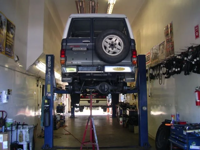

Coleman on the lift, undergoing surgery...
And you can see off the right of the truck that we carry quite a good selection of Land Cruiser rad hoses and belts (shameless plug)...
Initially, I tried to install the OME GS1 shackles, but with the vehicle on the lift and the spring hanging, they were clearly too short for the job. It would be nice if OME made the springs just a touch longer, but ARB seems to have its ears plugged when the Land Cruiser market is concerned as this has been voiced over and over again to no avail....
