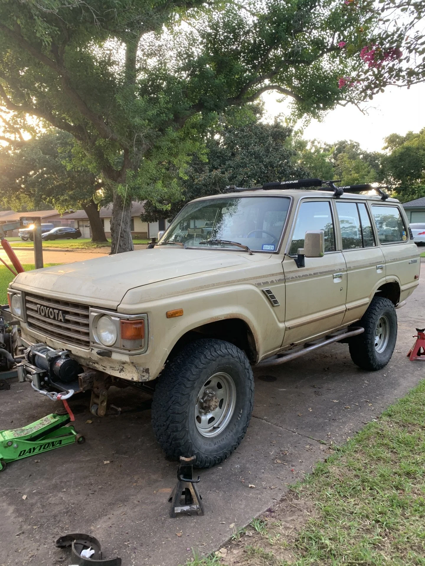

Extended sway bar endlinks, drilling gas cap, inspecting some weird noises and vibrations, and topping off every fluid, adjusting or new belts, and oil change and air filter are a few other random things to do. I should make a list and get started on this!
Assessed the damages yesterday, and now the part and accessory ordering is complete, here’s a list-
Midland GMRS radio
Rapid tire deflator
Brake master
Brake booster
Parking brake bellcranks
New parking brake “wire” to replace missing one
Sway bar endlinks
Belts
Air and oil filters
Exhaust mani donut
555 Tie rod endlinks
Motor mount & fuel pump to have as spares

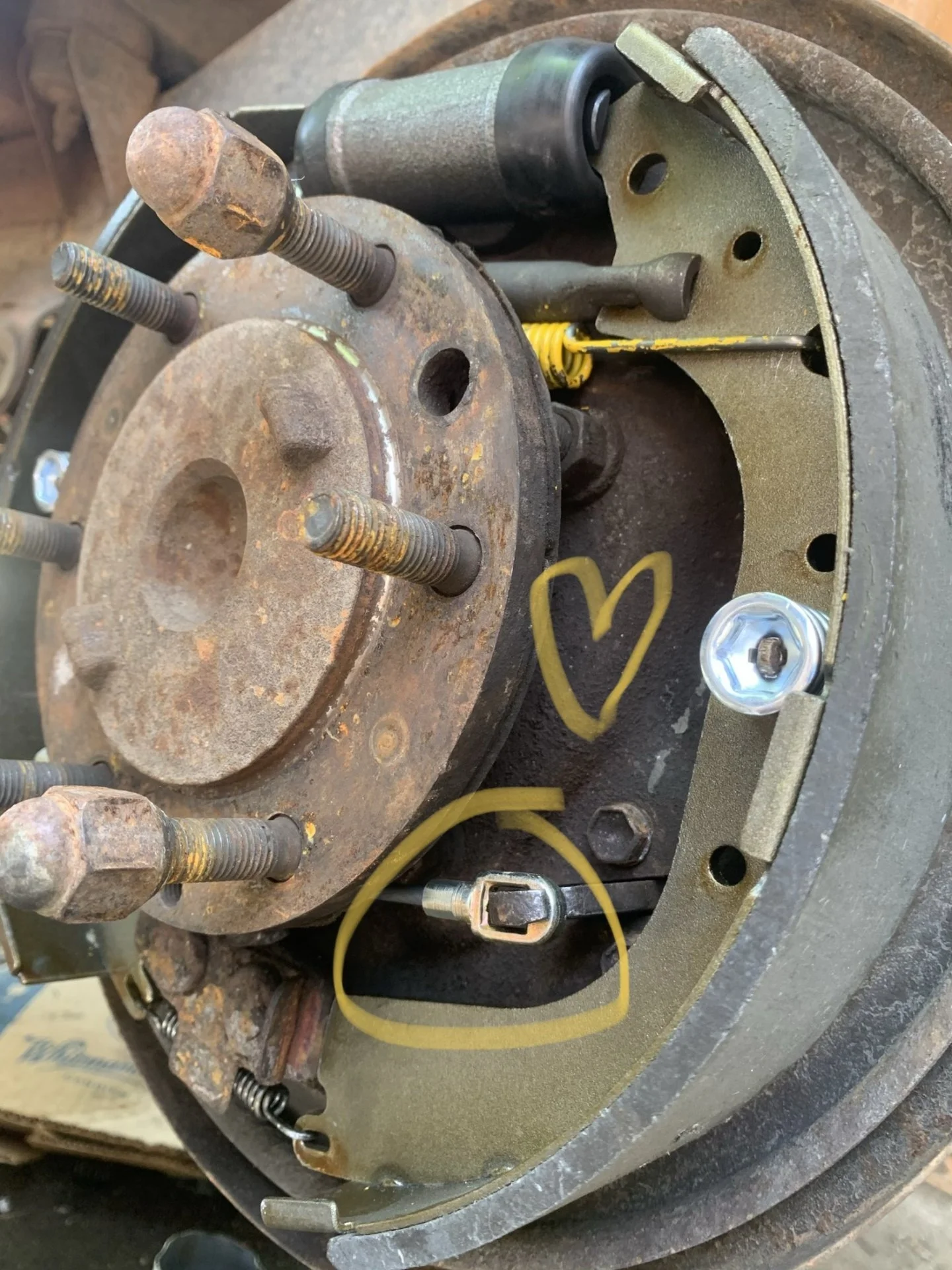

I already have all of the drum brake parts, disassembled one side but can’t really reassemble until new bellcranks are in. One of mine is rusted solid.

Brakes just need to be adjusted and bled (after reinstalling the installing the original booster- got the wrong one from rockauto!). New parking brake wire and bellcranks appear to be a success. Everything else in the drums new too.

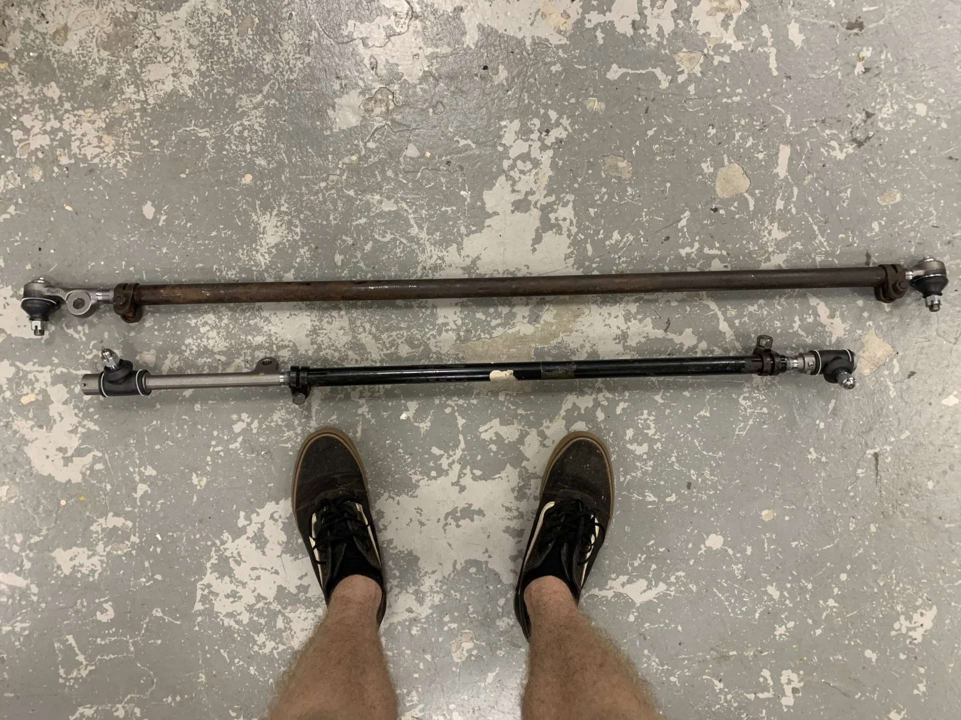

555 TREs installed, just need to put on truck. Got them to the same measurements as the old ones, way different thread count though. The threaded portions of the new ones are completely different lengths than the old, making the count pointless.

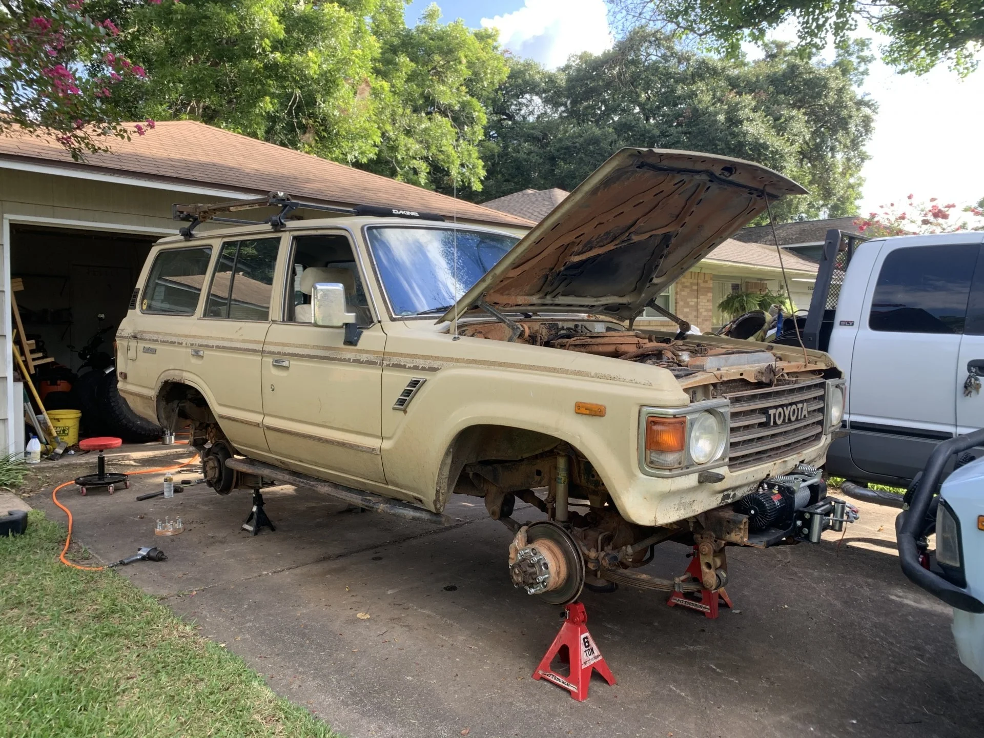

Back on all four. There’s a little drama, but what would we do without it?
Installed new master earlier, then conventionally bled the brakes. Took it around the block, and yikes, hardly stopped! Nearly ran a stop sign. Drums are adjusted and parking brake is perfect now, though.
Bench bled the master, then bled all around again and the pedal got much better.
Got it up to 35mph after that, and besides needing an alignment, something a little odd is happening. Sounds like a screech or grinding noise is coming from driver front wheel, and almost seems to pull that way in a non-alignment related fashion.
After I bled the brakes the first time, that caliper was seized. I was able to pry the pad from the rotor, but maybe it just isn’t happy.
When I got home after hearing the grind, I jacked that corner up and the wheel spun fine. I’ll see what’s up after the alignment, but am I right for thinking worst case that’s wheel bearings or caliper?
Anyways, that was some progress today. Will see about lining out those other details tomorrow. Rear bumper still needs a little trimming, fluids, and I guess I need to pack.
