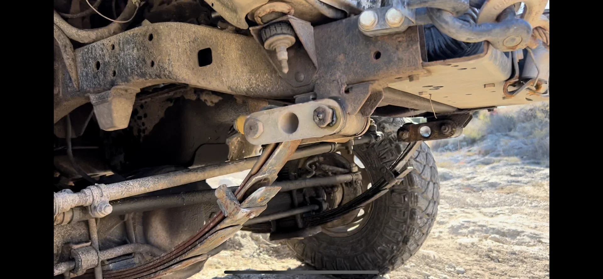

Hehe I think I bent my axle
@HemiAlex should have a replacement for me in a month
And on @landcrusher909’s recommendations I will be gusseting the knuckle balls, trussing the axle, and may do a shackle reversal and go ahead and transfer the air lockers to 4:10 diffs while it’s all apart. 😳

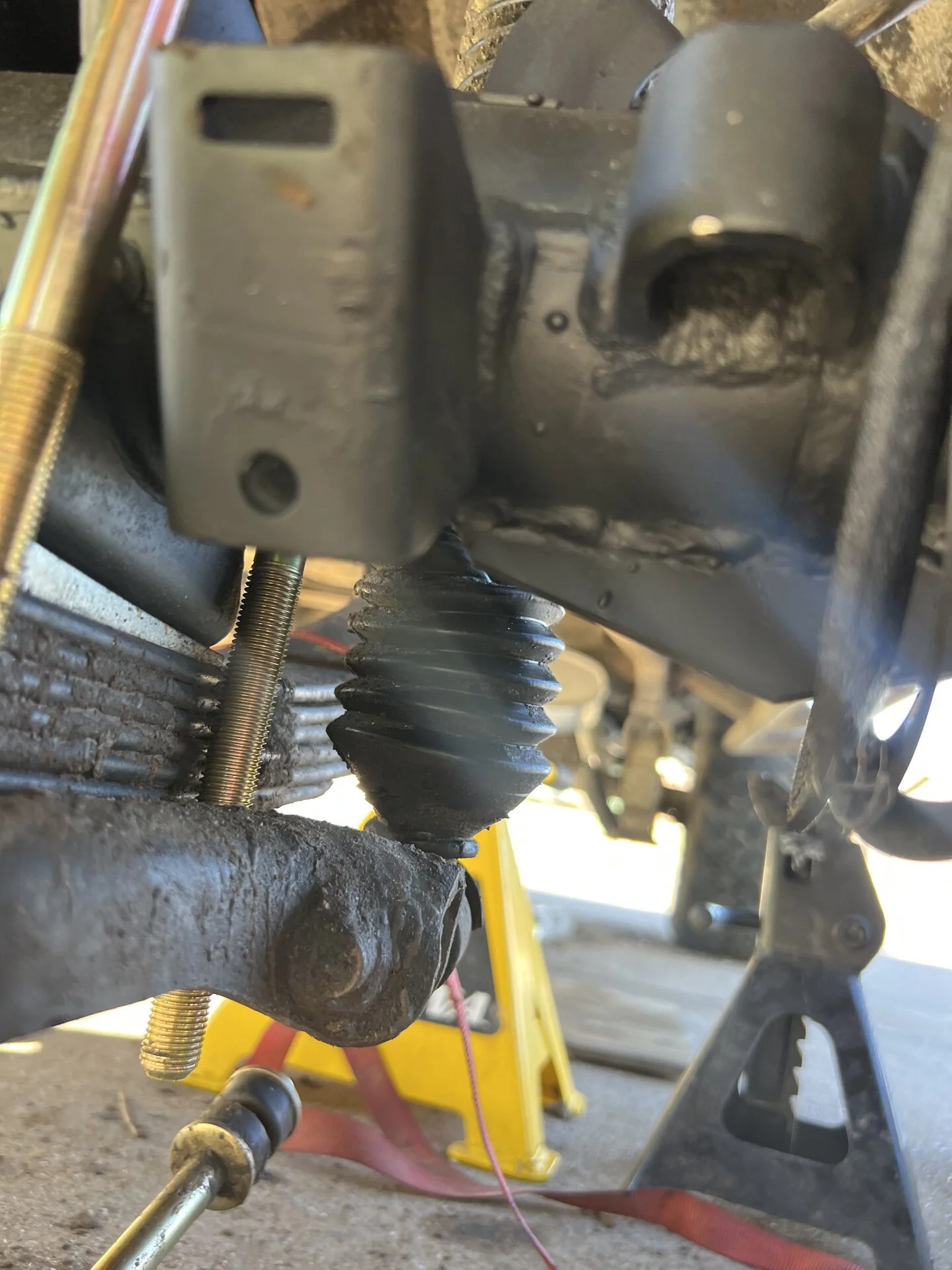

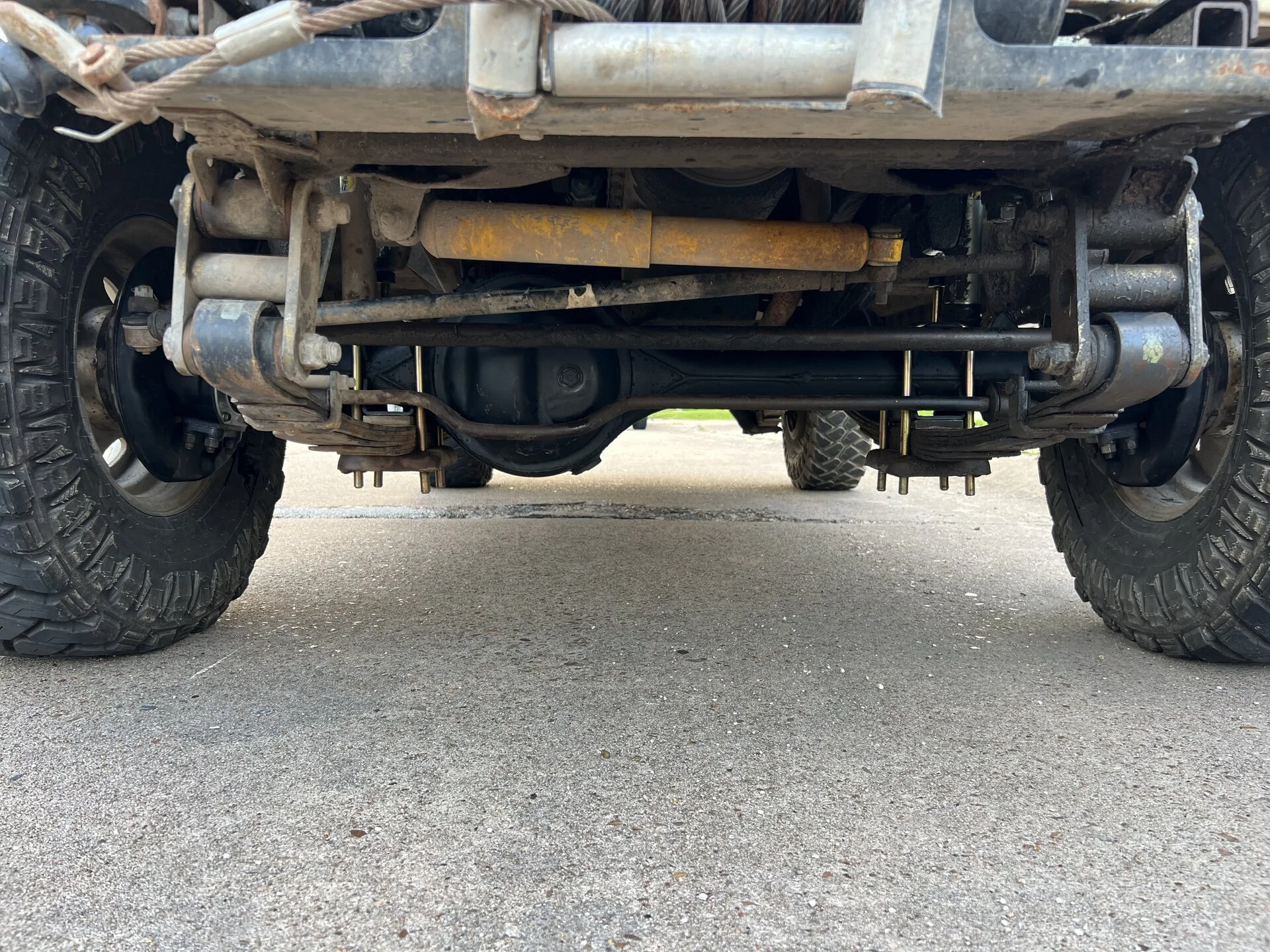

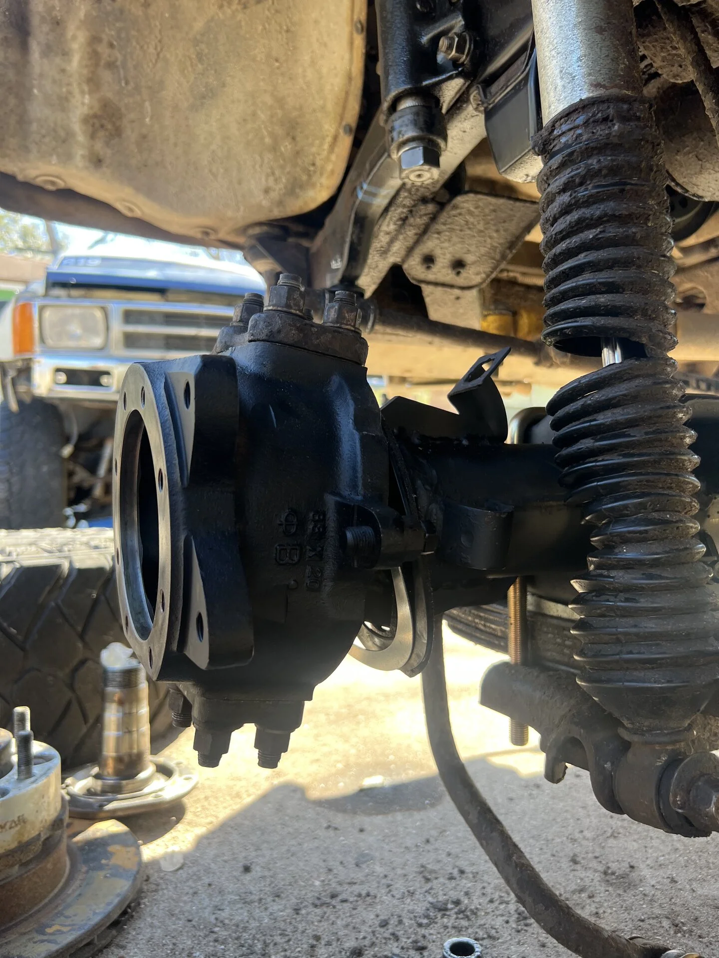

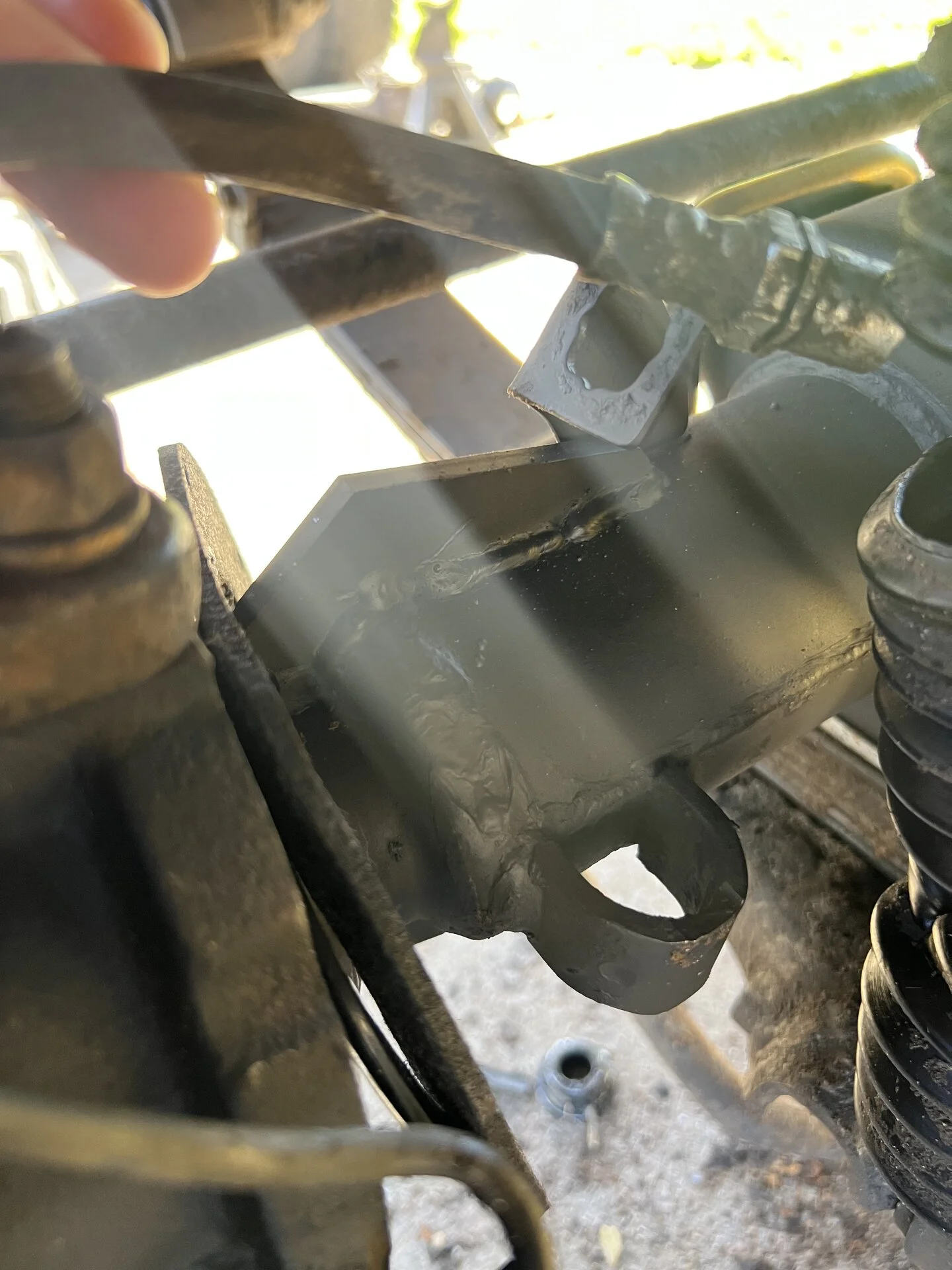

Gussetted fresh axle housing is in, time to pack the knucks and birfs with moly, get the spindle and hub on, and get this thing back on the road. Ended up not messing with the 4runner, have been dailying the KLR
Photos of gussets are required
The gussets are the upper and lower fin things visible in that pic of the axle! Here they are up close and personal though. Booger welded an inch at a time alternating between all 4 to try and prevent warpage. Haven’t used this welder since I welded the sliders on a few years ago, and they’re still on the truck so 👍

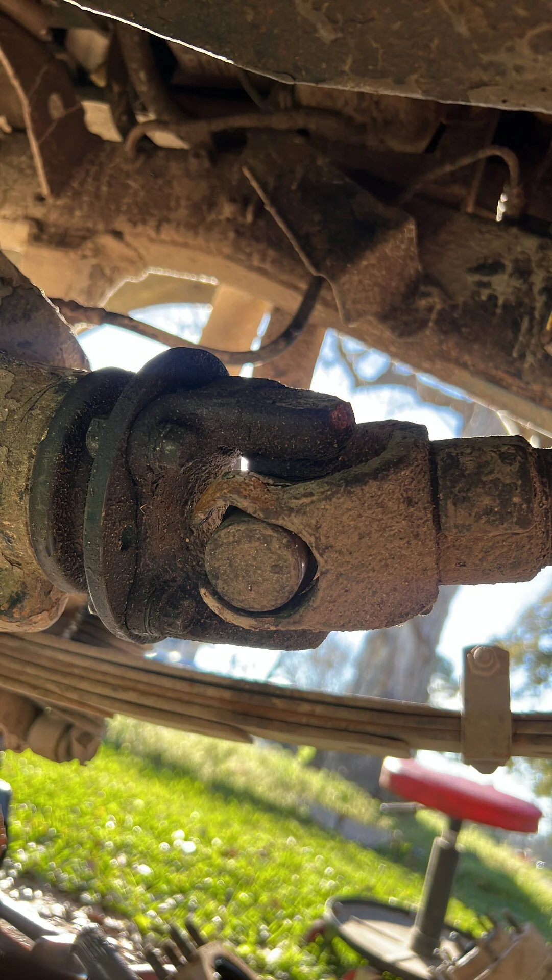

Truck is back together besides a couple slightly broken things that I don’t have replacements for yet (pic from when I was taking it apart, it’s cleaner now)
Stoked to have a nice painted front end, wheels that don’t kachow, and an axle housing that’s prepped for more abuse! Next step is a fresh sleeping platform and I’m ready for LSLC.
