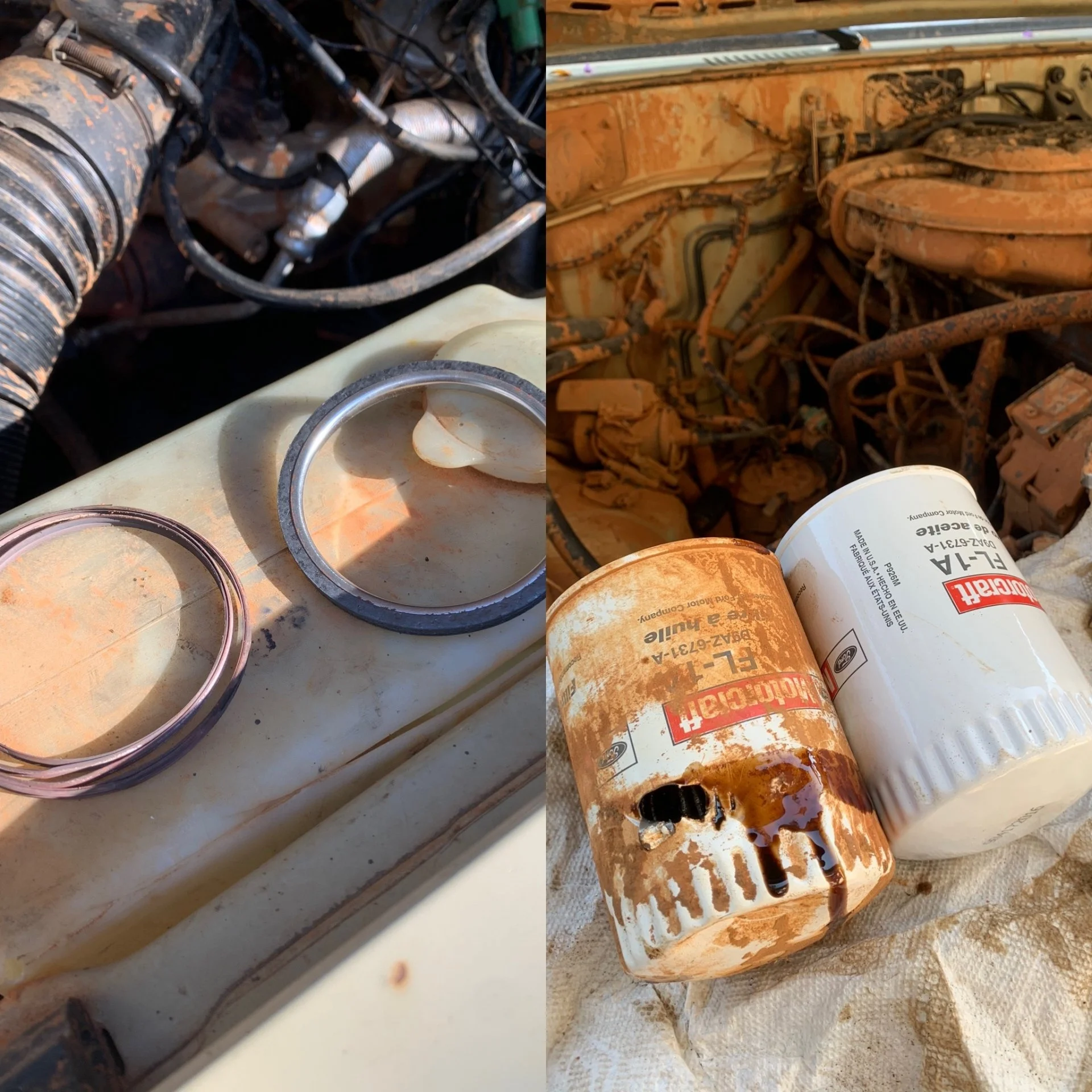

Exh doney and lock washers replaced
Fresh Rotella T4 poured in

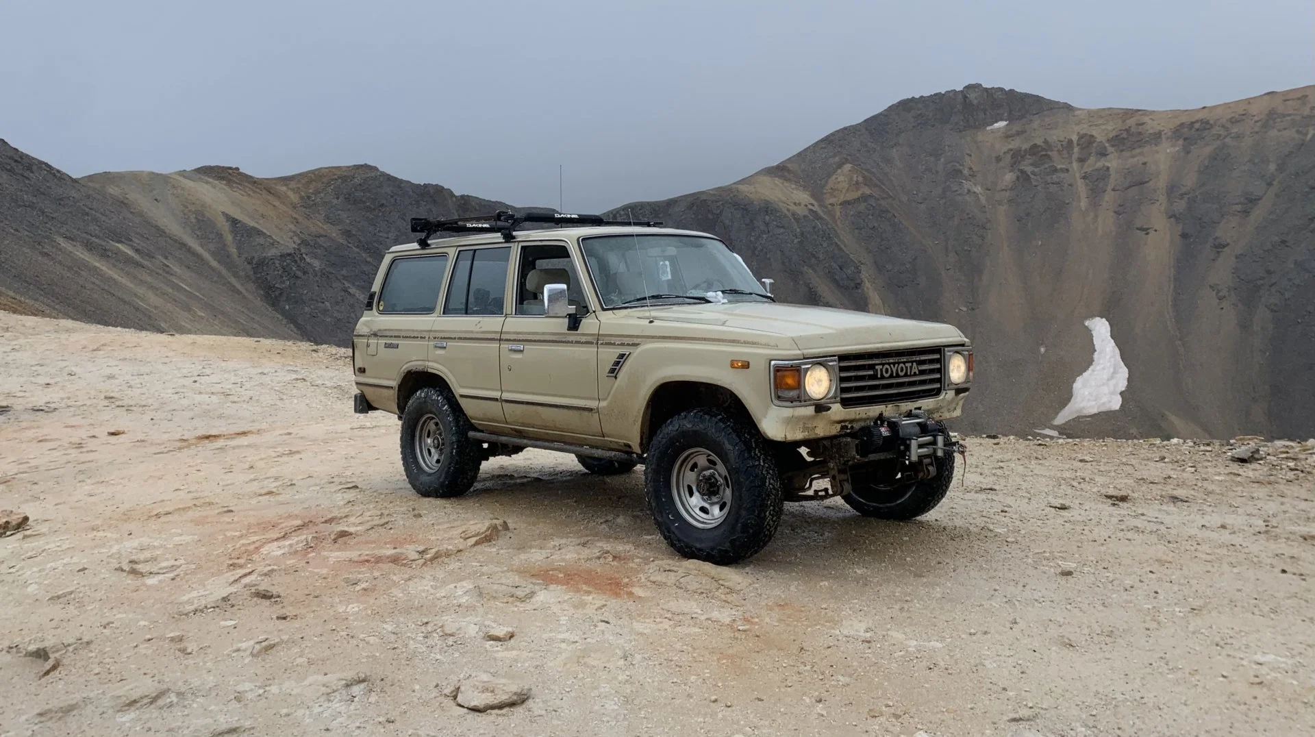

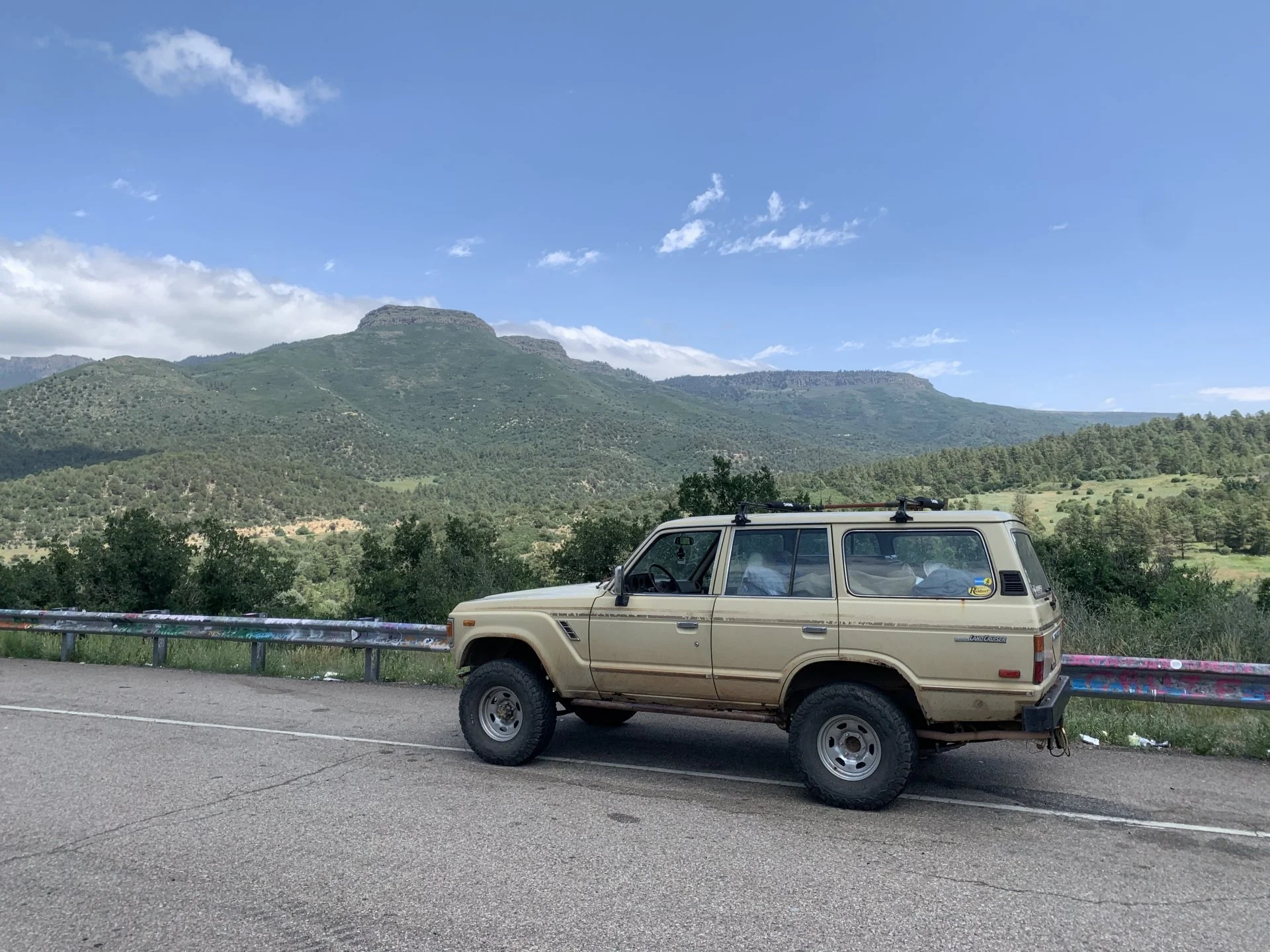

Corkscrew, Imogene, Yankee Boy, Red Mountain Pass, Hurricane, Ophir, Poughkeepsie, and I’m probably missing some. Black bear was done by the boyz while I was replacing my alternator and battery in town. Two days (and one late night) of trails were done by the dude with no charging system!
Fixed the PS and carb secondaries with some oreillys and classic cruiser parts in the elevation brewing parking lot before heading to Ouray via Gunny last week.
Wheelin and laughs were had, and the was topped off with a 14er scramble on Mt Sneffels.
Back in Texas now, 3k miles down this trip and the dude has performed flawlessly, started every time, got up to 19mpg and 92mph, easy-to-repair things may have broken but never left me stranded.

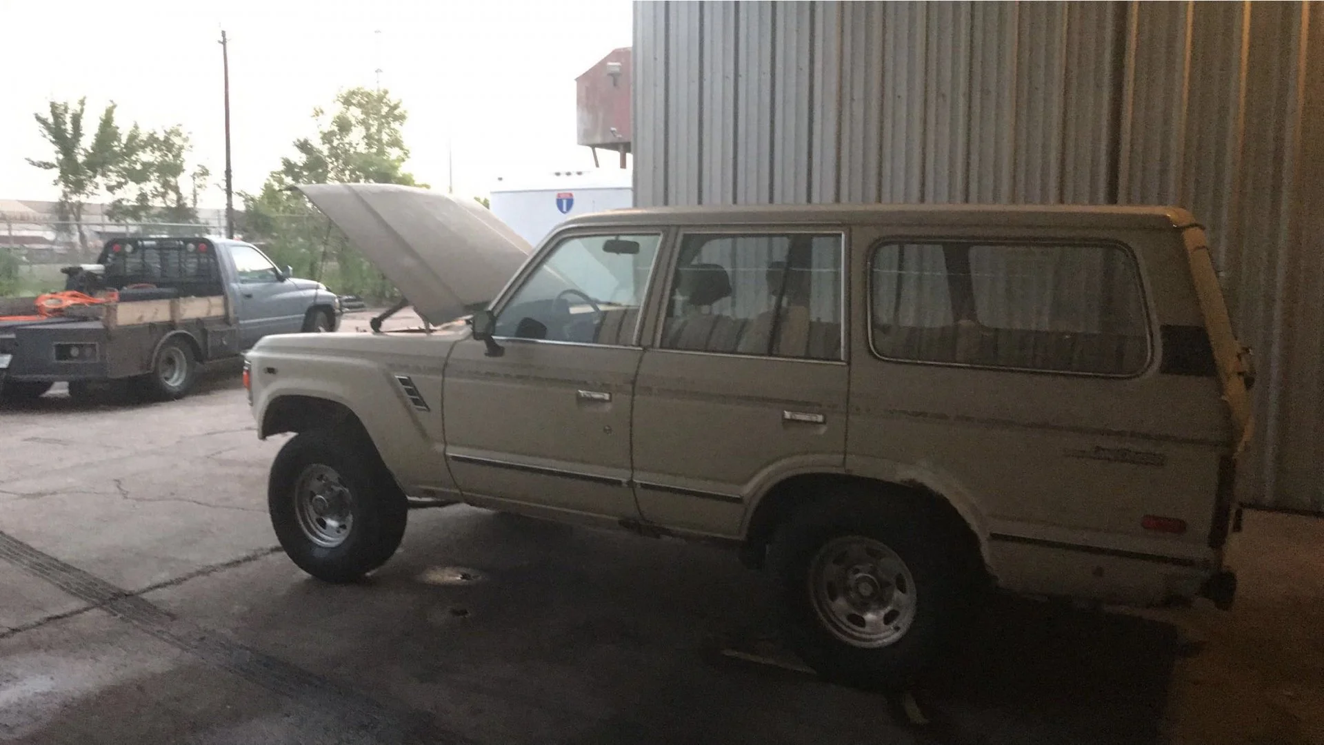

The dude is not abiding! Before I start digging into it, I figured I’d post this video to get some guesses as to what happened.
This weekend, I went on a one hour drive, and a couple minutes from the end, the dude started stumbling, and with any throttle would detonate/ping/diesel very badly. I basically idled the rest of the way at 25mph. Feels like it’s running on 5 cylinders. Perhaps the dieseling is because one cylinder is forced to combust without spark? It’s been proven that the dude has enough compression to diesel…
Nothing is “obviously” wrong; distributor isn’t loose, didn’t see any loose hoses. Probably going to start by taking the in-like spark tester to each cylinder, then popping the distributor cap.
What do y’all think?
Try a bottle of octane booster in the existing fuel to see if it fixes the issue temporarily, check your distributor and advance, inspect the spark plugs?
