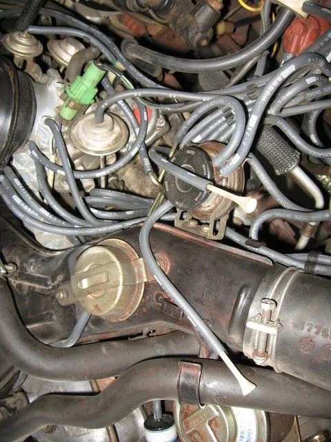

EGR bypass pictures
Here's some pictures. The first one is the EGR in stock form.
The second picture is my fancy golf tee bypass. I used a small 6 inch piece of spare vac. hose to connect to the EGR modulator to be able to cap both ends.
EGR Bypass
For me, bypassing the EGR solved a major bucking and suging problem from about 1200-2000 RPMs in all gears. I instantly had more power.

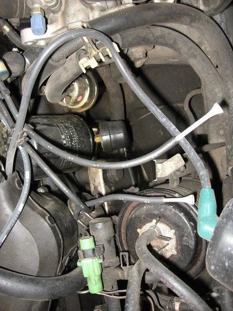

Problem was, on the highway I had pinging when accelerating especially at about 1/2 to 2/3 throttle.
So, I read about bypassing one of the distrubutor vacuum advances. This picutre shows which one I did- I think it's the primary advance?
I really don't understand the function of all this stuff. It is completely trial and error for me.
Notice the VCV inline. I think the other vacuum advance has to do with the high altitude comepensation?
Coincidentally, when I took a 1200 mile trip to New Mexico up to 9,000 feet, I did not know about bypassing the vaccum advance, so I left the EGR in normal (non bypass mode) to prevent highway pinging. At higher elevations, it ran fine.
