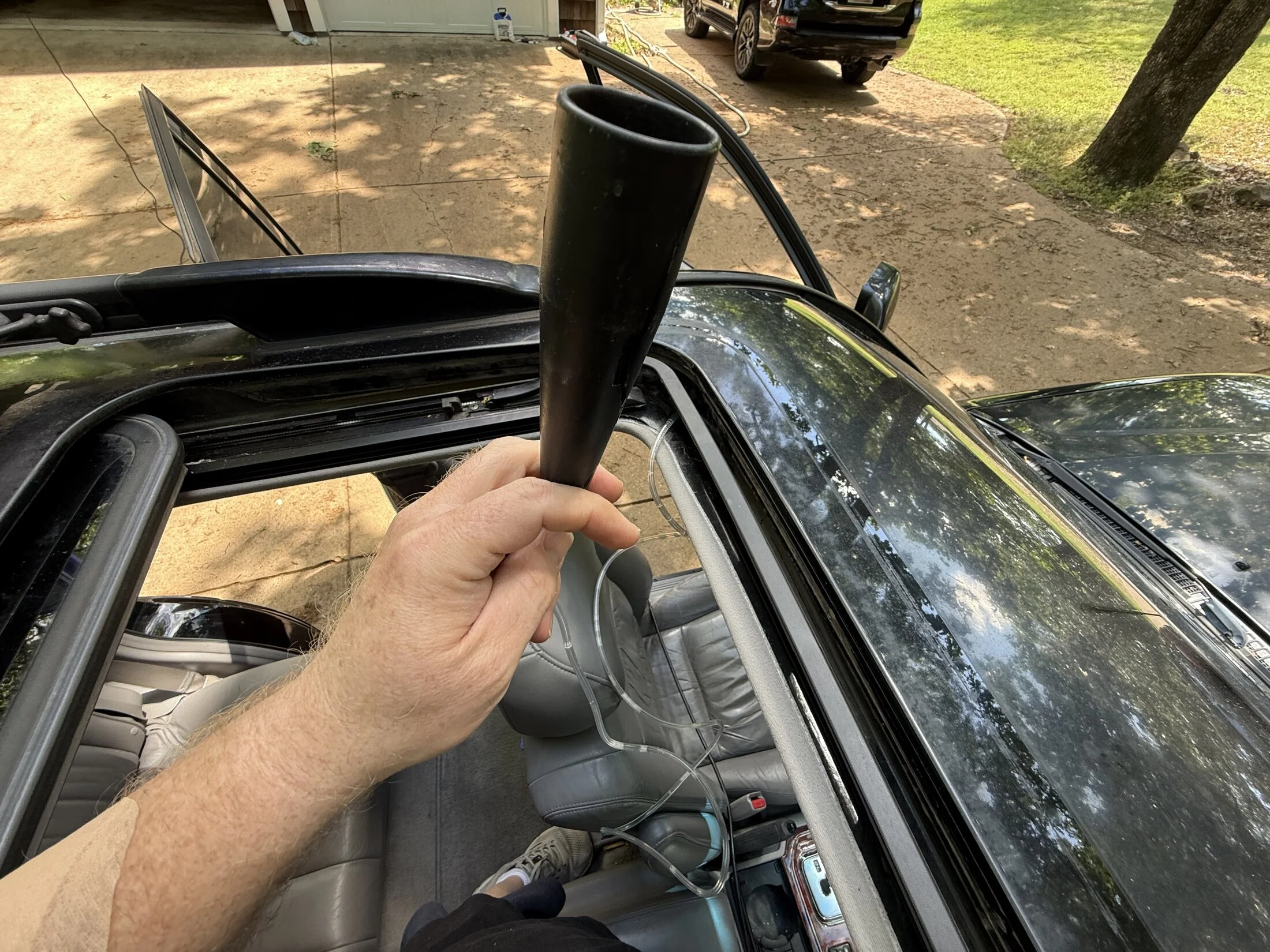

I developed a sunroof drain special service tool.
I do a full service on both of my 100’s and any (which is all) of our 5 cars, once a year.
Vac out debris, wipe down mating surfaces for the seals. Clean out as much crud as possible.

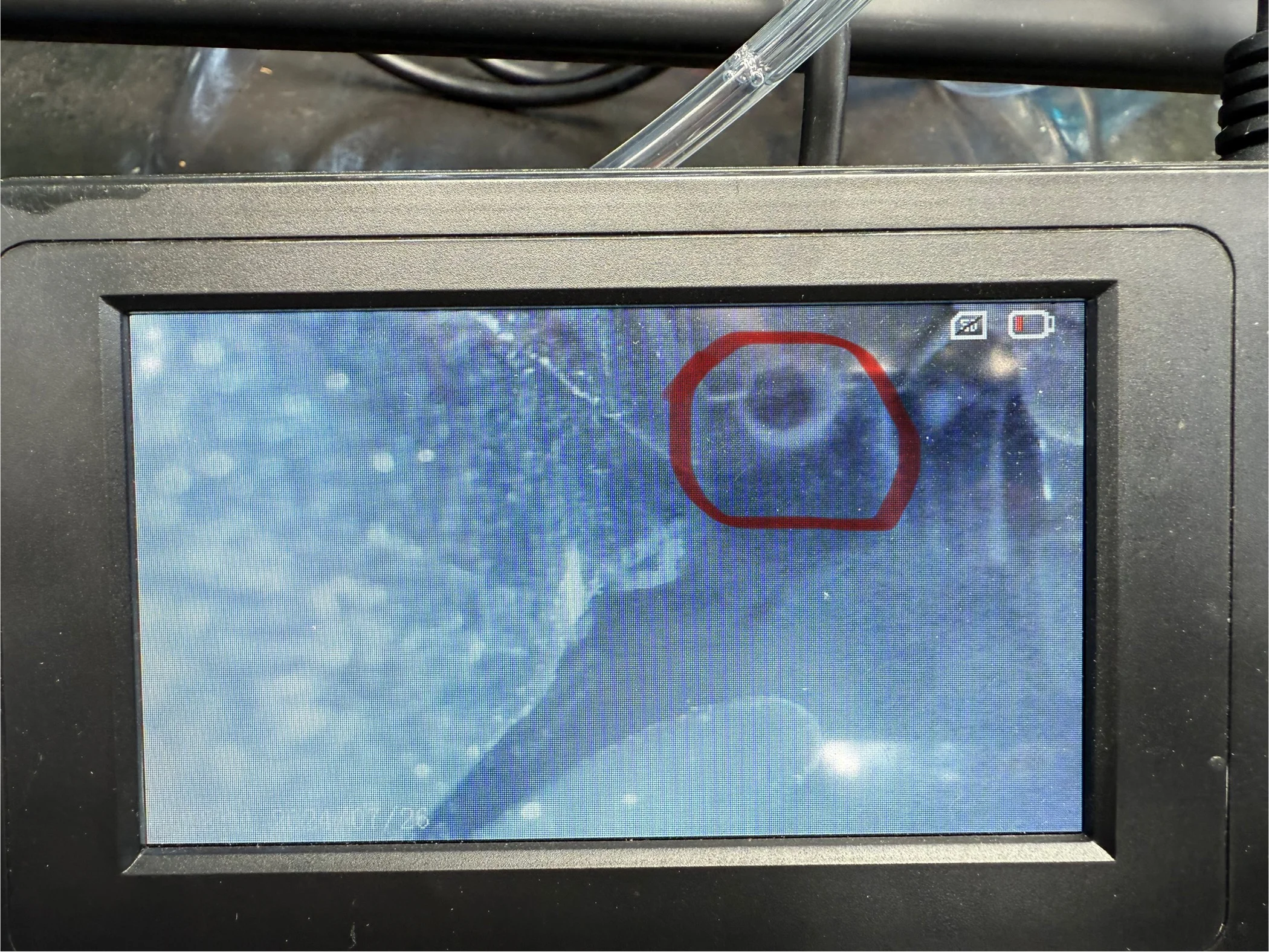

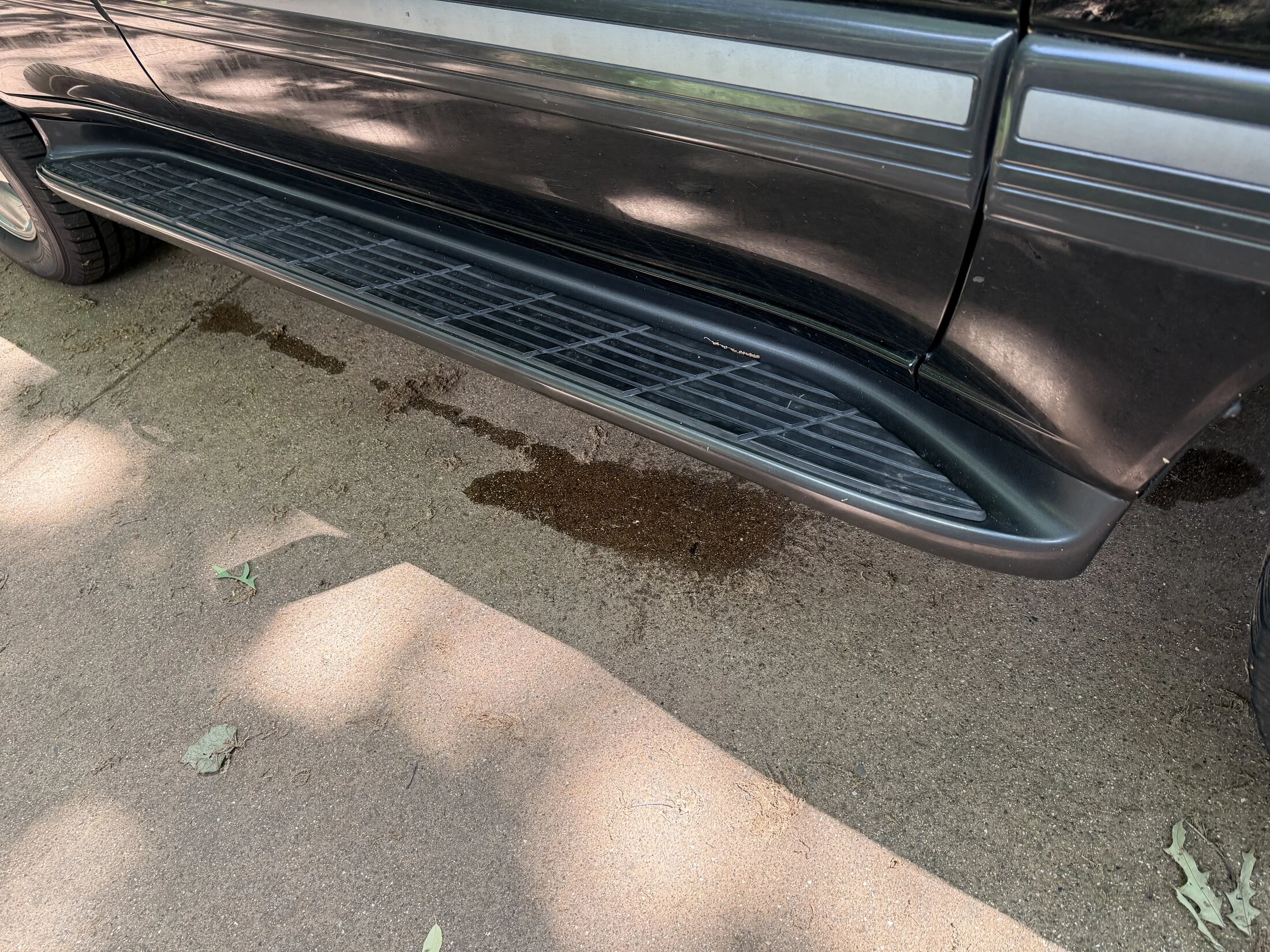

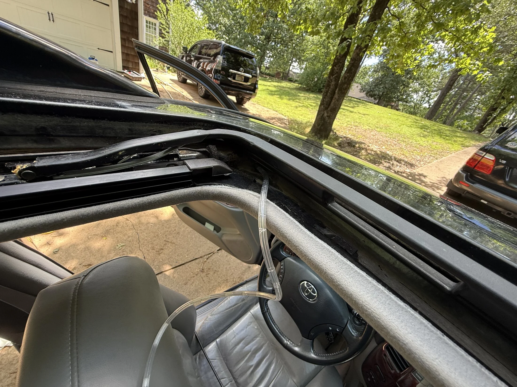

With the car pointed uphill, Load the special service tool with dawn power wash concentrate. Let this run through all four front and REAR drains. Follow with a low pressure water rinse. During the process I am verifying each drain point for each of the 4 drains.
I found that surgical tubing for a nebulizer fit into a necked down adapter for a little craftsman shop vac. The tube is just rigid enough to actually gently move through the front drains. With an endoscope I can navigate to the rear drains and flush them. The final flush is a low pressure blow out using water to rinse. Just turning the hose to the “output” on the little shop vac. The hose doesn’t completely fill the drains so there is plenty of space to avoid putting too much pressure on a fitting and blowing it apart behind the trim.
