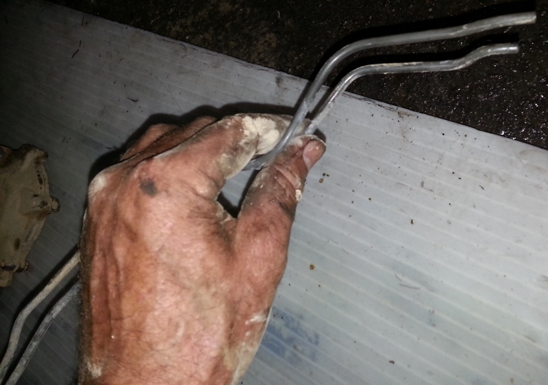

grabbed 3 lines into the 4x4 switch and they snapped in my hands CRAP. Cut the 3 new lines and layed them into the same route as the old ones. Joined them all up eventually

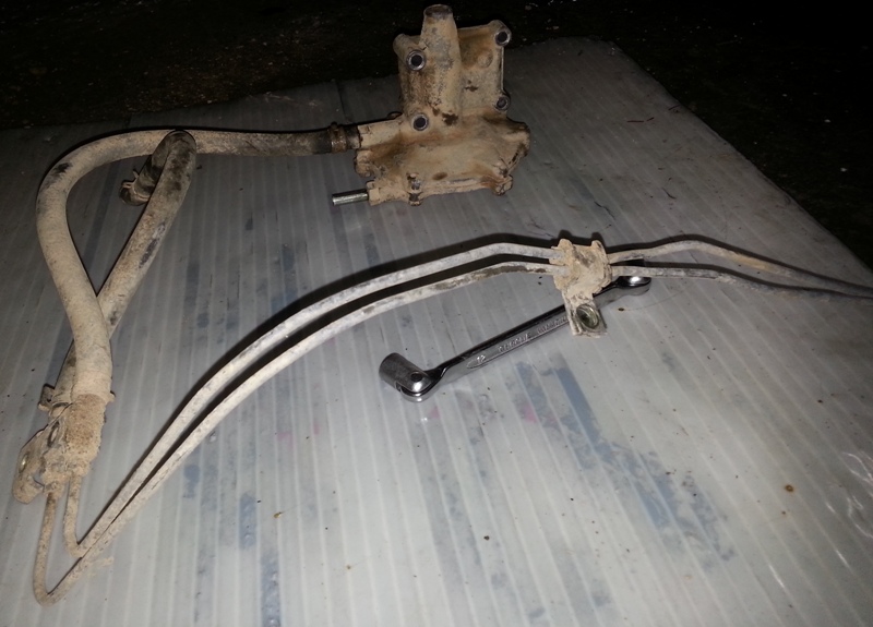

Remove the vaccum lines from the transfer case and blow air through - ones blocked and full of oil. A cable and wire stuck down it only pulls out dirt and oil straighten them out for the wire to go down easier still no luck. Finally a big blast of air in reverse smacks out a BLAST of DIRT and OIL.
Where did the dirt come from then I remember the AIR compressor installed under my seat with no filter having dirt in in one day and refusing to work looks like the DIRT went down the 4WD hose also.
Reconnected and 7.30pm test in the dark - WOW suddenly I have 4WD light again and the GOD winch Air freespool is working and I have successfully replaced every air hose in my truck with new NYLON hose no longer using 4MM PU hose the sun and heat kills it.
